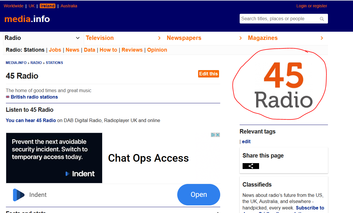

  4. It's been a while, I got a bundle of them somewhere then I went to this site, where you can download them individually for any that were missing https://media.info/radio/how-to/radio-station-logos-for-your-volkswagen-or-skoda-radio Search for the station in top right, click on the logo you need then when you see the bigger logo on the right hand side of the screen you can right click and "Save Image As" Below is random example, right click on the circled logo and save as. If you click on "British Radio Stations" you can list them alphabetically

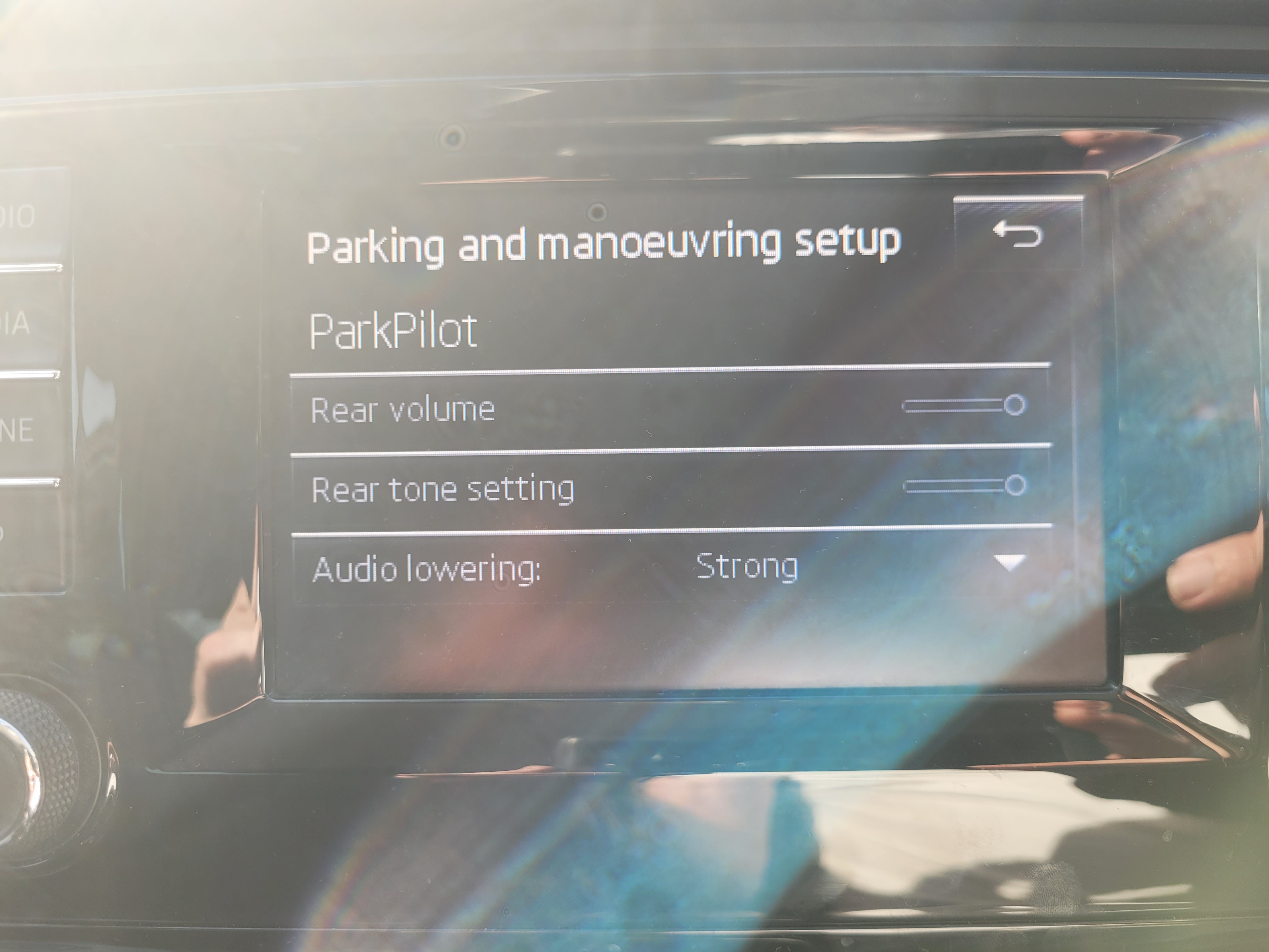

  10. Could just be one faulty sensor shorting out the rest like in this vid. Video is quite long winded but they get no reversing display on screen like you and narrow it down to one faulty reversing sensor.
  11. Could well be coded out. I have a 2015 Elegance spec and when I go into "Parking and Manoeuvring" I get the below screen. Apologies for the brightness, an unusually sunny morning here I have rear sensors only and no button by the gear stick.
