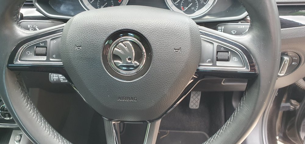

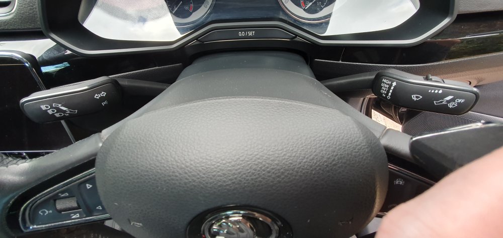

This is the wheel I am replacing
20240607_154353.thumb.jpg.b3c40e9db3c76d1ef682babde0108ba8.jpg20240607_154404.thumb.jpg.589d4e0899547bba1240c7dc5cacc3e8.jpg
If I've read all the other threads from my google searches correctly I can straight swap the airbag and the paddles should work without vcds.
If one of you knowledgeable folk could confirm this that would be great.
I did this swap on my octavia and got no errors or anything.  Was all just plug and play.  As far as I can tell your experience will be the same.
Paddles will work no problem, Id also say you have the old style airbag which fits the alcantara steering wheel.
