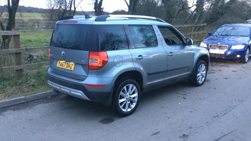

Anyone had their diamond cut Origamis powder coated?
We recently got a Yeti with these wheels.  It was bought by previous owner only a year ago from a Skoda dealer and the wheels are unmarked (I'm assuming they have had at least one refurb).  I'm thinking about getting them powder coated now before they start suffering white worm since once the corrosion sets in.
My thinking is that a refurb (i.e. with material added and/or removed to repair corrosion rather than just stripping and coating) may or may not be possible.  Alternative would be to pick up some different powder-coated wheels and perhaps try to sell these.
Just wondering if anyone has had theirs painted and what they look like (opportunity for gratuitous pics!)

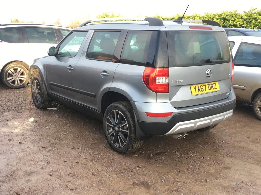

Mate if mine had his wheels powder coated. Yes it is the same colour car just the lighting is odd
