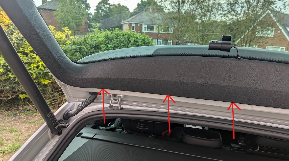

I'm replacing a rear camera in my estate, the current one is shown below. I've found a video showing how to remove the whole trim but was wondering if it's possible to just unclip the top part where the arrows are, does anyone know?
I need to remove mine to make a better job of fitting my rear camera. I'll be removing the whole panel. It looks easy enough, and trying just the clips at the top may be possible, but I'd be worried about breaking clips.
Hi,
I've also a rear dashcam. Unfortunately, you can't remove the top trim without removing the bottom trim.
The bottom trim is just clipped, whereas the the top trim has 2 screws (Torx 25, as far as I remember) at both ends, hidden by the bottom trim. The rest of the top trim is just clipped on top and on both sides.
It doesn't take long to remove the bottom trim. You just have to pay attention to remove both lights and the open/close button before pulling hard to unclip it. 😉
But to clip both top and bottom trim back in place (especially bottom one), it's better to  be helped by someone, otherwise it's a PITA. Both trims are quite flexible, thus if you're alone you can clip one side, try to clip the other side and first side then falls down. This can "play" a looong time with your nerves...  😤😉
