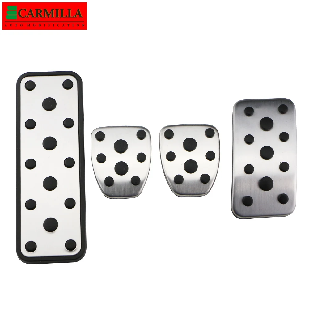

There are too many designs in the market but i don't like them, for example:
https://image.made-in-china.com/2f0j00fobgLEjnghkz/Car-Foot-Rest-Fuel-Brake-Pedal-Pad-Set-Nonslip.webp
https://ae01.alicdn.com/kf/Hc67b3c67e2f7480e8c9498b92aea1d68o/Carmilla-Car-Pedals-fKit-Parts-Gas-Brake-Pedal.jpg
https://i5.walmartimages.com/seo/LNKOO-3pcs-Nonslip-MT-Car-Pedal-Pads-Auto-Sports
I love specific that design and i don't want to change it, thankfully there are still in the market although not as Foliatec but as other brand but this is not a problem.
