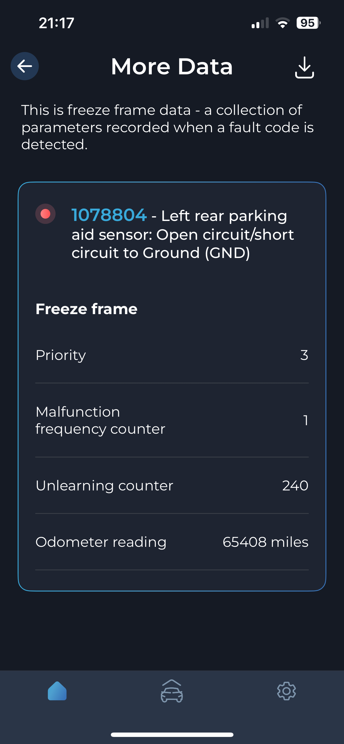

Hi all.
the parking sensors have stopped working on our Citigo, scanned it with Christa and got this.
do you think it’s just the sensor that needs swapping?
Thanks.
Sounds like a sensor or the wiring to it....
That’s what I thought, bought a sensor form TPS this morning and have an auto electrician having a look Saturday morning.
