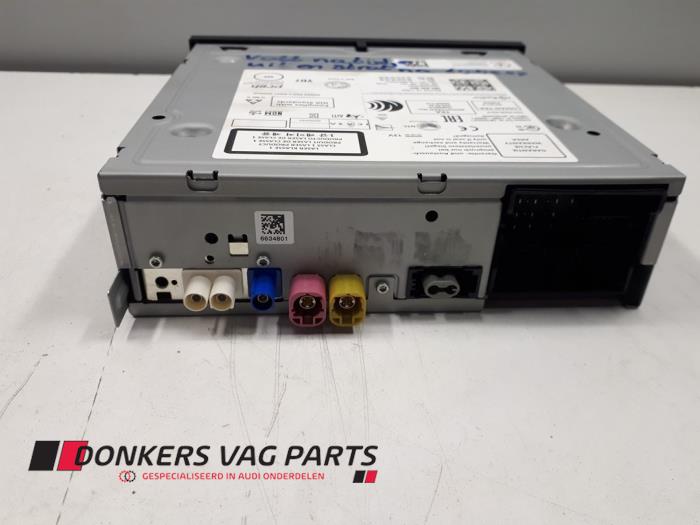

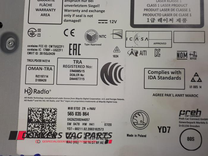

My unit placed in Karoq MY2020 has a part number: 565035864. Apparently, DAB/DAB+ can be activated in it. With the help of Car Scanner Pro and long coding (5F, byte 14 , 3) I launched the possibility of choosing FM and AM. In the radio it is possible to add DAB as functionality. I added this functionality/FEC code through the SWaP code generator and encoding by Car Scanner. Despite these operations, I still don't see DAB in any of the options. Can any of you help me launch this radio function?
Seems very unlikely DAB will ever work as there is no socket for a DAB antenna :)
Based on these pictures, it's missing a black fakra to the left of the white double fakra...
