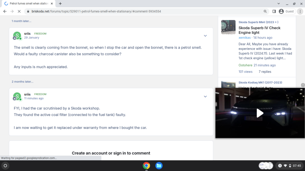

Is the issue not related to this.
Good point!
Could that be the case? The fuel-smell has been there since last year and the car has never behaved like in the video before.
