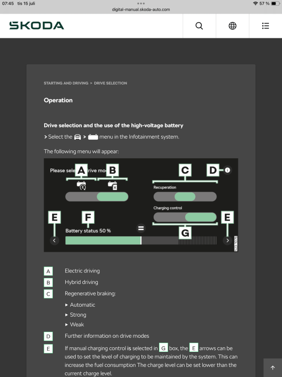

Under the battery icon you can choose to save the charging . Look at the picture .
You set the B switch to hybrid, the G to manual and press the = at the level of charging you want to keep.. So if the battery level is 80 % when pressing the = it will keep the level around 80%.
When you reach the city you press battery and set the B switch to battery.

Just be aware that you have to set it up again each time you turn off the system. So after coffe brake, before continuing your trip - set it up again
