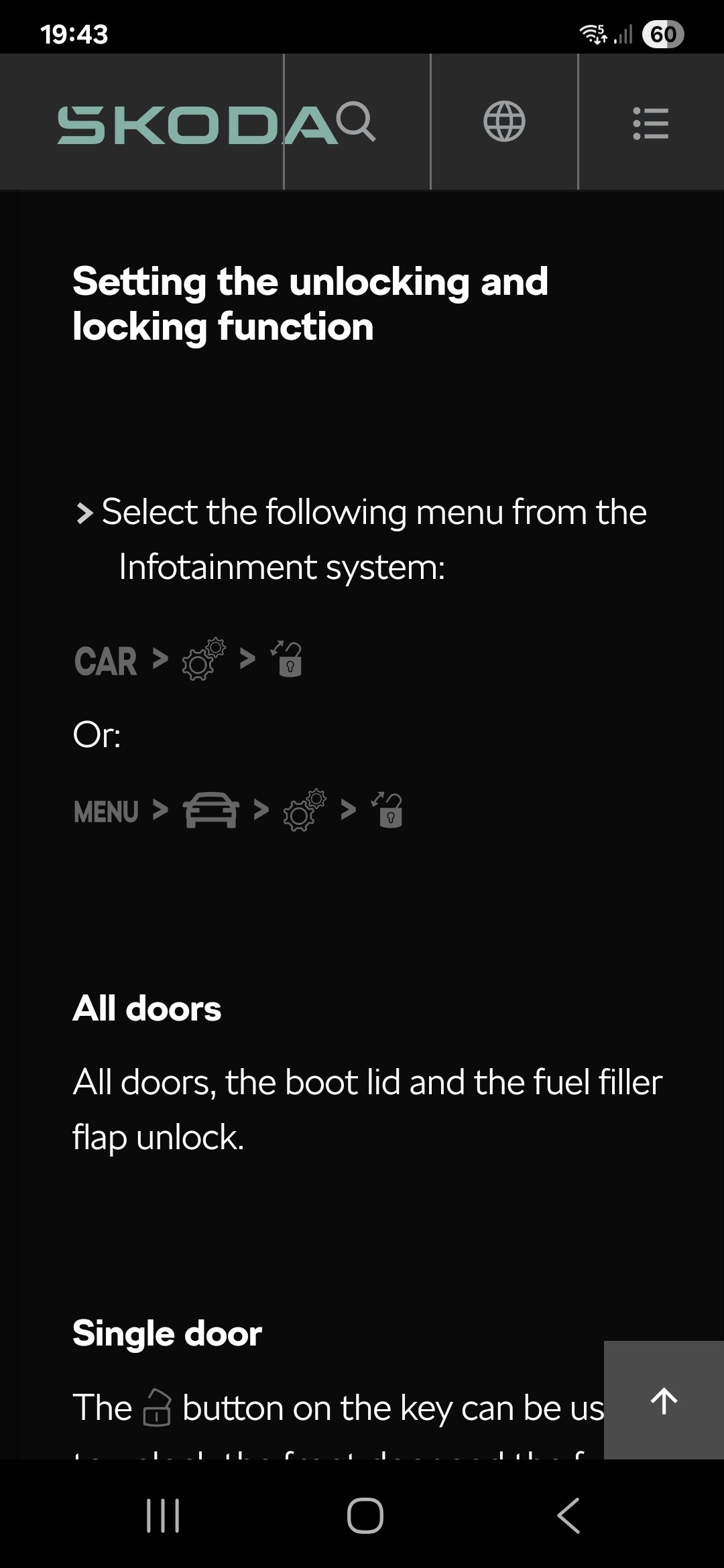

Think I sussed it
It was set on single door 🤷🏻‍♂️
Here's help if anyone has the problem
