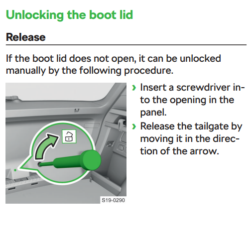

This works on our Karoq, maybe yours too. Also you can try holding down the boot unlock button on the remote control for at least ten seconds to do a reset.
