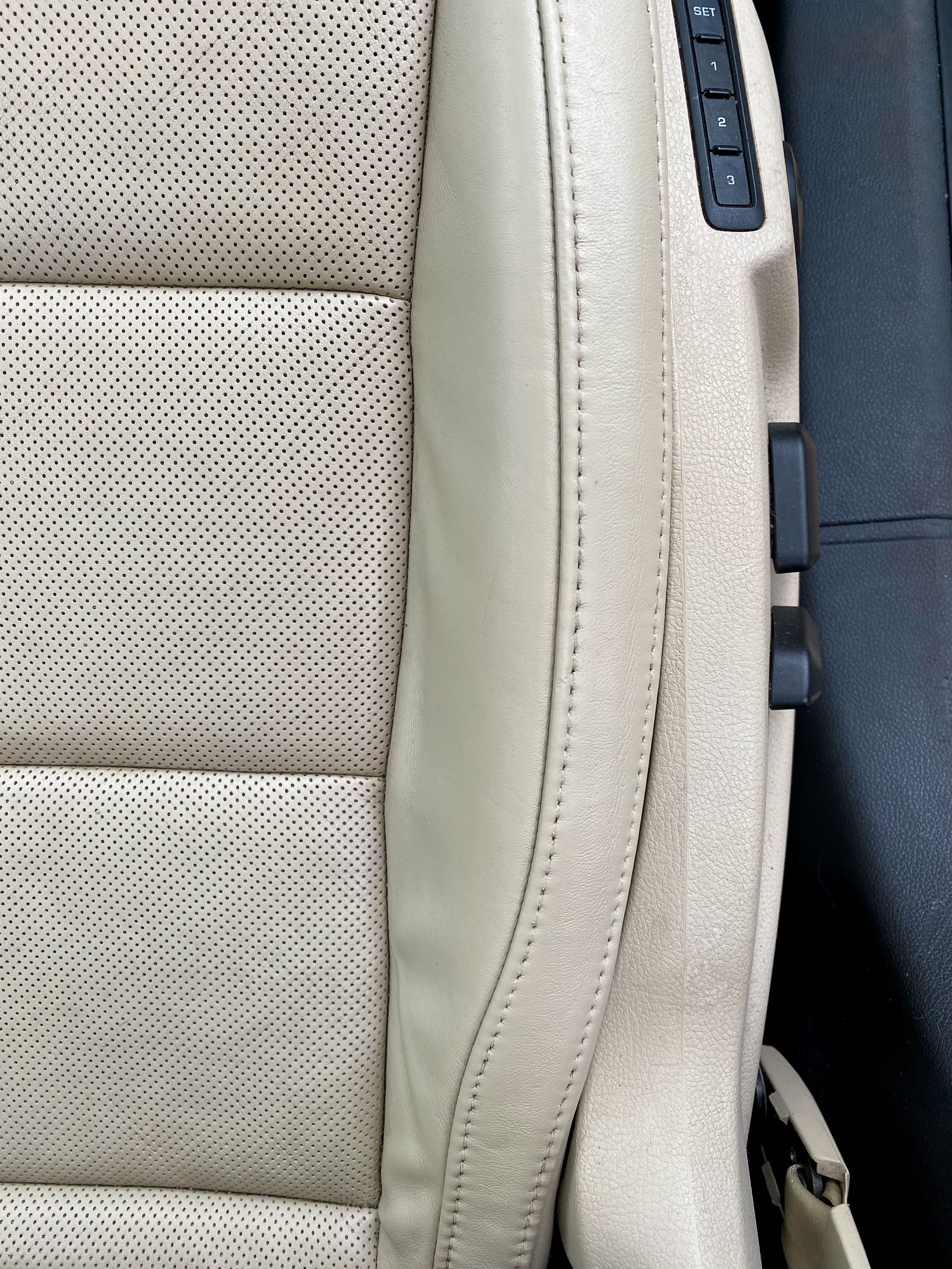

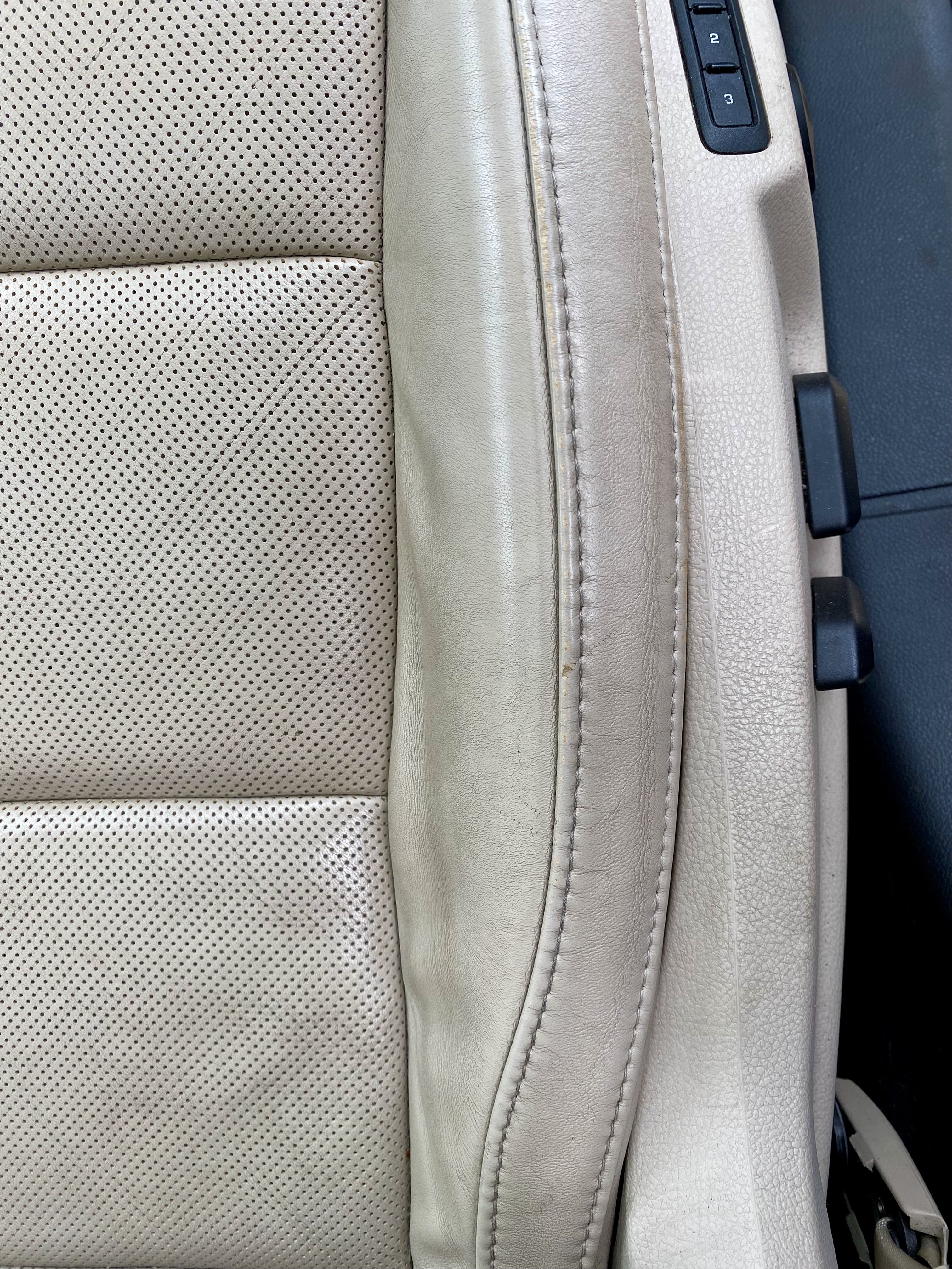

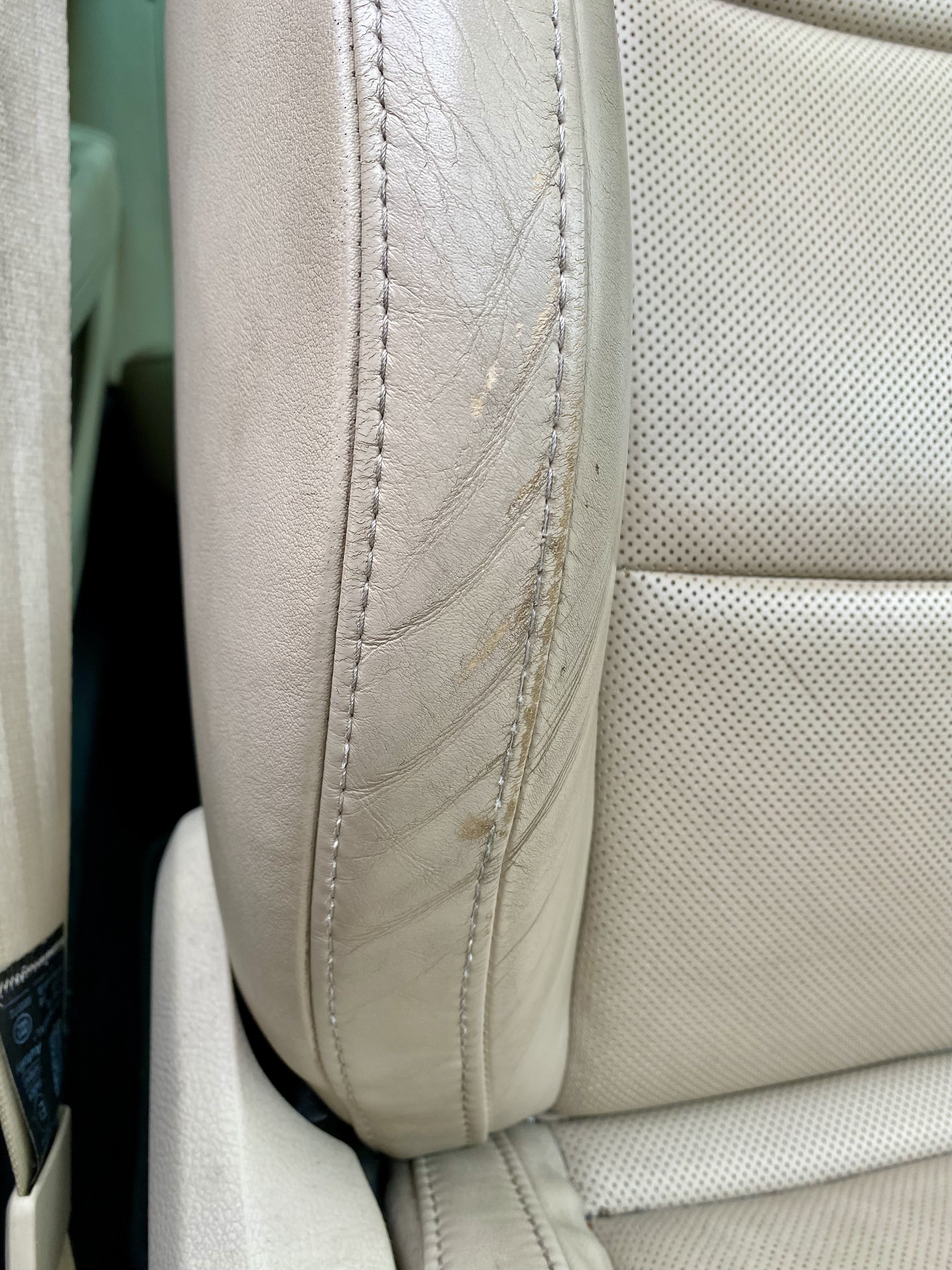

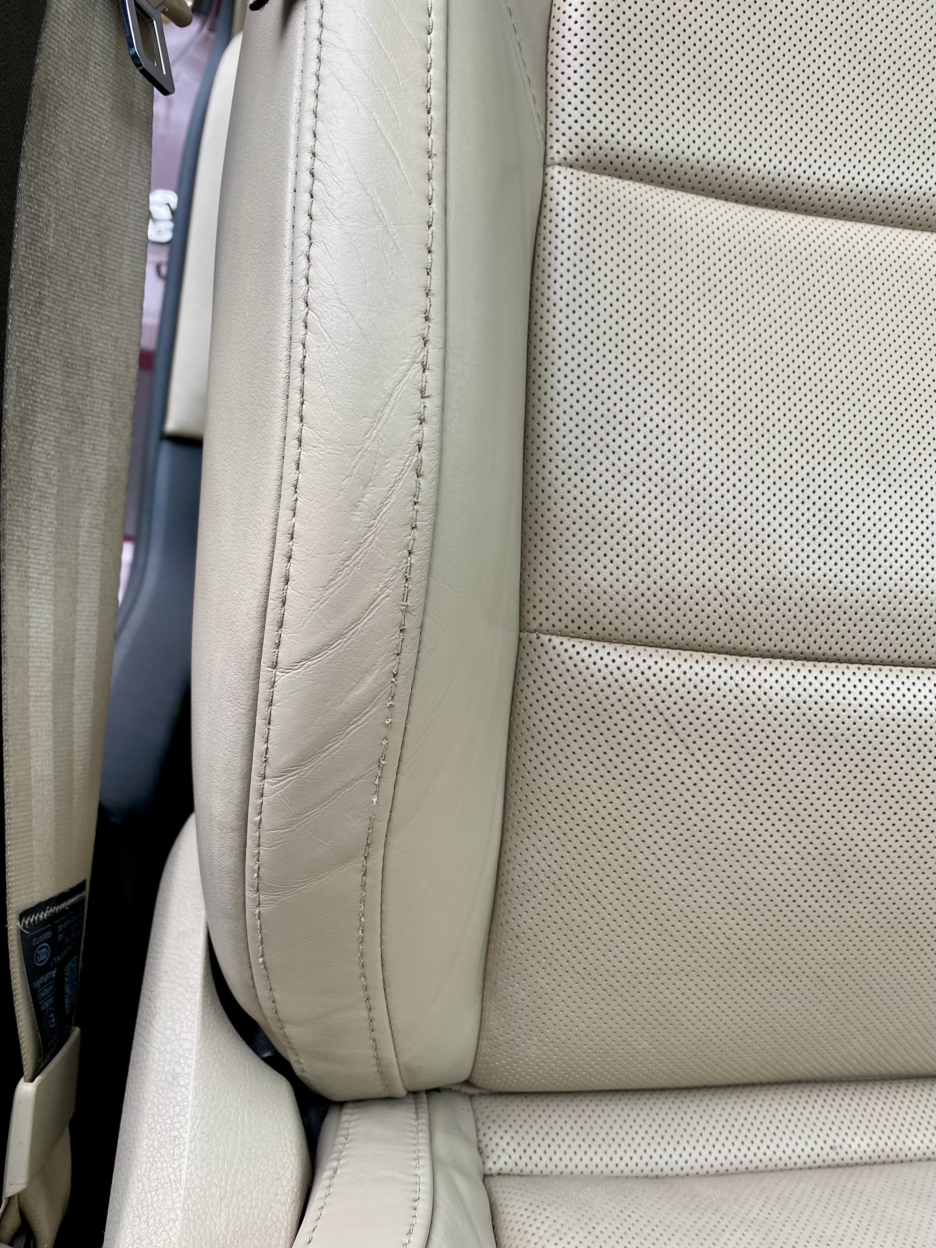

After 13 years and 85,000 miles, the driver’s seat on my 2012 Superb was looking slightly tired, with minor wear and some colour loss, especially on the bolsters. I also had an annoying little patch on the seat base where the colour had worn through to a yellowy-orange layer.
A couple of weeks ago someone posted that they’d used Furniture Clinic leather repair paint with good success, and included a colour code for their 2012 Superb with ivory leather, same as mine. If you’re reading this, thanks!
I contacted Furniture Clinic to confirm the code, and their response was understandably cagey - they cautioned that the match might not be perfect on my car due to differing wear use and sun exposure, but I took the gamble and ordered 50ml quoting the colour code KM8127. I also gave a description “2012 Skoda Superb ivory”. I figured that if I took a sample from an inconspicuous area, or even if I sent them a headrest, the wear and exposure would be different from the seat base anyway.
When I received it I was a bit sceptical. The paint looked too “biscuity” in the bottle. But I tried it on an inconspicuous area and the match was as near perfect as you could hope for. It went on the correct colour, and was virtually indistinguishable once dry.
So yesterday I spent the afternoon working on the seat. First, I cleaned the whole area (not just the bits that obviously needed attention). I didn’t buy the special cleaning product; I used dilute Fairy liquid on a cloth and dried it with kitchen paper. Then I degreased - instead of using their alcohol cleaner I used electrical contact cleaner on a clean cloth, and immediately wiped over with kitchen paper to mop up any greasy residue. I also considered using spectacle lens wipes - I reckon that would have worked as well.
Then I shook the paint vigorously and started applying thin coats onto the areas that needed repair using an artist’s paintbrush, which allowed me to gently work it into the cracks. I allowed about 30-40 minutes for each coat to dry naturally, and did 3 coats using the brush. I was a bit more generous on the edge piping.
In places, particularly on the bolsters, the leather had darkened with age and the colour match wasn’t perfect. But I had used only minute quantities of paint so I could afford to cover the wider areas. I did this by cutting a 1 inch square from the corner of a washing-up sponge (fresh out of the packet, obviously!). Using a small piece allowed me to saturate the sponge without using huge amounts of paint. I dabbed this over the wider areas, doing a second coat where necessary. On the perforated leather I kept a cocktail stick handy so I could unblock the holes if needed.
I also found it seemed to work well on the plastic base, around the seat position buttons.
And I’m delighted with the results! It was slow work, but quite satisfying. Time will tell how well it lasts; I suspect the prep is the key, so I hope my improvised degreaser did the job.
More pictures…

On one of the pictures you can see how grubby my seat belts are. I’ve tried various things but it’s pretty stubborn.
Any ideas to clean those up?
Have you tried a steam cleaner?
