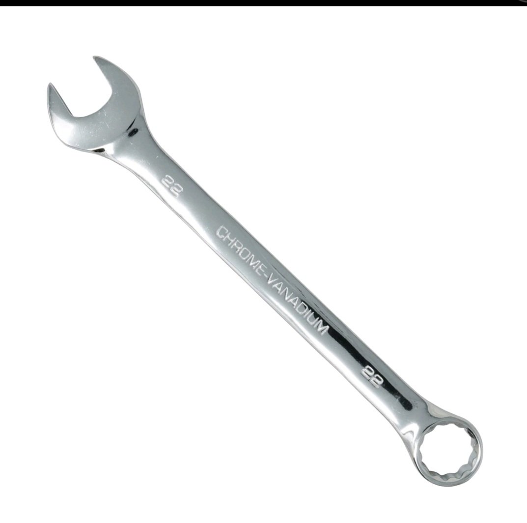

Easy to do but the headlining is quite stiff. Easier if you remove the plastic C Pillar trims either side. Also a 22mm open end spanner is really useful to loosen and tighten the nut.
22 mm spanner for an ariel base JHC !!
Yeah! Tried one on wife's car with adjustable grips. It was a PITA. Did mine a few weeks later and bought a cheap 22mm and made life a lot easier.
