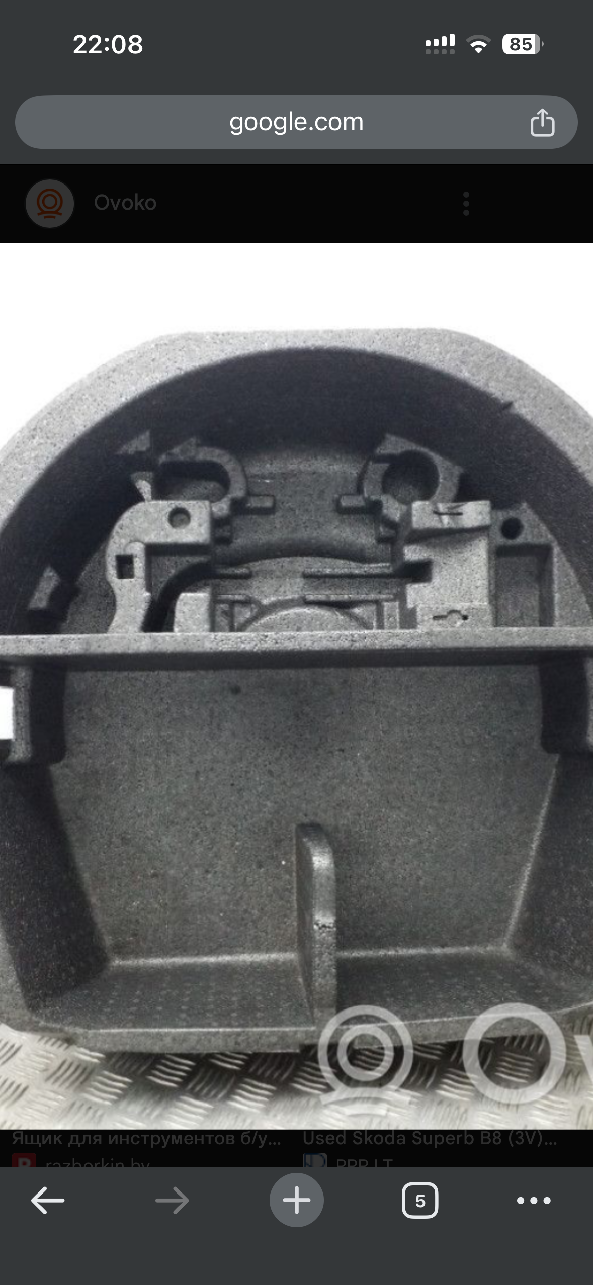

I drive a 2014 Škoda Superb II Laurin & Klement estate.
In my car, there is no spare wheel in the trunk, only a compartment for tools.
I bought the car used, and at the moment the only thing I have in the tool compartment is the towing hook, nothing else. Does anyone have the same car and can tell me what tools are supposed to be included there (as shown in the picture), or even better, take a photo of it for me?
Thank You
Missing parts:
  • The small tool to remove the plastic caps from the wheel bolts
  • The compressor
  • The tire repair kit (which you don't want since it ruins the tire).
Only if you have a spare wheel, than there is a plastic insert in that wheel containing the jack and a wheel nut wrench. I would order a spare wheel and the spare wheel kit if I were you.
