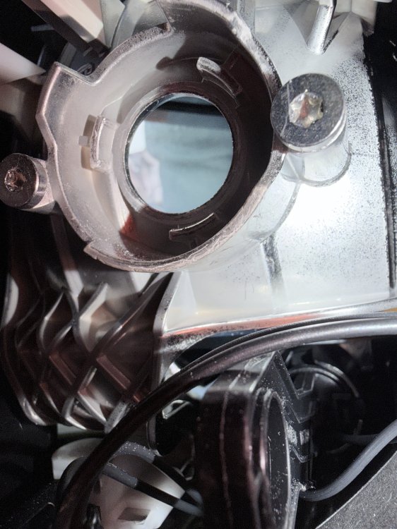

So I had a warning for the passenger side dipped bulb. So get a new bulb, seem it’s something else is happening,as the new bulb also is having the issue,and on further checking the full beam works on both bulbs, possibly the No.1 fuse. But also I cat for the life of me get the bulb seated back into the holder, I get a feeing that maybe something has fell off the internal part. Attached picture P
Have you got the silver ring still?

So I have the bulb, it’s the H7,there’s a silver clip that sits on the plug. So the plug sits on top
Of that. Just doesnt feel like it can twist around and sit in the hole in the photo.
Is fuse one for that? The fuse diagram isn’t entirely clear
The ears on the silver clip fit behind the two torx screws at 9 & 3 O Clock in your photo above.
Flat end first. Tab needs to be pointing in the right direction.
Compare to the other side!
They are renowned for being tight.
If you were in the engine bay it is turn clockwise to locate.
