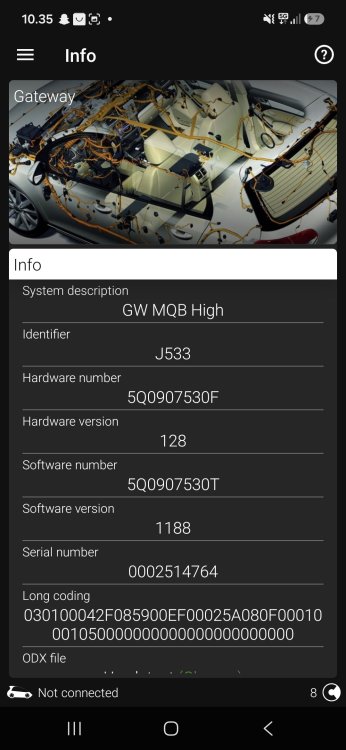

Hello! Is somewhere place that i can ask is there newer sofware version available?
Why you want Update?
Because my j367 module not working like it should, infortaiment cluster says often battery low. Battery is changed and j367 module also. Live data says usaböe battery charge is 0ah after coding and starting the car. Also kessy not working. Internet says that i have to update the gateway control module so it understand the new j367
How old ist the Battery?
6months
There is now any fault codes and other live data is normal. Only the usable battery charge is disappearing when first time i start the car after coding the battery and let it sleep 12h
Start the vehicle, switch on the seat heating and rear window heating. Measure the battery voltage; it should now be 14.2–14.8V.
It was 14.5 but i check it again today
I tried and it was 14.5 volts
