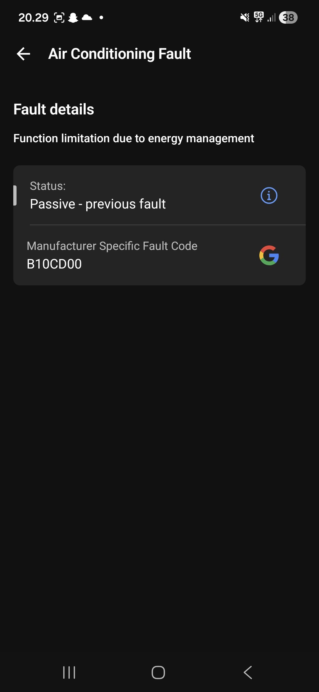

  5. Because my j367 module not working like it should, infortaiment cluster says often battery low. Battery is changed and j367 module also. Live data says usaböe battery charge is 0ah after coding and starting the car. Also kessy not working. Internet says that i have to update the gateway control module so it understand the new j367

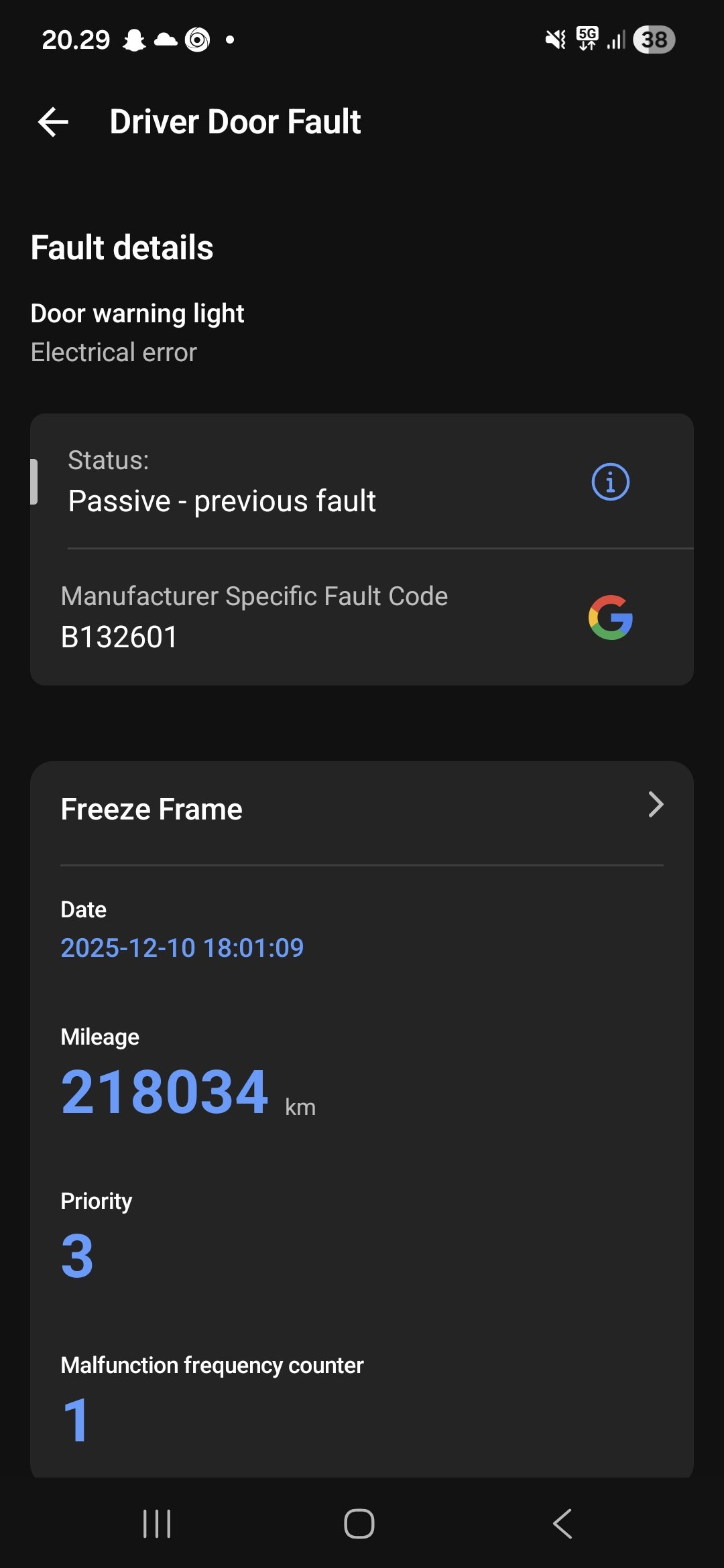

  7. Hello, what could be the reason why my kessy not working, it sometimes works and sometimes not, only the problem is the door handles, trunk and start button is working. I have change the key fob batteries and also the car battery also have changed last winter. But what its weird is that there is no fault codes at all... I also changed the driver door wiring because there was cracks. Sometimes in radio screen it show that 12v battery low, when there is still 12.3v when ignition is on, could it be the reason that it disables the kessy system?
  8. Hello! I check my driver door wiring and there was many wires which insulation was cracked. Is it possible that it can cause some fault that car thinks it drains power somewhere? I also code a battery again so lets see if the battery low message disappears

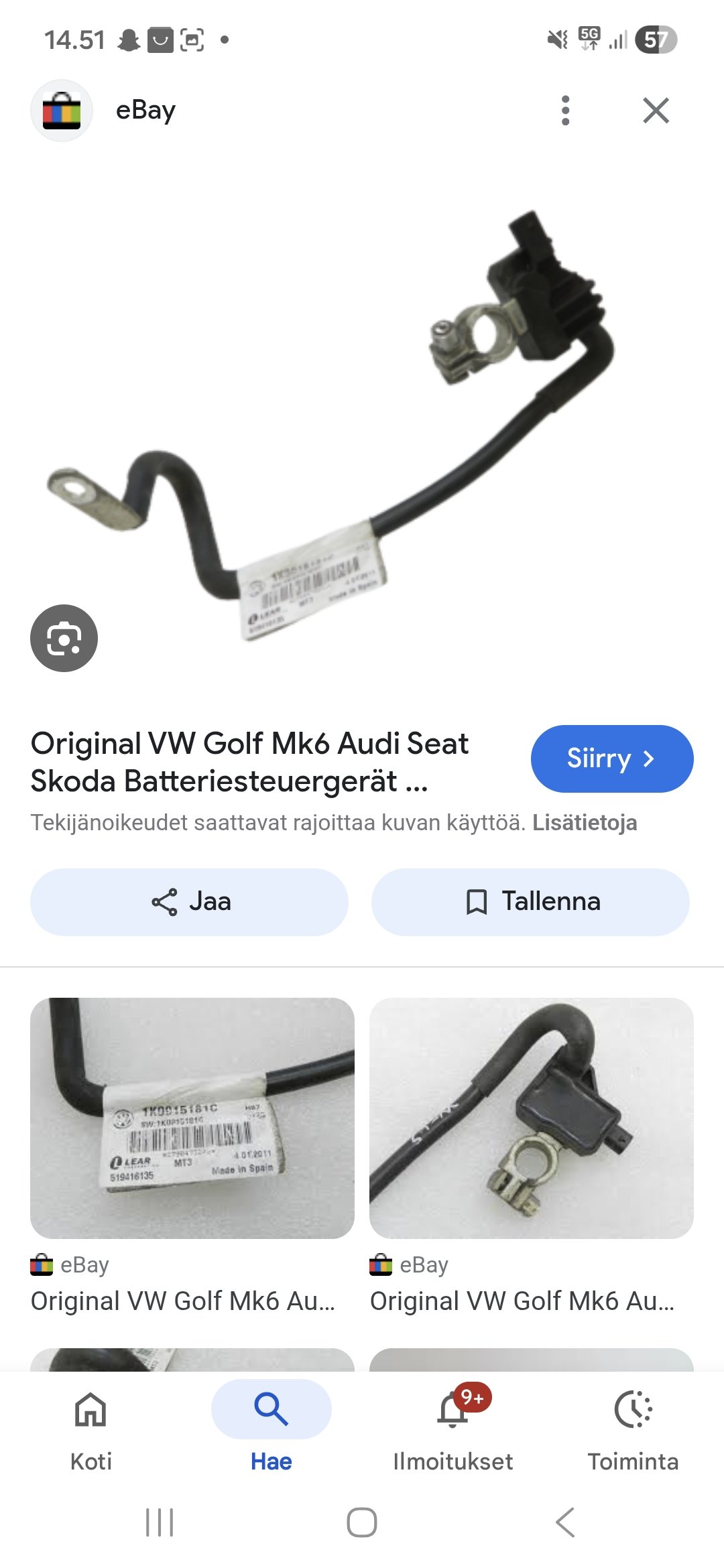

  9. I change it just as a precaution

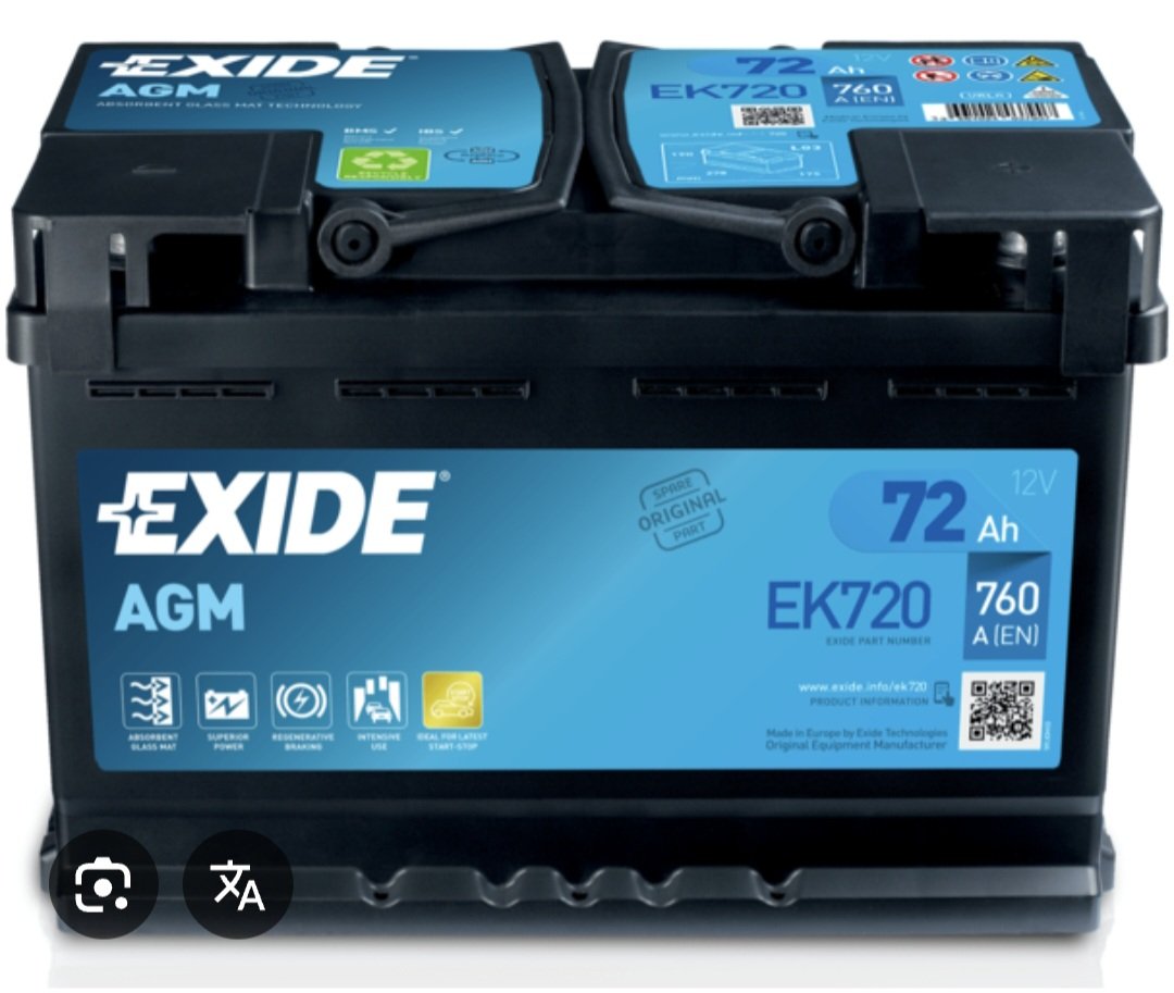

  10. Yes, the old battery was agm and it coded to fleece

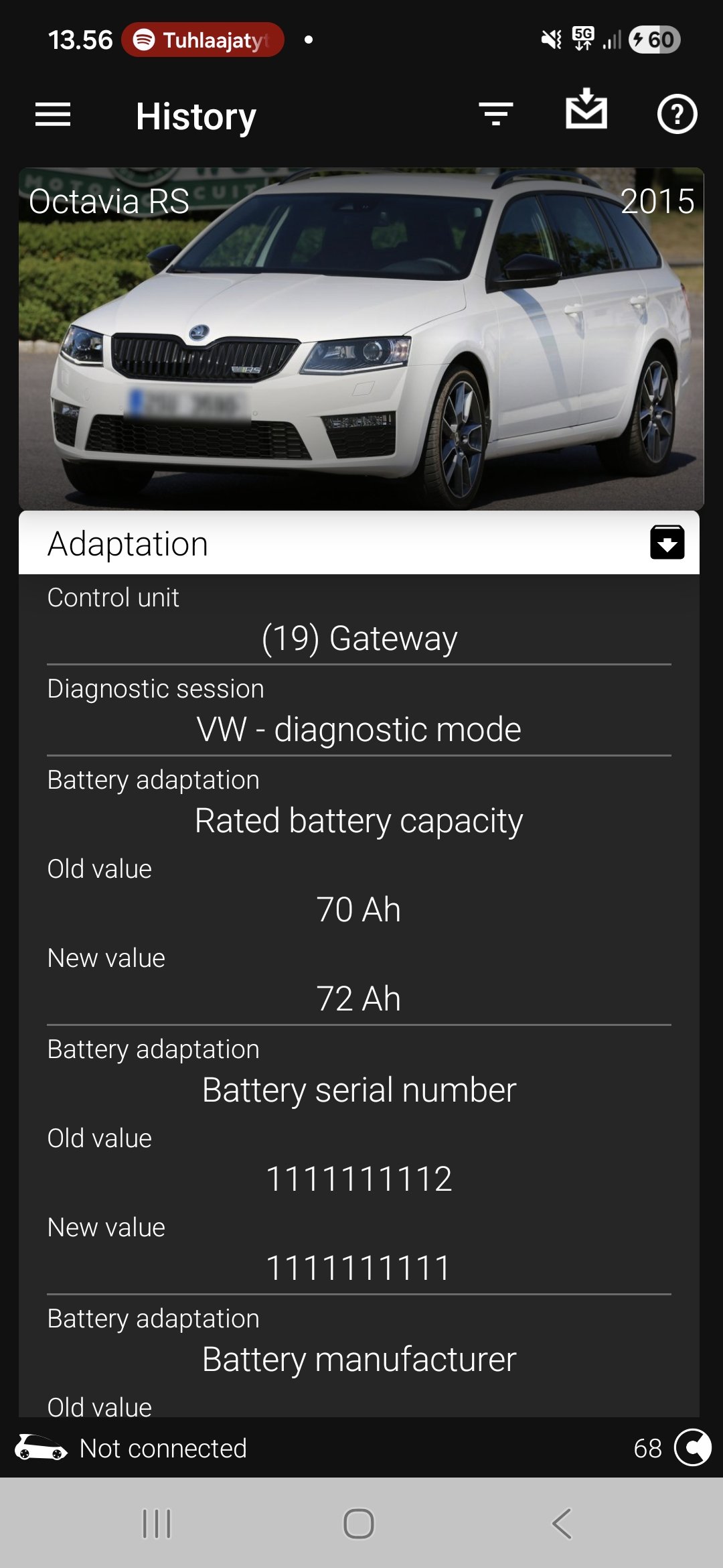

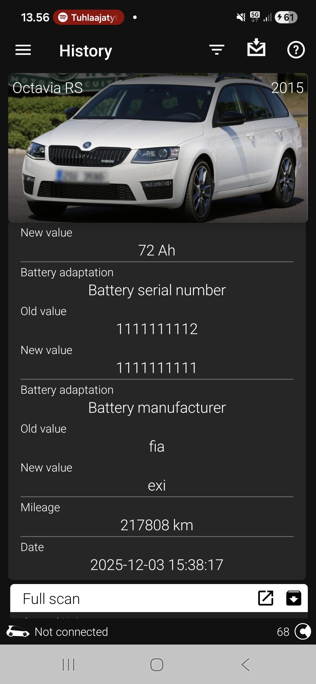

  11. How about this part, does it need coding because i changed it?
