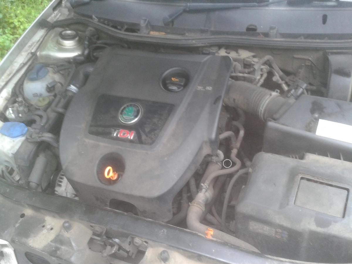

Thanks Gizmo, just been to look under the bonnet and I hate to say it but mine looks different. Can't see anything resembling the sensor behind the engine like in your photos.
I got my torch in there though and came across what looks like the sensor on the right of the engine as you look at it. I think it looks like the correct part, but black not green as you mentioned in the other thread.
What does anyone think? Does that look like the coolant temp sensor?  (Sorry just realised the circle I drew on the first photo is tiny but it is there!)
Edited by harrris303
You are in the wrong forum, hence the confusing answer.  Our "Superb" engine is mounted with the belts at the front, hence the coolant sensor ends up at the back.  That looks like more or less the right place, but I don't know that engine.  Maybe ask in the Octavia forum.

Oh right ok, I didn't realise they had different engines. I would've posted in the Octavia one but didn't think there was much point starting a new thread when this one was so relevant to my problem (or so I thought!)
