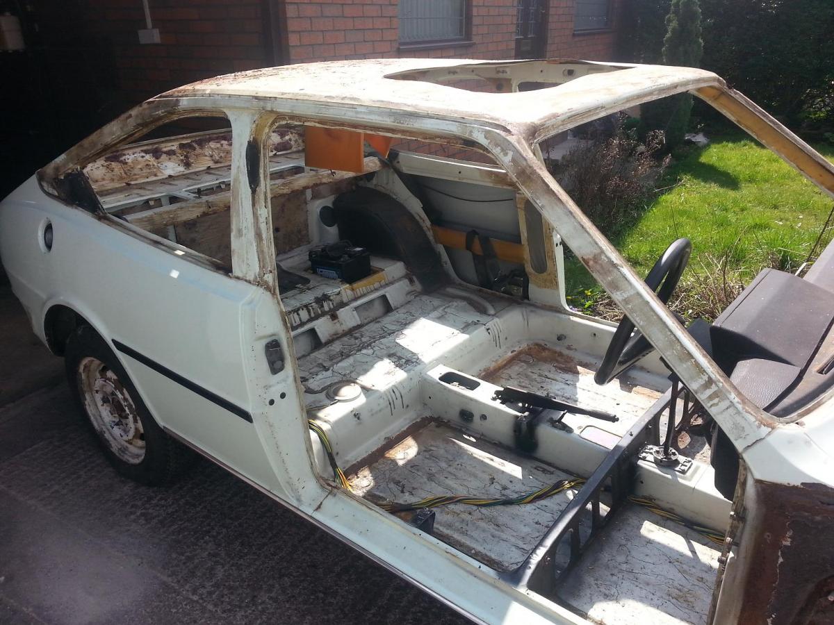

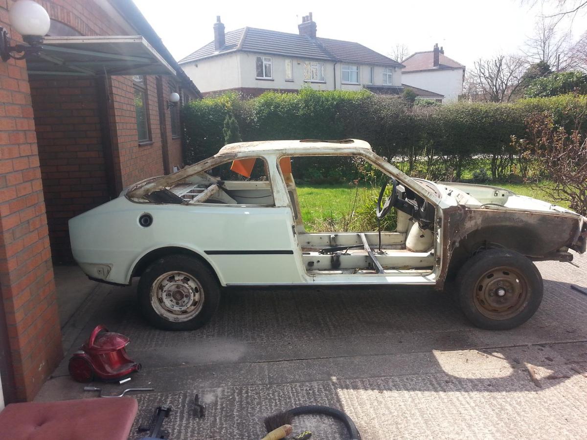

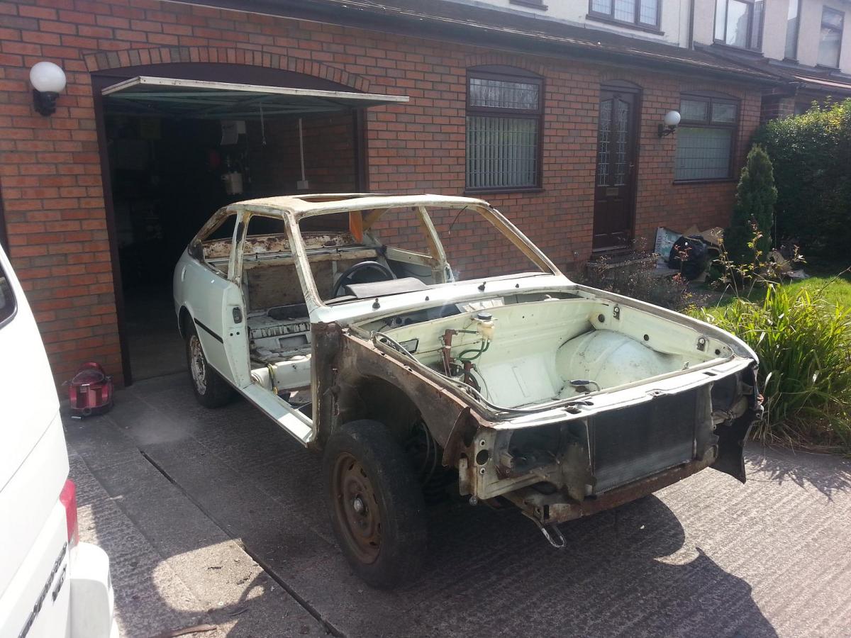

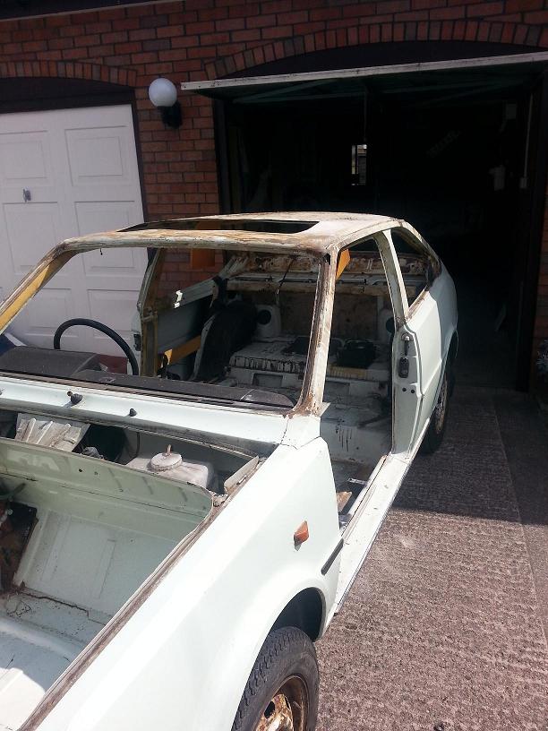

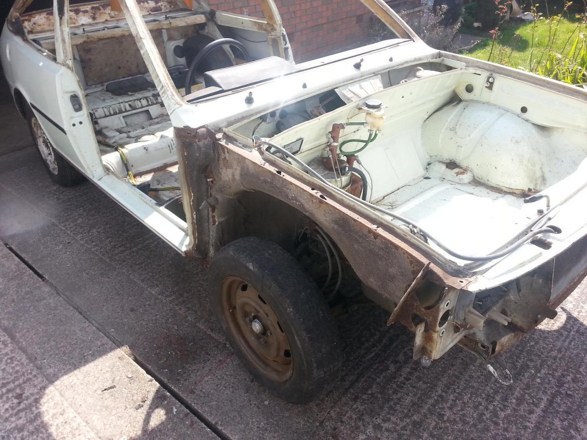

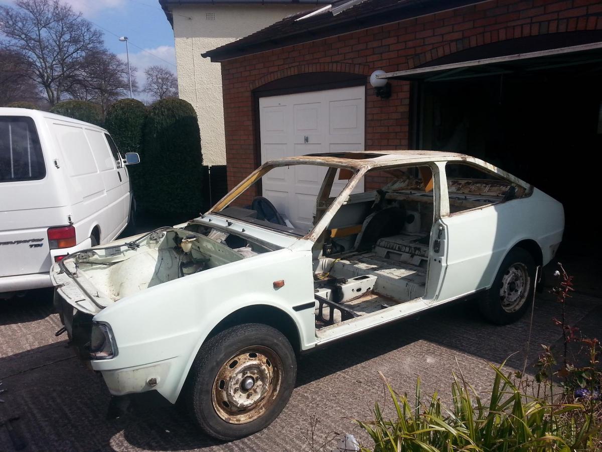

Hi everyone so lve been playing out with the skoda today, so thought ld load some new pictures of todays work....
As you can see still a long way to go, found a bit of rot behind the front wings :( so need to get it welded and hoping l can rescue the wings..

:happy: Well done for cracking on with it. The inner wing tops and "P" sections are available as repair panels.
Cheers Dave, where would l get these panels from and roughly how much??? l was thinking of having a strip welded along the top then having the wings welded back on as the lip on the wings are quite rotten :(

Looks like you're doing a proper job there! That rot doesn't look so bad - I've seen much much worse. P plates don't cost a great deal from memory.....it's been a few years since I had some but they were about £20ish. Skoparts Int is your man!
This is the one that had a viynl roof fitted? Good to see it moving in a positive direction! I shouldn't worry - they ALL rot behind the front wings. What are your plans and intentions with it?
Hi, yeah its the very same l was a bit disheartened when l found the rot but after another look and a friend look its not as bad as l thought :)
