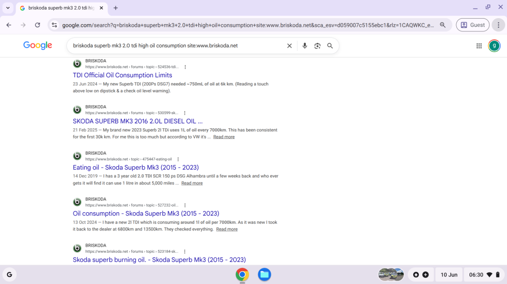

Welcome to the forum. Worth doing a search & looking at many other threads with very much the same as your post.
