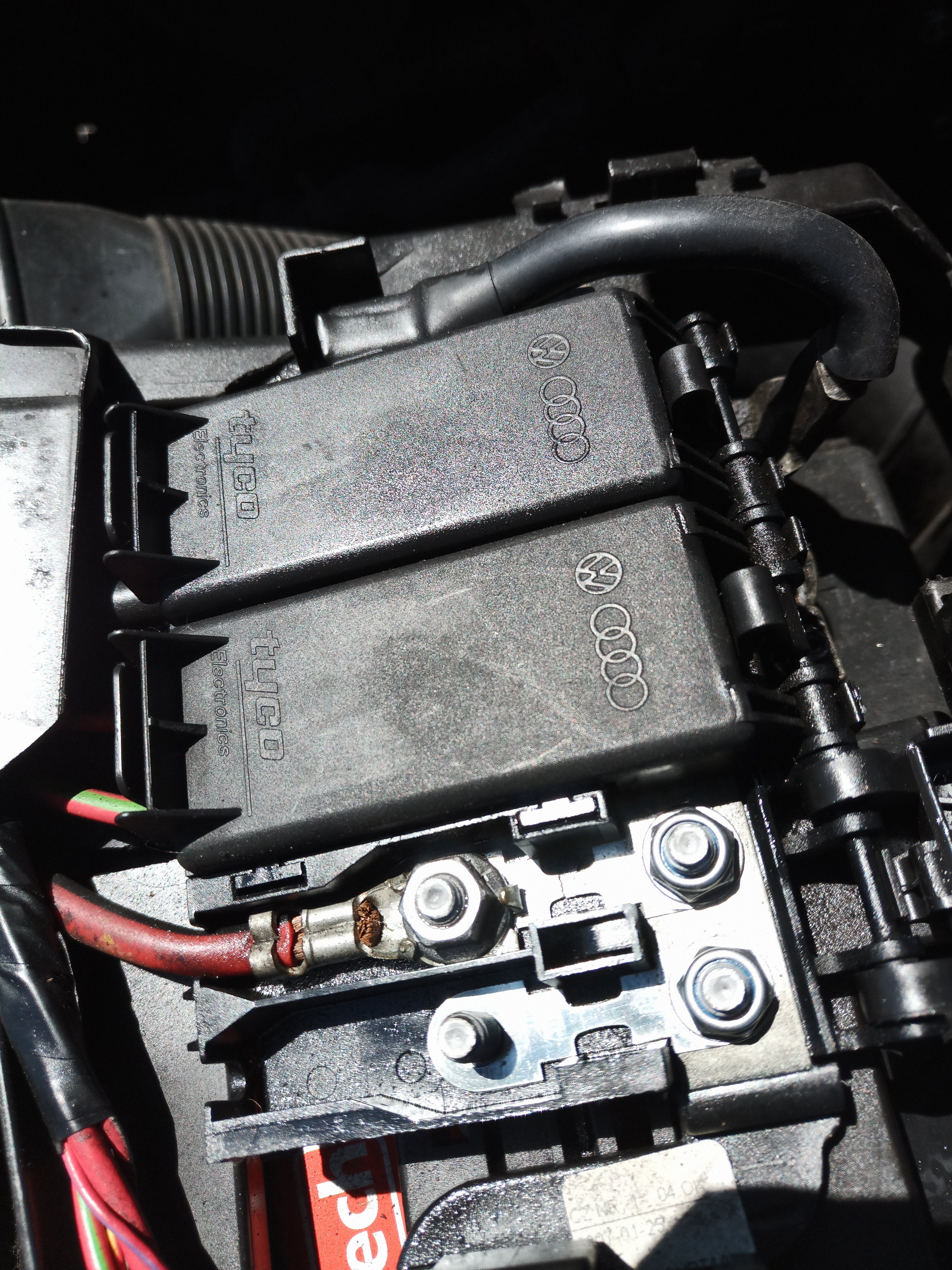

  1. Many many thanks to Pete and Lee and everyone else. I replaced the fuse and it has been ok since. I bought the pack from Halfords as recommended here. Kind regards Yogi
  2. Thanks. Yes, I bought this pack and replaced my blown 50A fuse . Fingers crossed - so far so good. But why did my old fuse blow. Was it wear and tear and or old age. Or should I investigate further? Kind regards Yogi
  3. Thanks The one on the right says 20 on it not 50
  4. Hi , How are you? Light came back and on close inspection, I noticed that the second fuse from the right hand side is split right from the middle. I am sure it's not meant to ?? Can you please confirm and if I need to replace it - what amp/volt I am looking for because there is nothing on it that I can read but the one next to it says 20v. Thanks . Please see the picture.

  6. Hi, thanks for replying. I watched a video on you tube where this guy checked those fuses above the battery and gave them a clean. I did the same and the light has gone for now and steering assist is back. I am not sure if that's a temporary fix or what ? But time will tell. Could you kindly send me a link for those cables on eBay etc. And link for the software? Kind regards Yogi

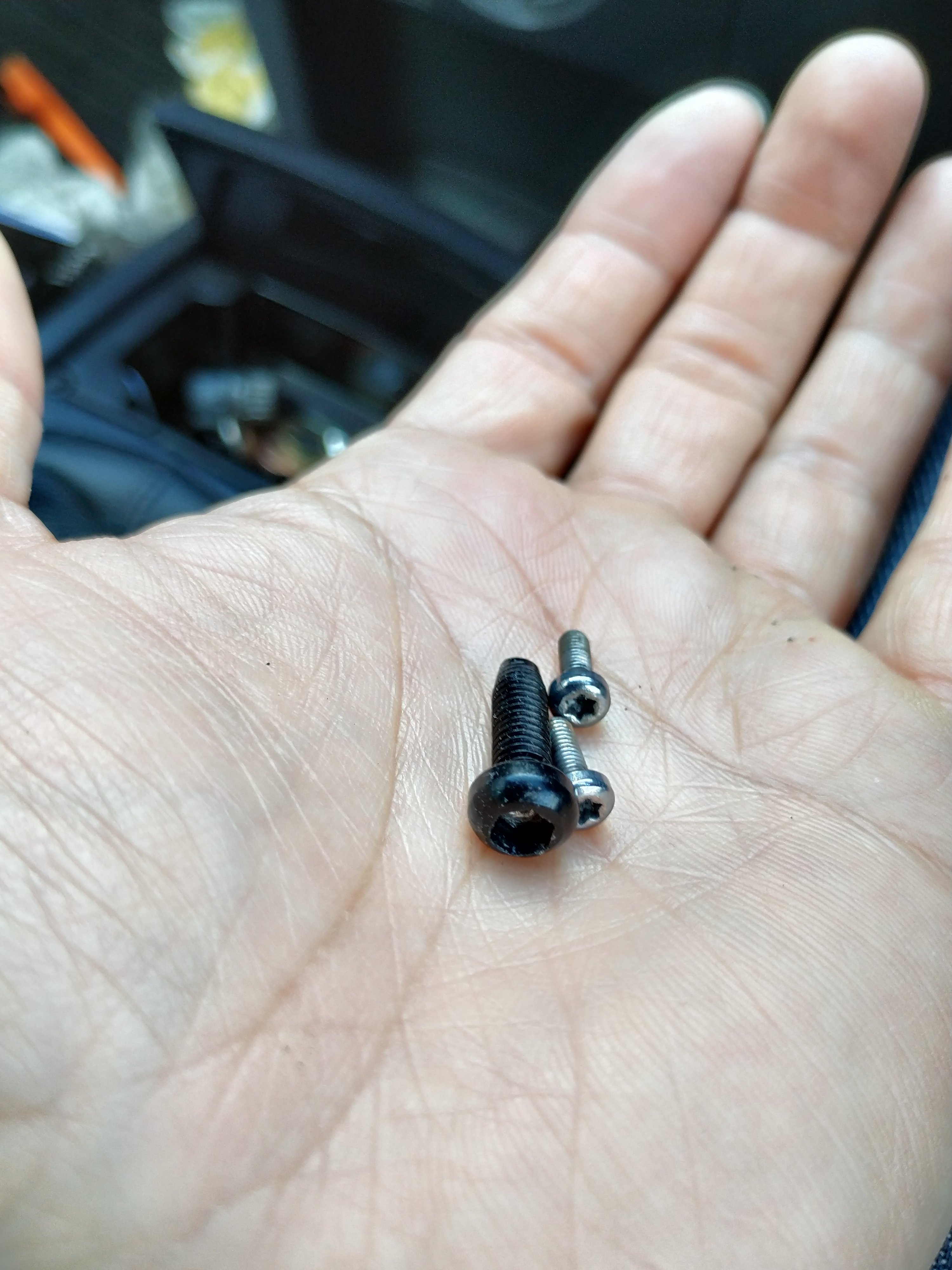

  10. Hi guys, Just an update. I feel stupid now but the reason I was not able to undo those 2 torx screws because someone had changed them to t10 and I was trying t20 screwdriver - hence why it was not gripping it. Have a look.
