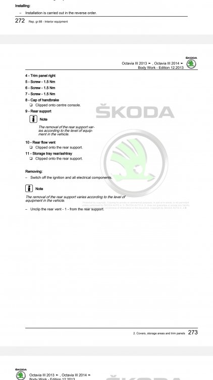

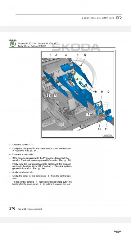

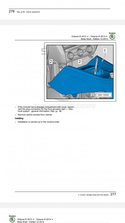

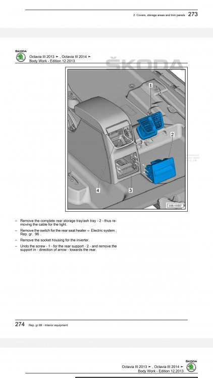

  7. Hopefully this should help... Sorry the pages might be jumbled, I can't seem to re arrange on my phone. But the page numbers are on there!
