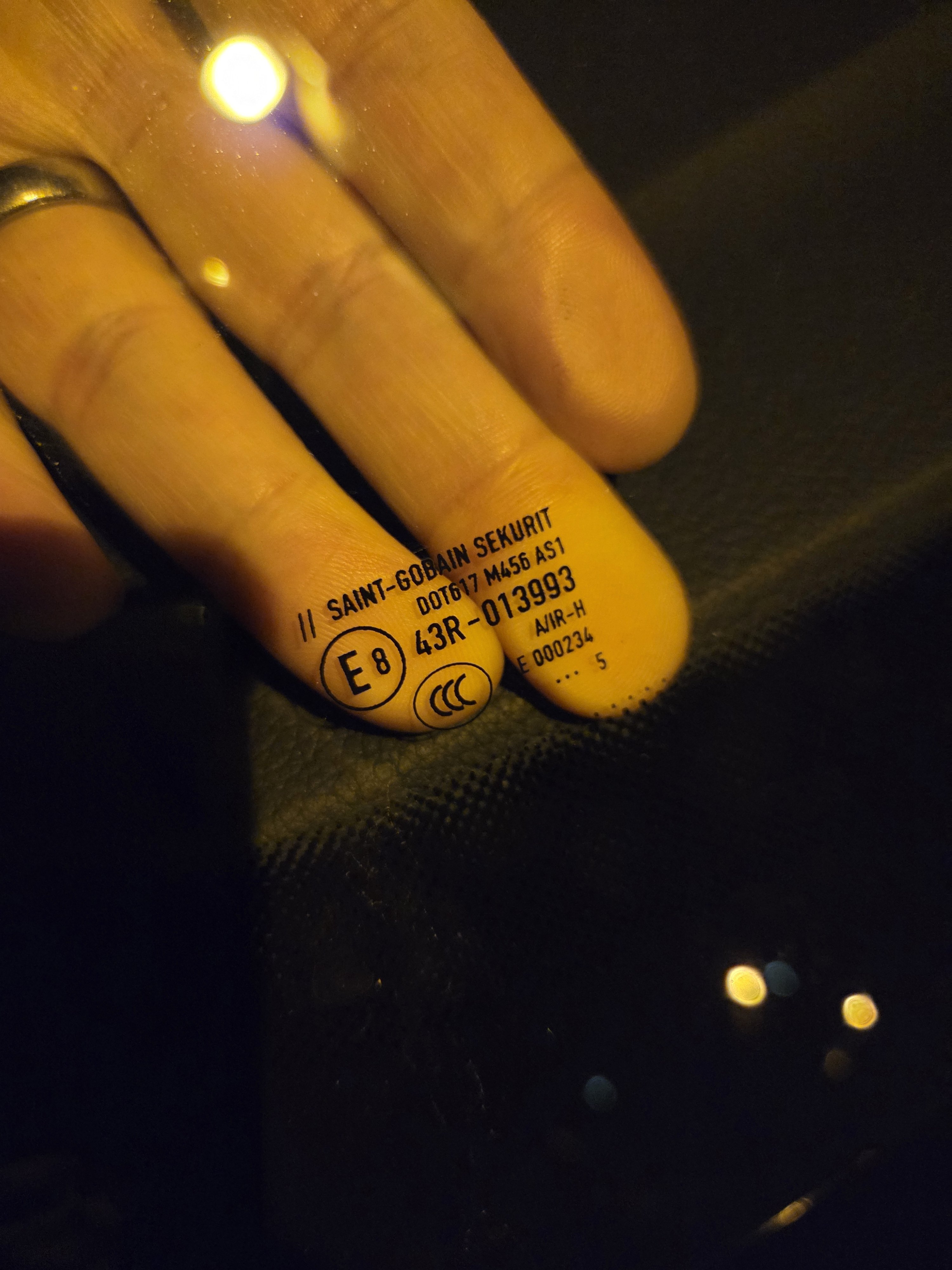

  1. Thankfully having tried it in this snowy and icy weather it would appear it is heated despite it being a replacement at some point in its life.
  2. I'm hoping you're right... I only picked the car up Saturday and it's barely fogged up what so ever so far. I'm hoping for a frost tomorrow morning as I need to move quickly to get this sorted with the car dealer if it in fact doesn't have it. Out of interest, how do you know about the AS1 code? I can see all. The other windows on that car are of another brand and have the skoda emblem on, where as the windscreen doesn't.
  3. I'm having the same issue on a 2022 Kodiaq sportline I have just bought. One of the main things I wanted was heated screen. And the button lights up on activates on infortainment etc, but I cant tell if it is actually doing anything. This is my label, so I'm guessing this is a replacement non heated. Nothing has come up on mu OBD reader for it. I wonder where I stand with the car sales garage (non main dealer) regarding this as it was something the car should have come with, but I'm not sure if they specifically mentioned it on the advert and they have deleted it now.

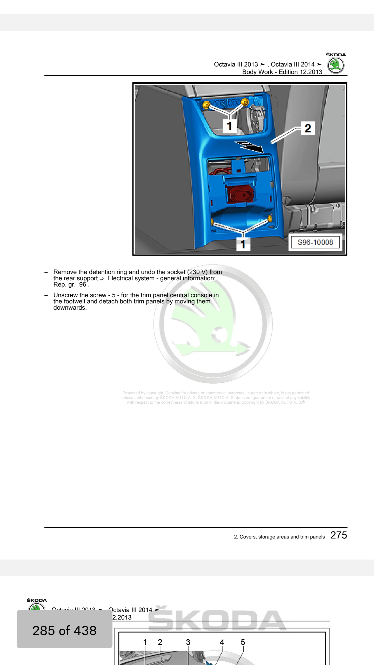

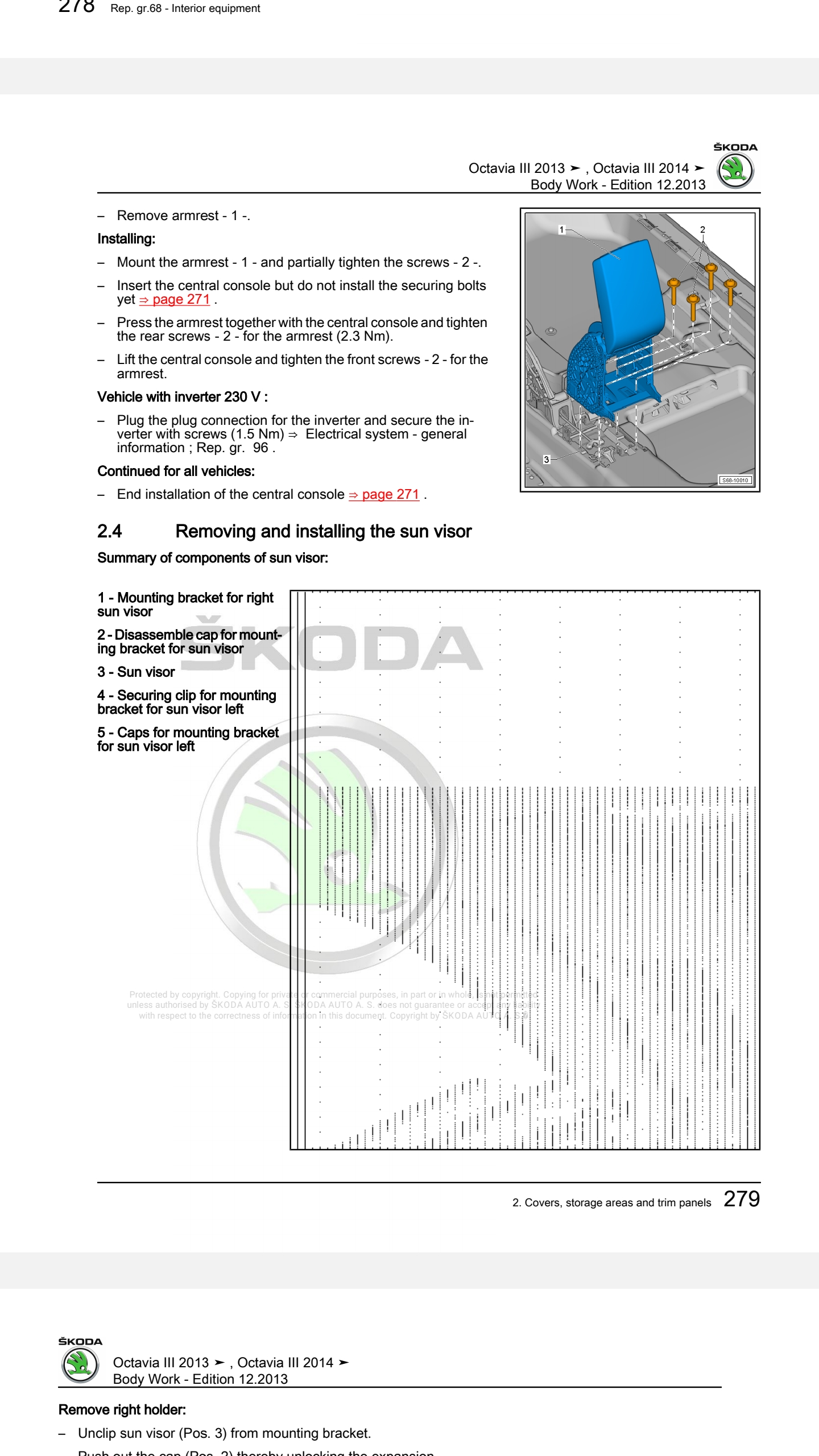

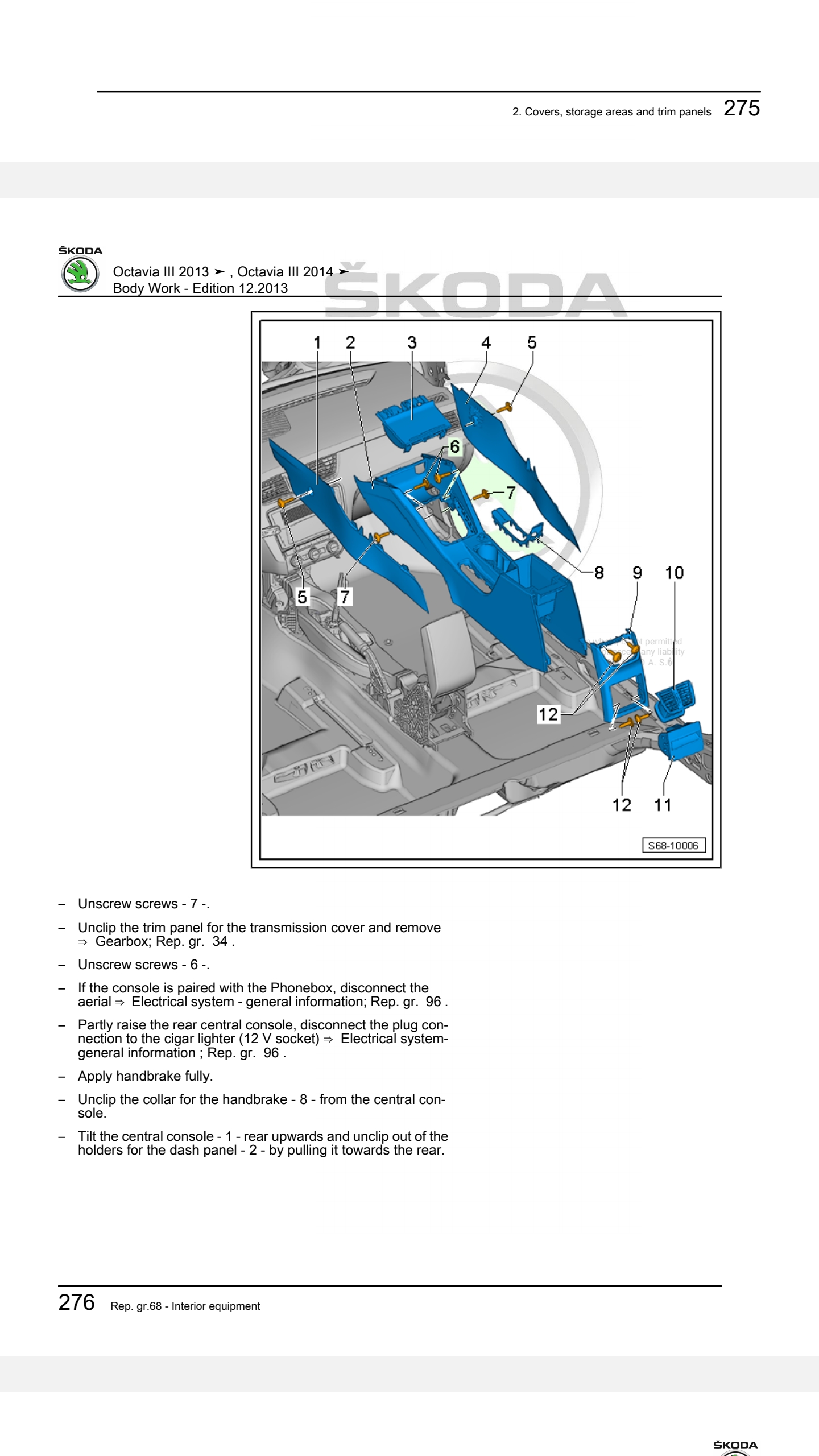

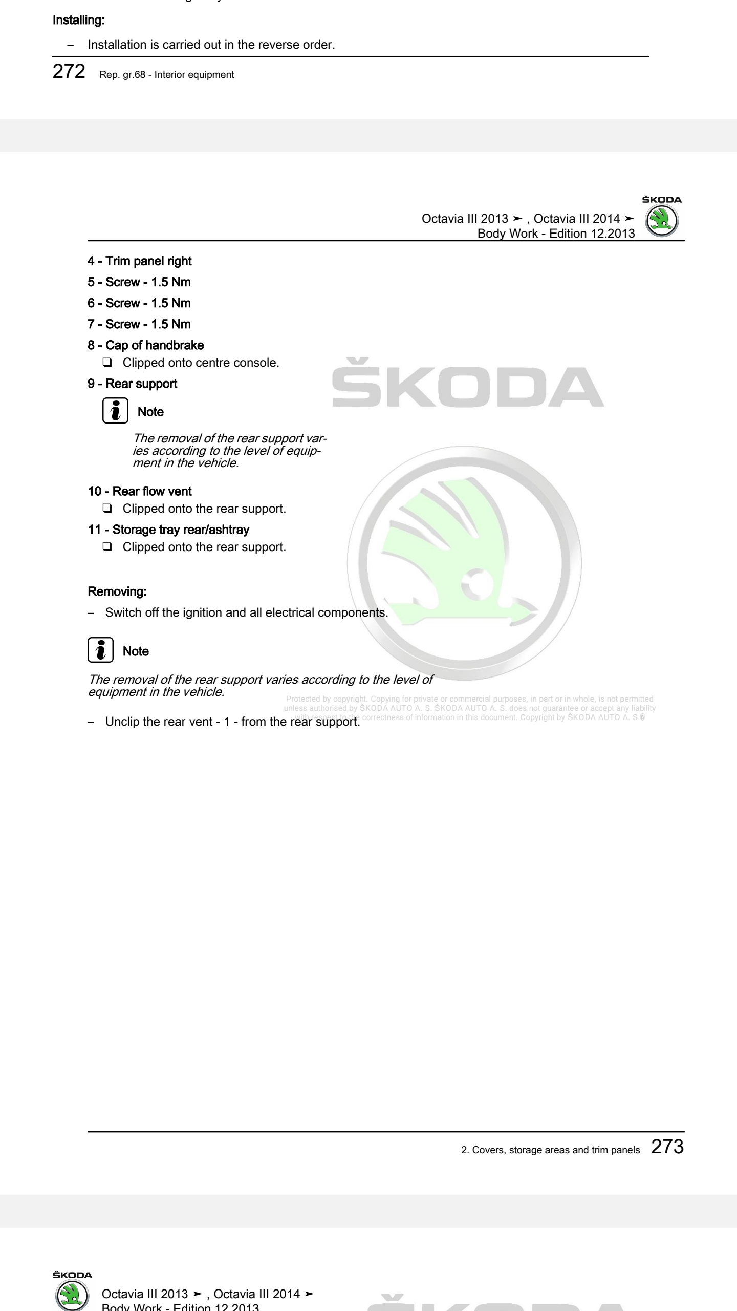

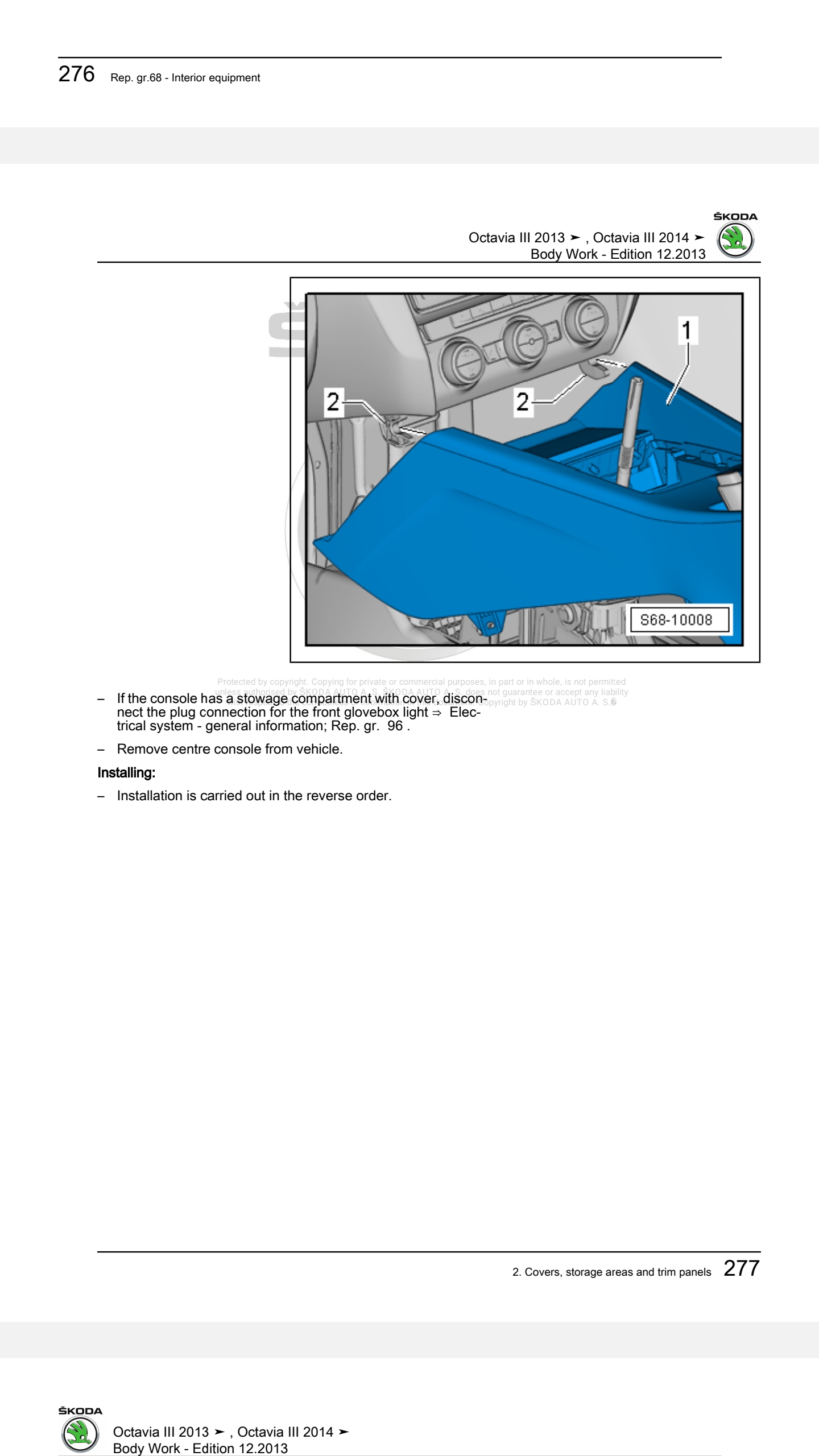

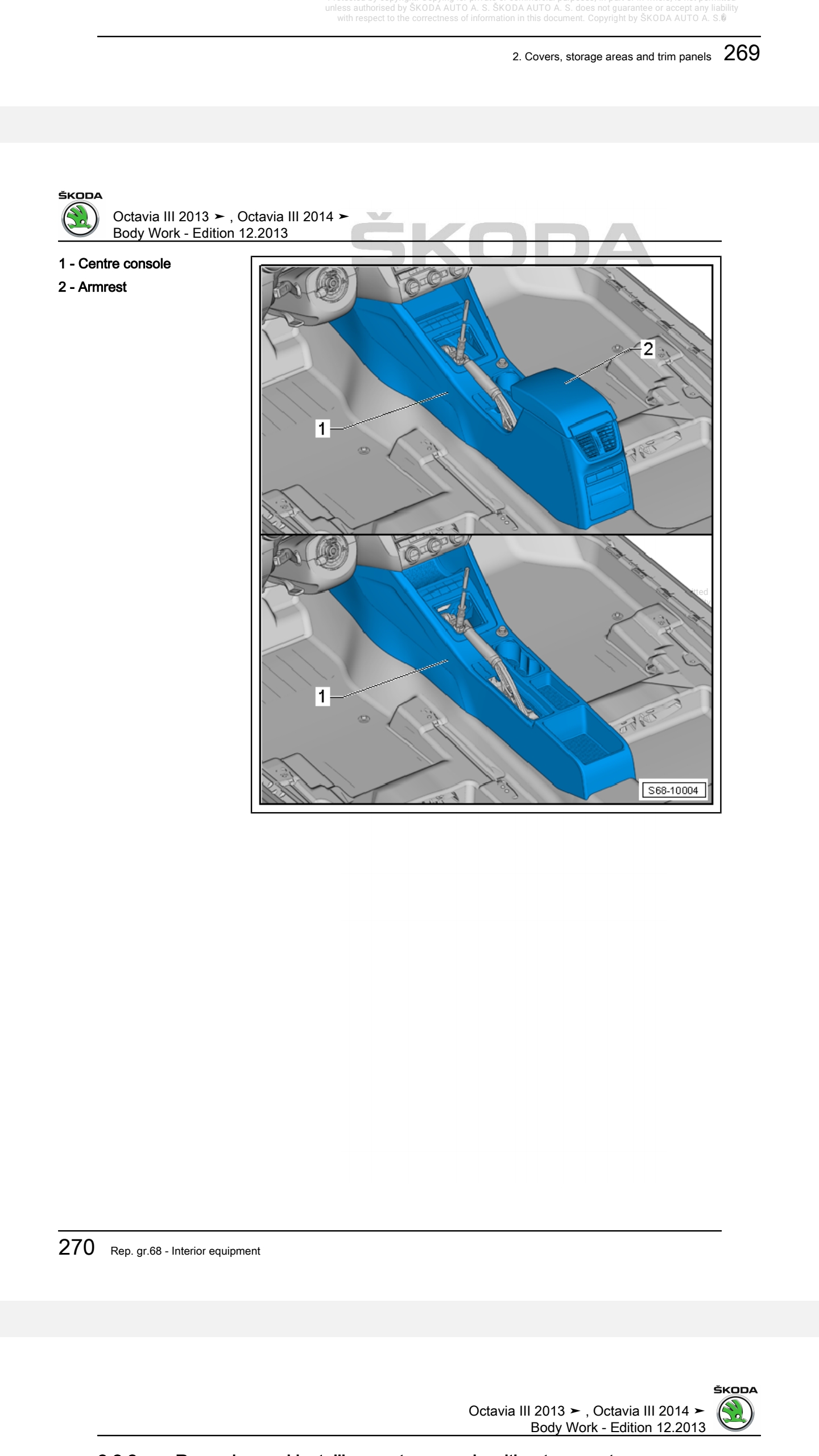

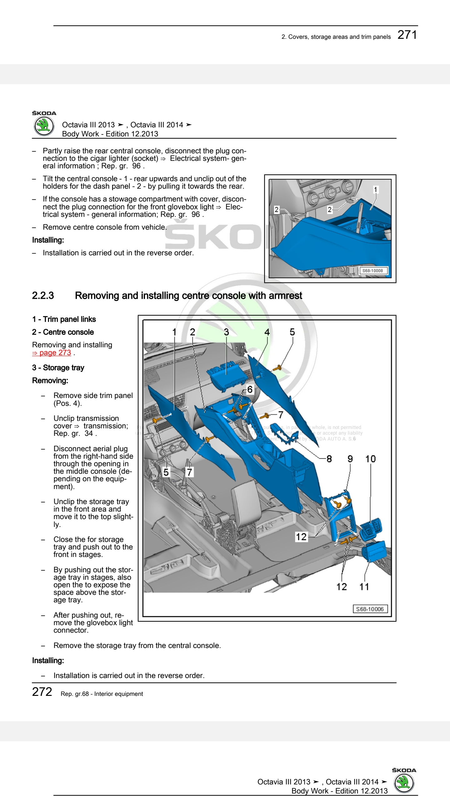

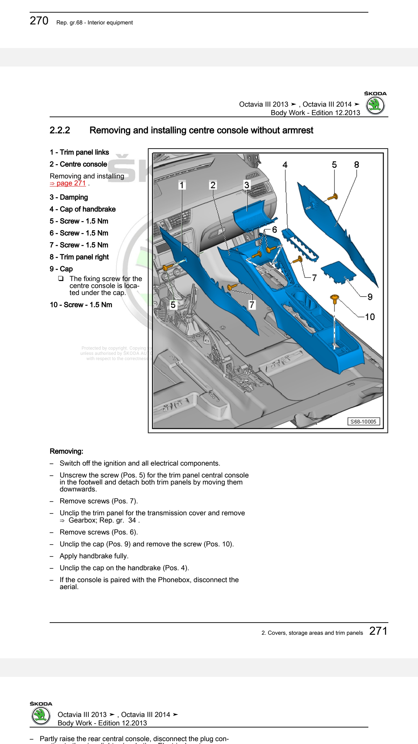

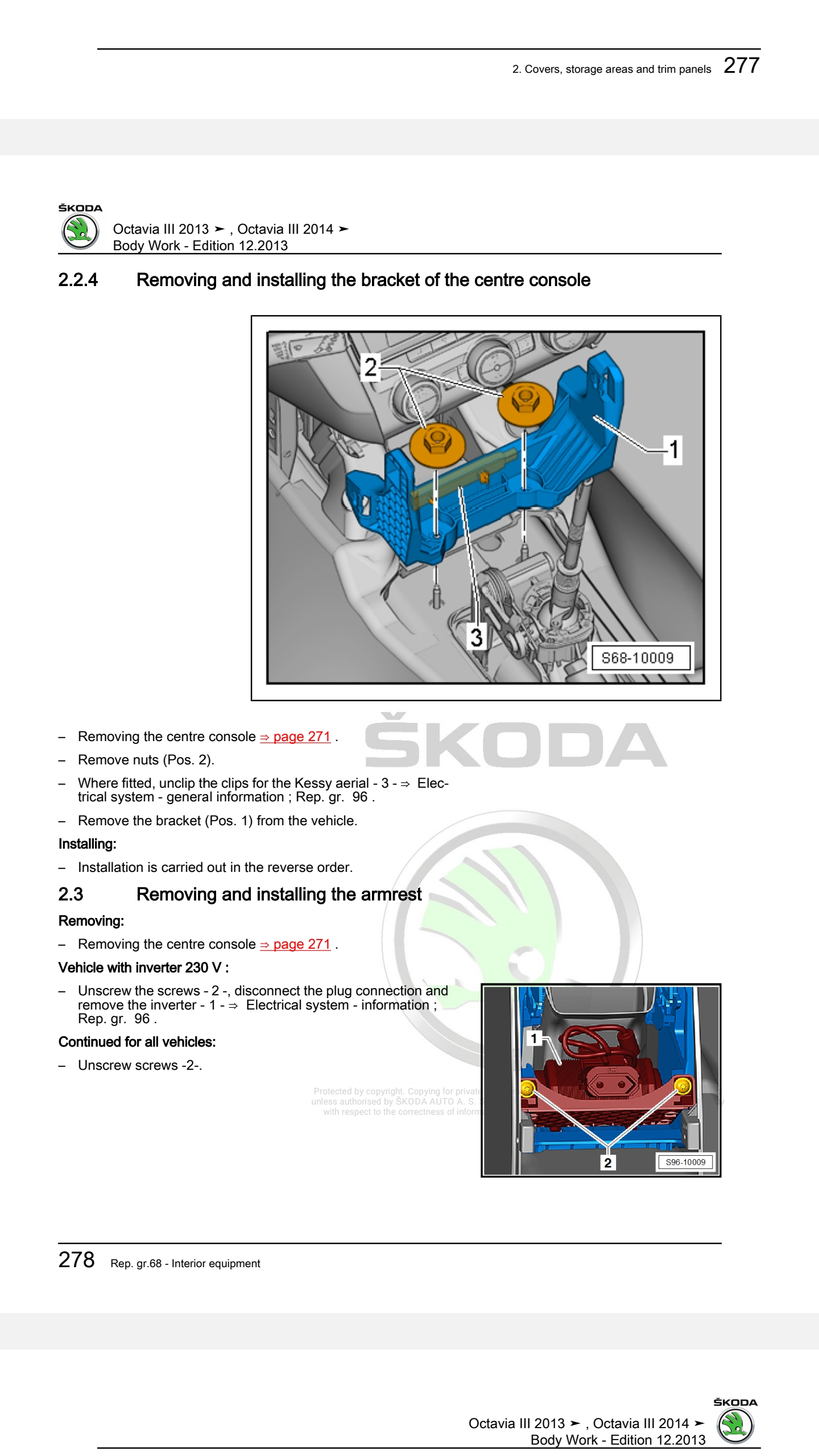

  7. Hopefully this should help... Sorry the pages might be jumbled, I can't seem to re arrange on my phone. But the page numbers are on there!

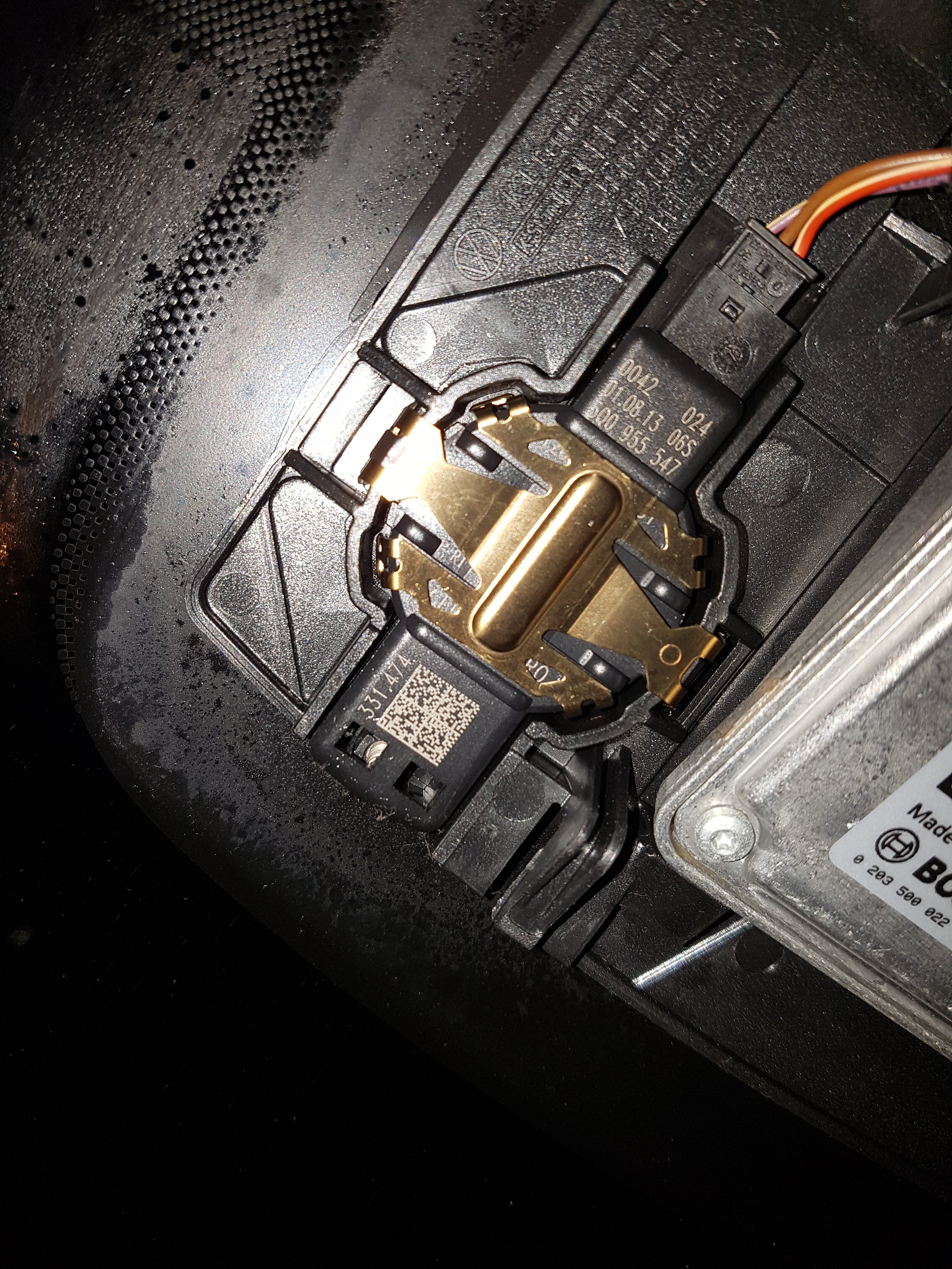

  8. Any pointers in getting the brass retaining clip off though, I can't seem to get that bit to come away at all! Edit... Finally pinged off
  9. Ah bugger, looks like it's a 547,but not with any letter now I've finally got round to doing the job!
