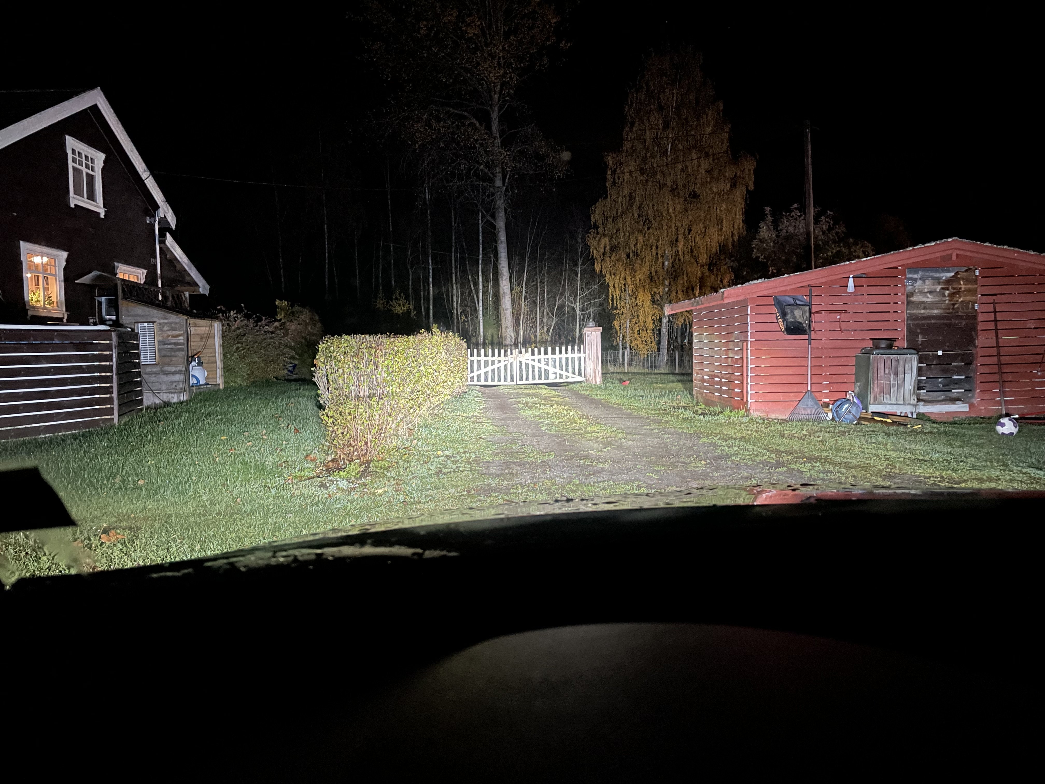

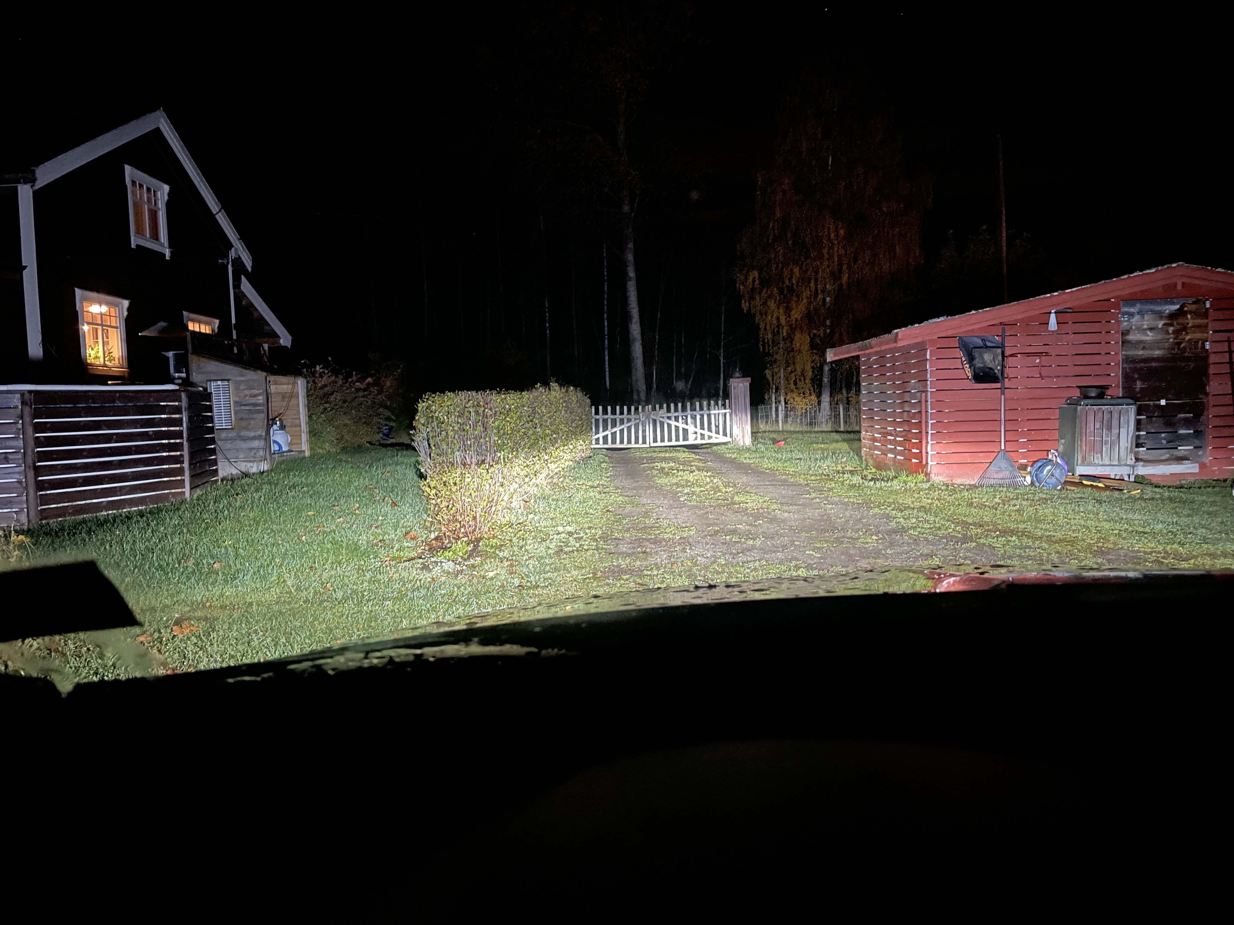

  5. It was raining cats and dogs last night, but I managed to take a couple of pics. Have no "before" pics...
  6. They are 35W, but I have'nt tested them in the dark yet. Did the job yesterday, and took a beer to celebrate😄 Will be tested to night, though. But I am not worried, because the high beam bulbs are just helpers. It's the xenons that are doing the job. So I imagine that with xenons as helpers as well, the pattern will be the same, and the light will be much brighter. But I will be back after testing to night.

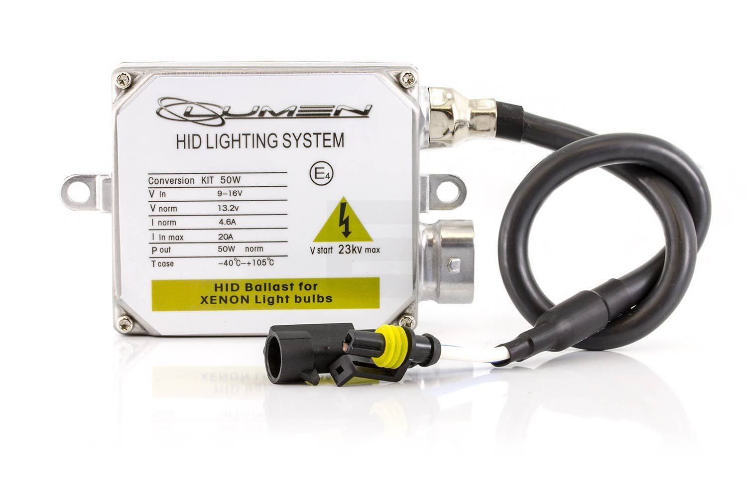

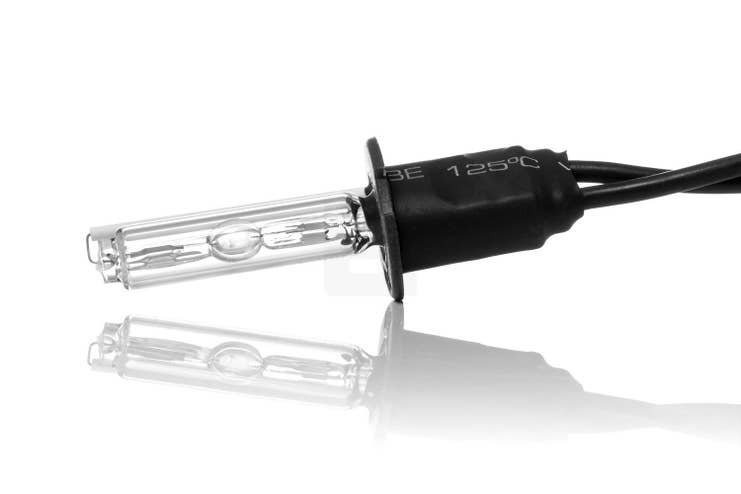

  7. Job done! Went for xenons on high beam after strong recommendations from the dealer. So now I have all 6000k lights, except for the fog lights. They will follow, and they will be replaced with 6000k LED.
