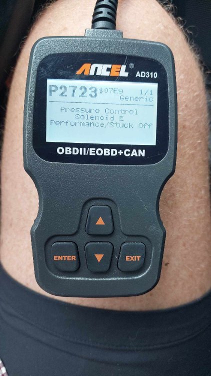

There have been 2 instances 6 weeks and 3000km apart where the DSG only selects 1st gear when in D, doesn't indicate D1 on the dash, however. No reverse, no control in Tiptronic or S mode either.
Resolves itself after a cool down and turned off for a wee while.
No warning lights, just a big box of neutral in R, Tiptronic and S
I have a scan as attached, but that code has been coming up for the whole 12 years I have owned her.
I have only ever changed the DSG oil twice, with an oil filter each time. Last done at 180 - 185k.
Reading the scenarios around DSG then I see a range of problems from solenoid to mechatronic.
