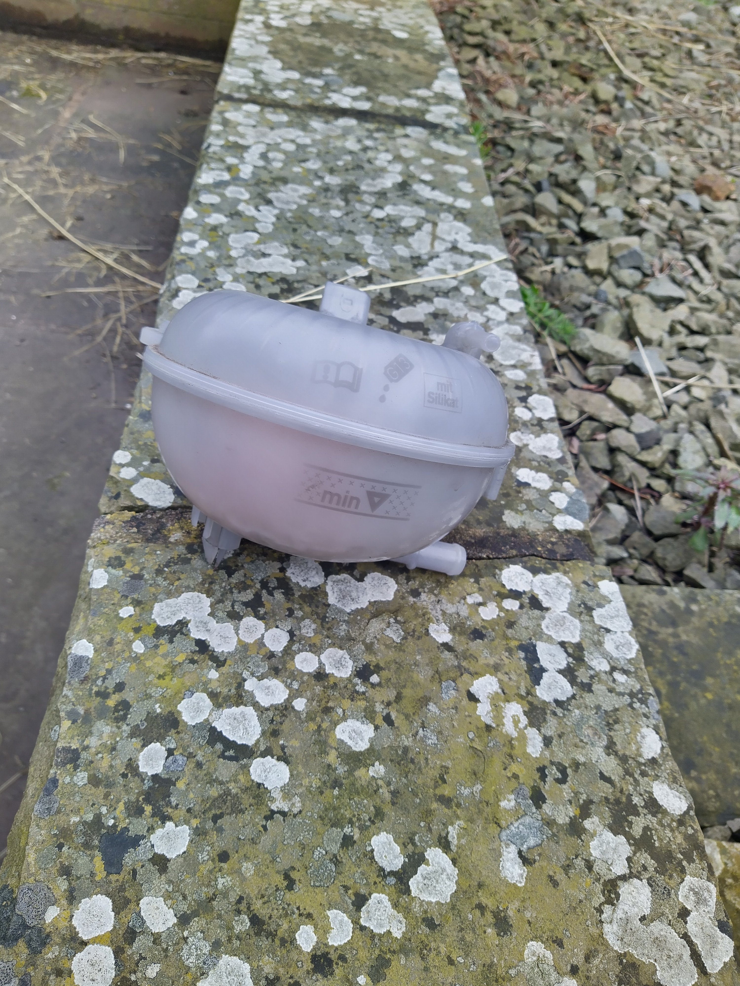

Exactly the same as mine. Skoda know about this problem and from the bag initially being dropped in the bottle this was there next attempt. One good thing the bags I've seen do look relatively strong -

Replacement bottle arrived today. 10 minutes to change. Can just make out the shape of the silikat bag and pink colour. It's not loose and doesn't slosh about, if you weren't looking for it you'd never guess. -

Got to say from the video of the cut in half bottle that the bags strength looks substantial. As long as reports about using a bottle with no bag and switching to G12 Evo coolant haven't thrown up any problems I will be taking this option. My opinion, if this bag does rupture a bill for replacing the heater matrix will be very expensive. The manufacturer will not say there is a problem here but have thought it necessary to upgrade bottles to keep this bag in the system and prevent major engine corrosion. -

Hells bells, so the bag is not accessible from the filler cap. Will see about getting a replacement I think. Thanks Enter -

Although the car has done 28k miles it is coming up to 5 years old and Skoda dealer recommended cambelt and water pump change. Be interesting to see if they put what kind of coolant they use -

Checked bottle again definitely no bag, although says G13 mit silikat. Think mine is a revised bottle, small tube running vertical could be the silikat reservoir. -

Pretty sure there isn't an actual bag in mine, some variations of the bottle held the silicat in a pocket or between double skin bottle. I haven't been on Briskoda for about 2 years and this topic was Hot! If people have replaced the bottle without any sort of silicat being present and have not encountered problems could they let me know. There are so many after market bottles on the market, they don't say if silicat is added. -
I have a 2ltr tdi 18 plate with mit silicat on expansion bottle. Cant find bag in reservoir guess it may be different type. Coolant is as it should be, colour/clarity and no heater issues. What are you guys recommending , do I change the bottle without any silicat additive in, or leave as it is. Recently had a major service by main dealer and when asked about this was told there is no recall on this issue so they have no reason to recommend it being changed it is my decision. regards
