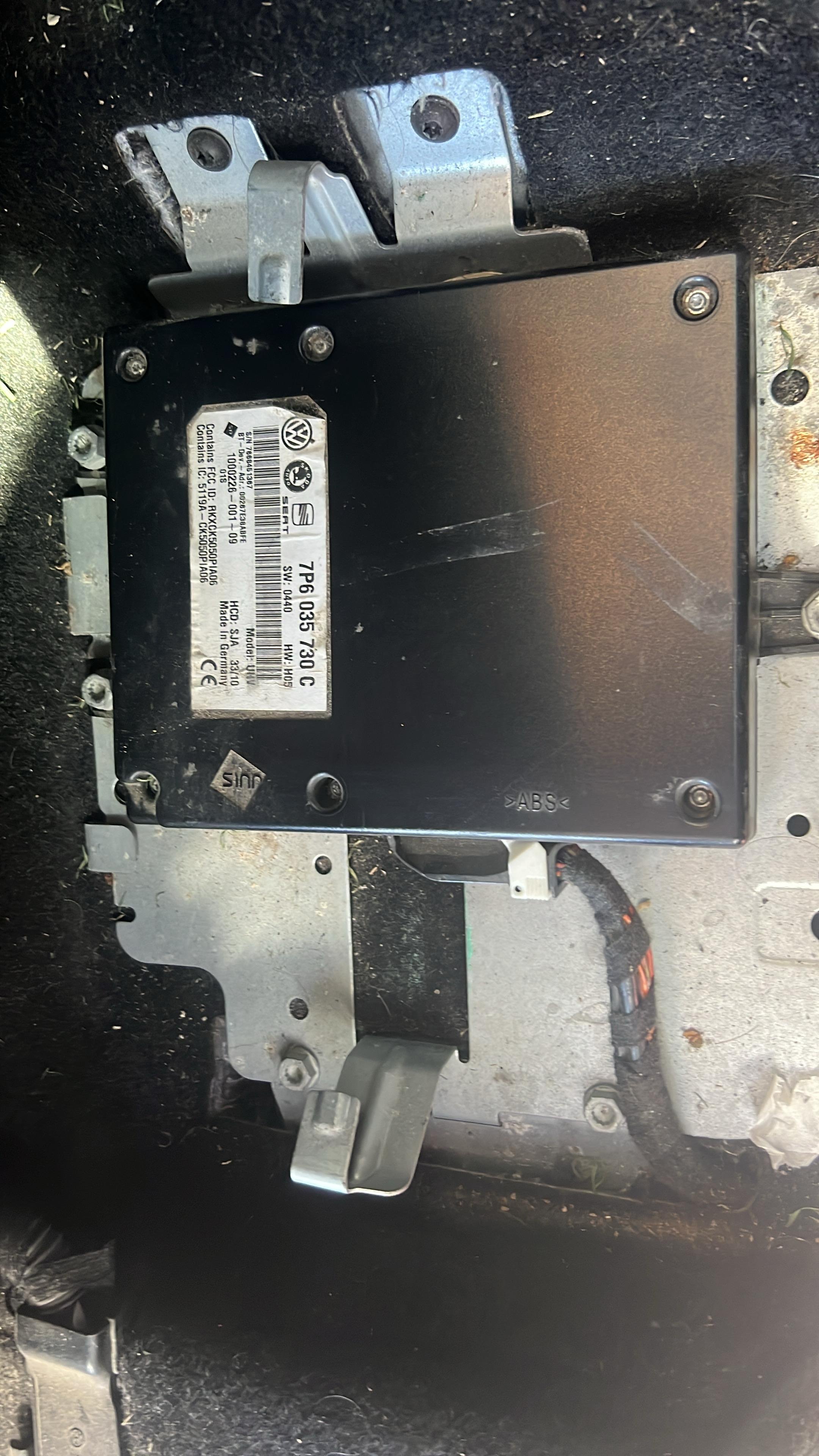

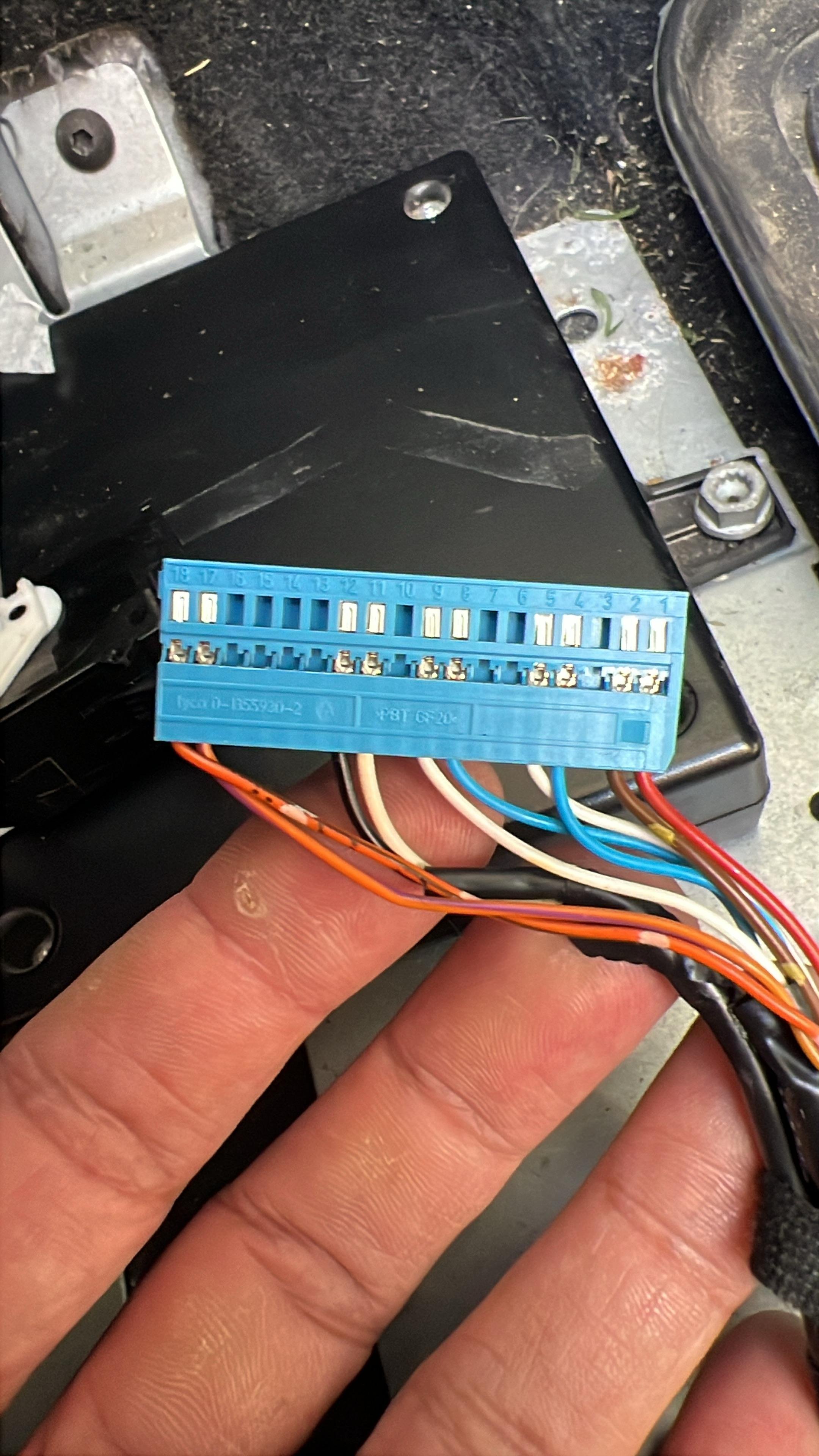

  5. Hi all, I'm currently replacing my RNS510 (Columbus) with an MIB2 device that supports CarPlay. Everything is working correctly except for the microphone. My car originally had the Bluetooth hub (7P6035730C) installed, which I have already disconnected. I'm now trying to bypass the microphone on the connector, but so far, I haven't had any luck. Has anyone encountered this issue before? Does anyone have the pinout for this bypass? Thanks in advance.
