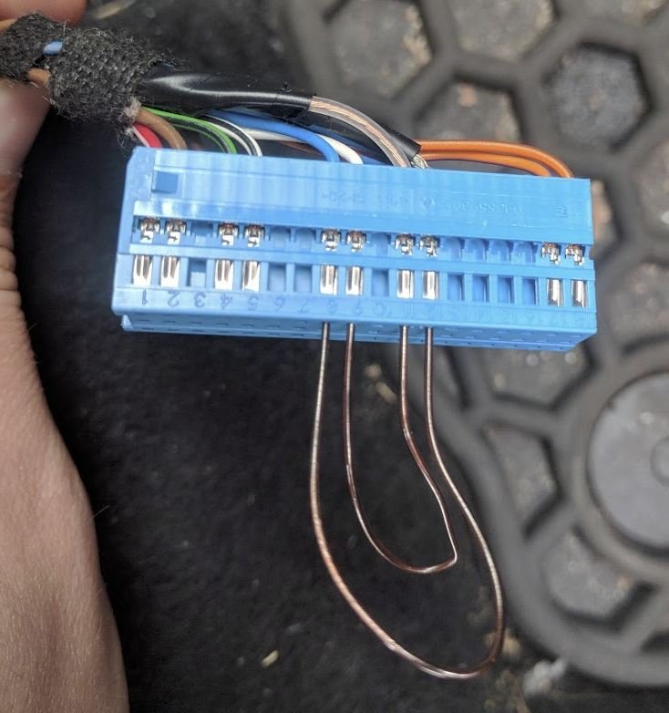

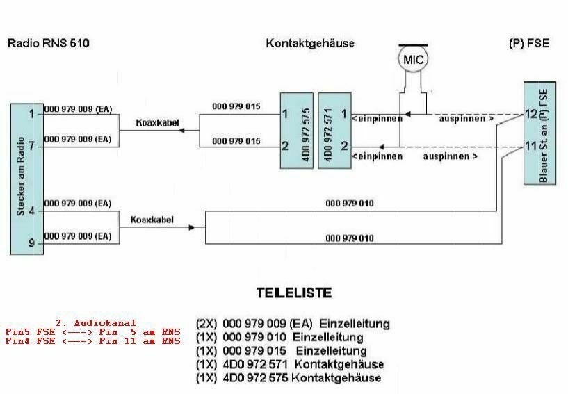

B.t.w. you shouldn't just use a bypass, but also have to change the pins on the radio side, to connect the old aux wire from the bluetooth module to the microphone-in connection. (Or you need a quadlock adapter who does this).
Here is a diagram (and a picture) I collected:
Edited by andrehj
