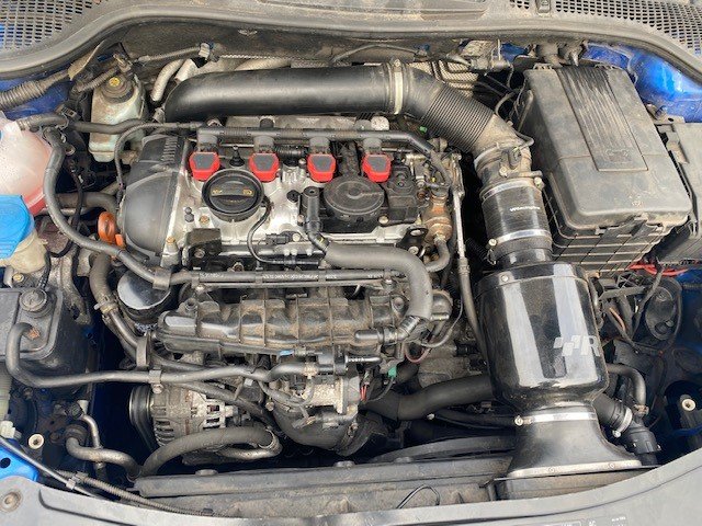

  2. Hi, didn't consider the pipework for the intercooler, will check all that as well. The engine is a 2.0 TFSI CCZA, I've added a picture for reference. I've also checked what I can see of the intercooler and there are no obvious signs of holes. It looks from the diagrams there is a fair bit of pipework to check...

  4. Everything looks good, no leaks that I can see, when I say very basic I've checked all hose's I can see from bay and all levels and everything is good. As I said, when I try to put the pedal down its like there is an air leak between turbo and manifold. I've done a simple trace of pipes and all connections good from the bay but some advice on where the turbo pipes and connections go would be appreciated. I'm a dab hand with hose clips 🙂
