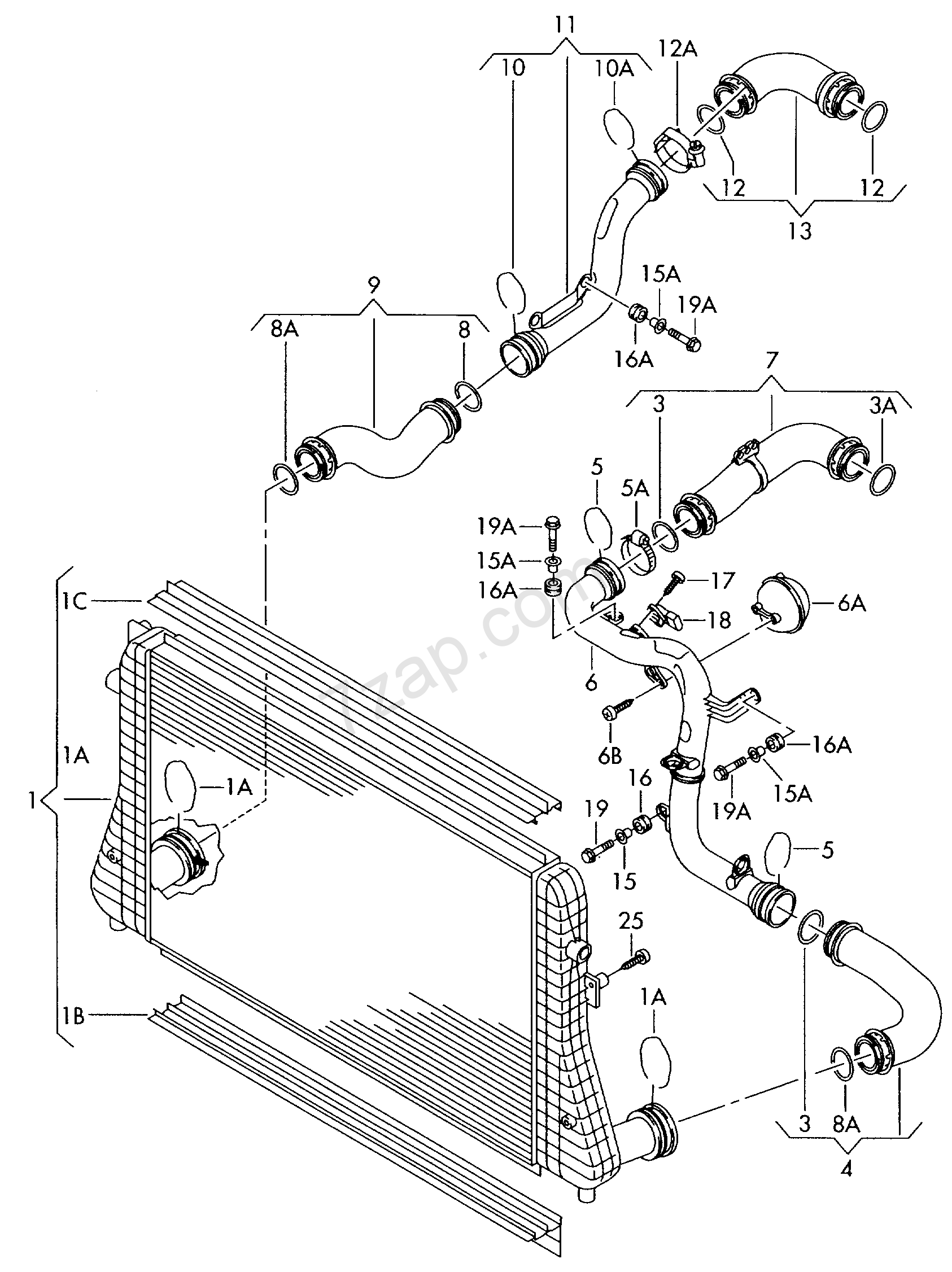

The engine is a 2.0 TFSI CCZA, I've added a picture for reference.  I've also checked what I can see of the intercooler and there are no obvious signs of holes.  It looks from the diagrams there is a fair bit of pipework to check...
