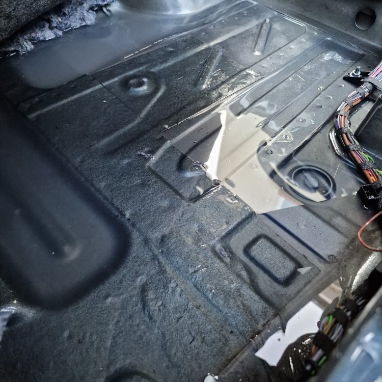

It's having a new windscreen next week, as luck would have it I was driving it on the motorway and a stone chipped and cracked the screen so when it goes in I'll mention the leak
The water is coming in at the top of the windscreen, the seal appears to be defective. I've cleaned it up and siliconed the top joint while I consider whether the insurance covers a new screen . At the moment the underlay is still drying in my conservatory. I'm opening the car doors when the rain stops to try and dry it out
I'll give the screen a push tomorrow
I've taken off the wipers and the scuttle then run a hose in the recess but all water tight. My next job is to sit inside the car and have the Mrs spray it with a hose
The foam underlay weighs about 20 kg 20230725_200934.mp4
It's literally awash 20230725_200934.mp4
My 2014 superb has soaking wet carpets on the off side /driver side RHD. I found a rip in the plastic cover behind the door panel, I filled the rip with silicone mastic and thought I had sorted it but to no avail, the car's been parked up for a month and it's sodden in there.. Any ideas?
