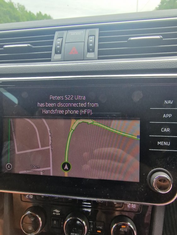

Over the past week or two in my L&K 70, android auto has started flashing up a sign telling me that the Handsfree Phone HFP has disconnected. It happens regularly, as in every 10 seconds to 20 seconds. It's pretty annoying as it covers the top 3rd of the map.

Feels like a car issue where it's getting confused between an android auto connection and the regular BT connection for calls and media through the skoda interface. I'll try and get a picture of the error message.

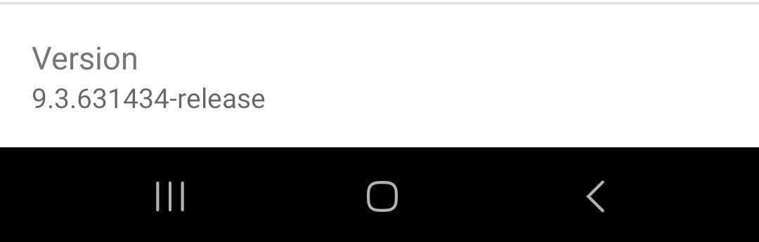

My wife's phone S22 works well. The only difference with mine is android auto version. Mine is 9.3.631454, wife has 9.3.631434, release date is 04/23 vs 05/04. But I cant update wife's phone, play market considers it updated. What AA version do you have?

I have the following AA version:

Ok, seems like the problem is not in version 😞

Can confirm mine is doing the same very frequently at the moment too
