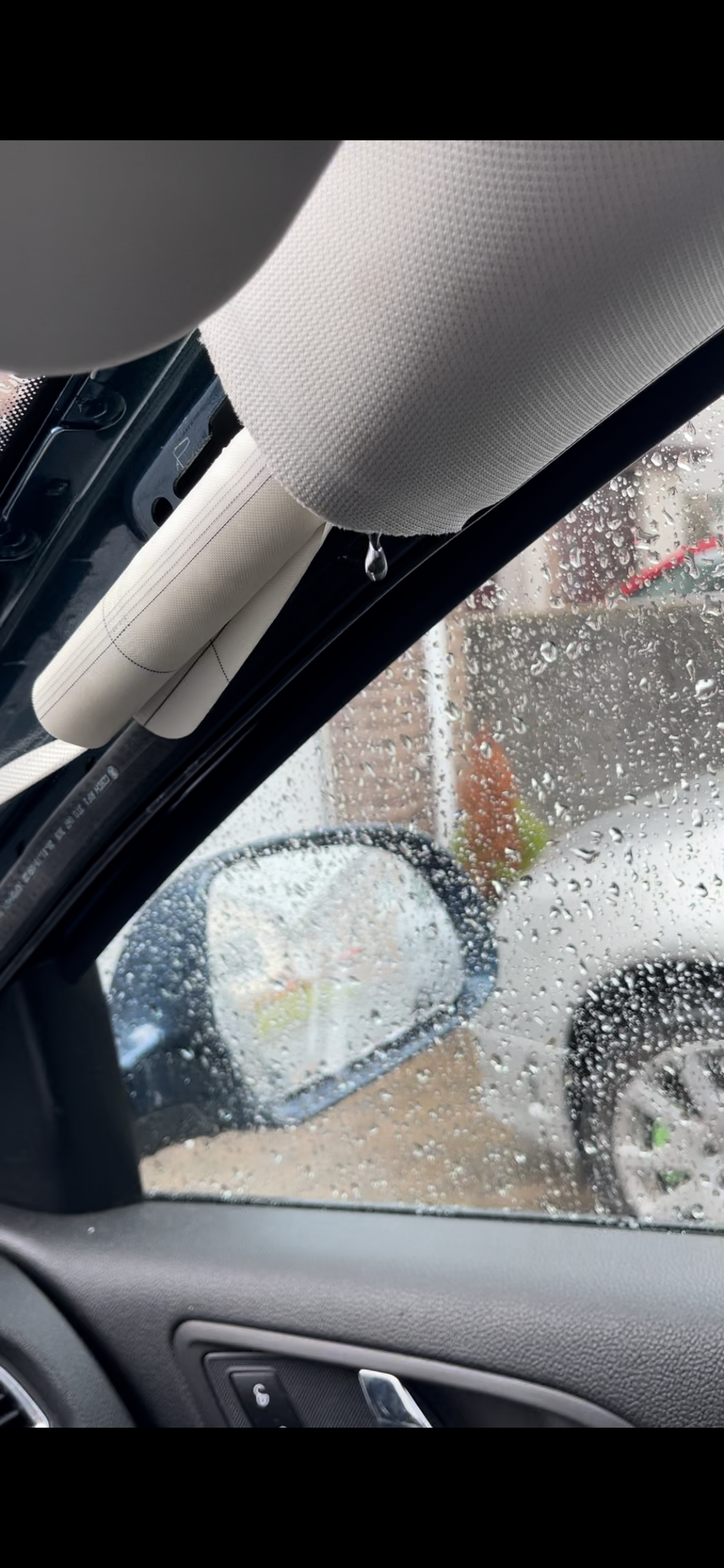

My issue was windscreen
the water was actually running behind the A pillar trim and down through dash into foot well.
you could actually push the screen up from inside

Remove the A pillar trims, if it wasn’t for a little bit of water on dash I’d have never thought it was the windscreen

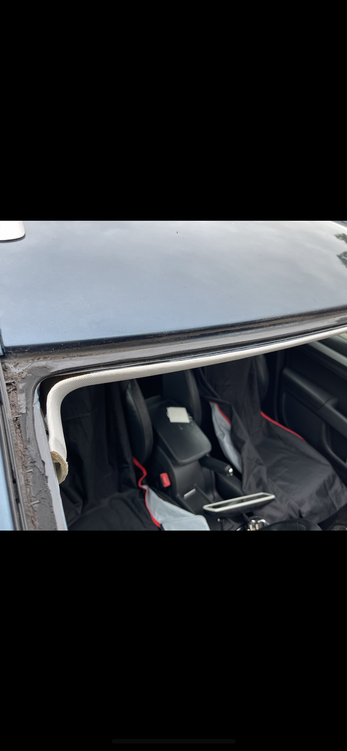

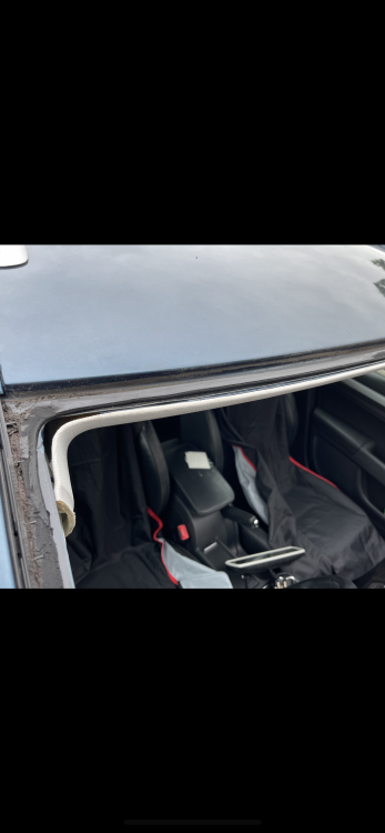

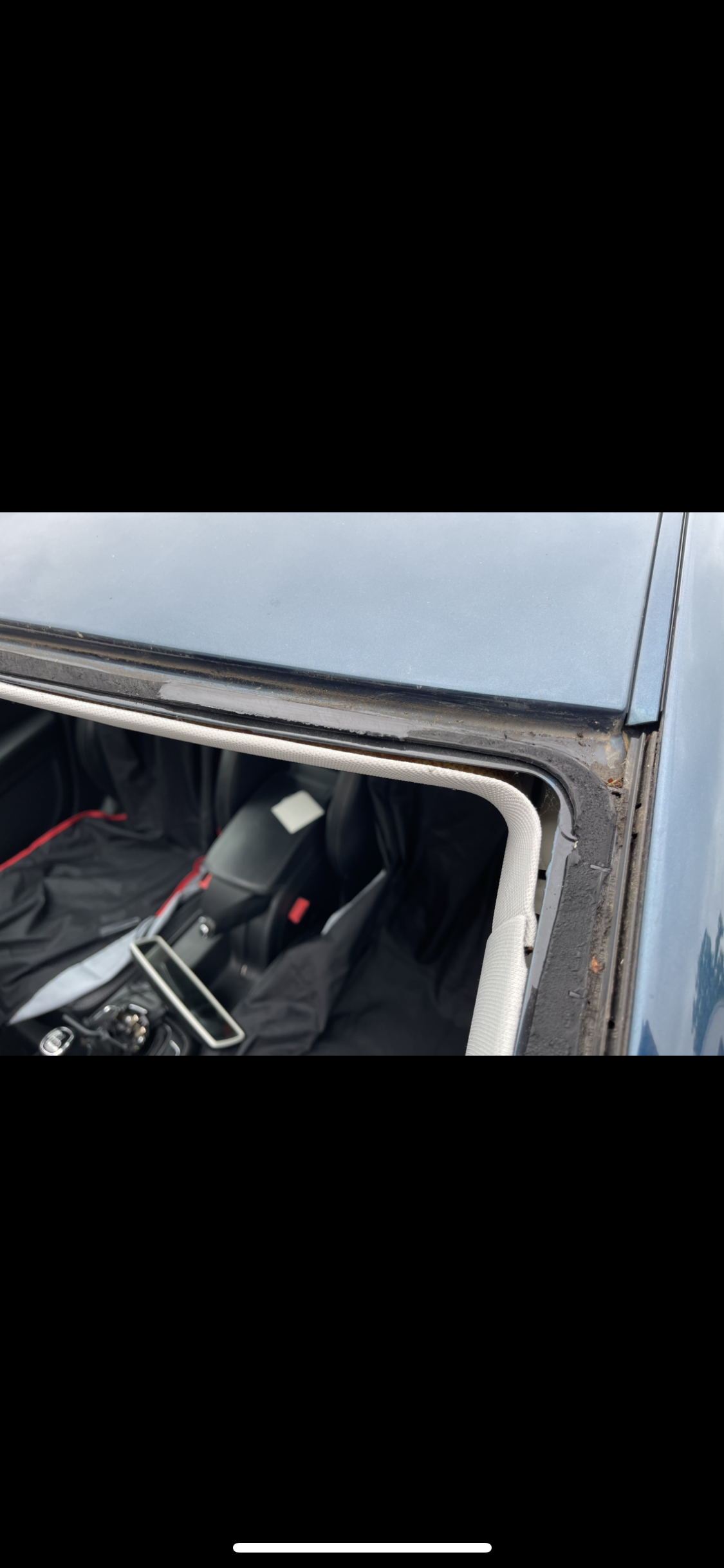

Most likely come unbounded like mine, you can see the smooth parts on pics I posted other day when the screen was removed along the top.
