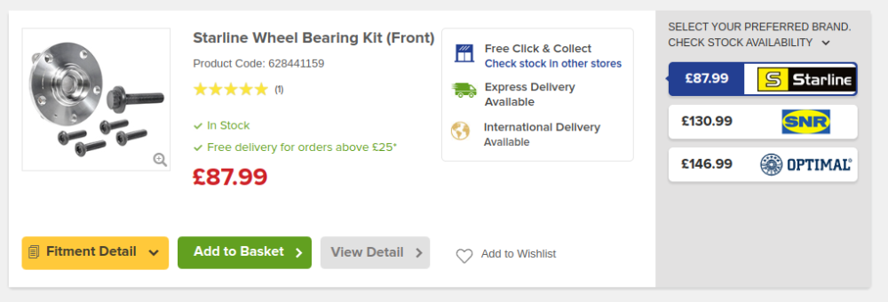

Wheel Bearing change but which brand!!!
I have that noise you get when a wheel bearing is on the way out its terrible!! Get to 60mph 2.5k revs and you get the droning sound. Which brand should I go for?
