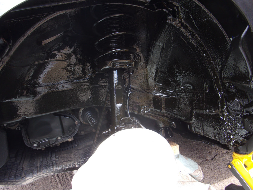

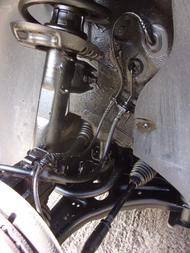

    Hi, Our Yeti rustproofing under way 7 years old it was rusting badly. This looks much better. This Bilt Hamber isn't cheap but well worth it. Rustproofing under both front wings has taken two days; wire brushes; scrapers; and coarse abrasive paper were used to remove loose rust; items not to be sprayed were masked off; pedal bin liners were perfect to cover the brake disks and was secured with masking tape; other areas covered with paper and cloth; an old heavy duty lined curtain protected the driveway; it's an incredibly messy; sticky job. The axle stands I bought through eBay still haven't arrived so I used two trolley jacks for safety; one under the jacking point on the cill the other very near under the chassis; both wheels on the opposite side were chocked with bricks. The wing liners were fun to remove having found all 19 T25 Torx screws but a great deal more fun to replace; I've ordered new screws and fasteners and will replace all once they arrive; I'm going to try these stainless self tappers and bought 50 to experiment with; I'm not in a hurry but am worried about our usual dire wet climate; I hope the rain holds off for another two days; if I get all four under wings done I'll be happy but I'd like to rustproof the cavities too. I emailed the eBay seller of the Bilt Hamber asking if it had a shelf life but fortunately the reply was good news; 7 years if in the container. White spirit gives easy clean up; I'll start on the rear end tomorrow; it's tiring work and for a change it's been 25C today so no complaints from me; fingers crossed it will last. This is the story so far. Before I forget; I was discussing rust proofing with a local top end car restoration guy and he told me he gets lots of VW's in with rotten front wings stating there's a large foam packing piece glued to the under wing at the top; this is shown above removed from our Yeti and both are now removed; these accelerate rotting. Kind regards, Colin.
