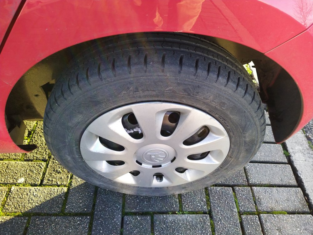

  1. Mystery solved, (thanks @AGFalco !) I was rear ended when stopped in traffic some months ago. I'd forgotten all about it - I was the front car in a 3 car shunt. It didn't seem bad - no visible damage on the outside and I was consumed with other more serious things that day, so I just said don't worry about it to the guy at the back. But yes - the wheel well is clearly dented. That explains it all!!! Probably will cost a fortune to fix that but maybe I can pop it back myself because there's no sharp edges in the dent it might be ok.

  3. Sorry only getting back to this thread now. Tyre on the steel wheel is 165/70R14 ("Falken" brand? ) Just too big for the spare wheel well basically.
