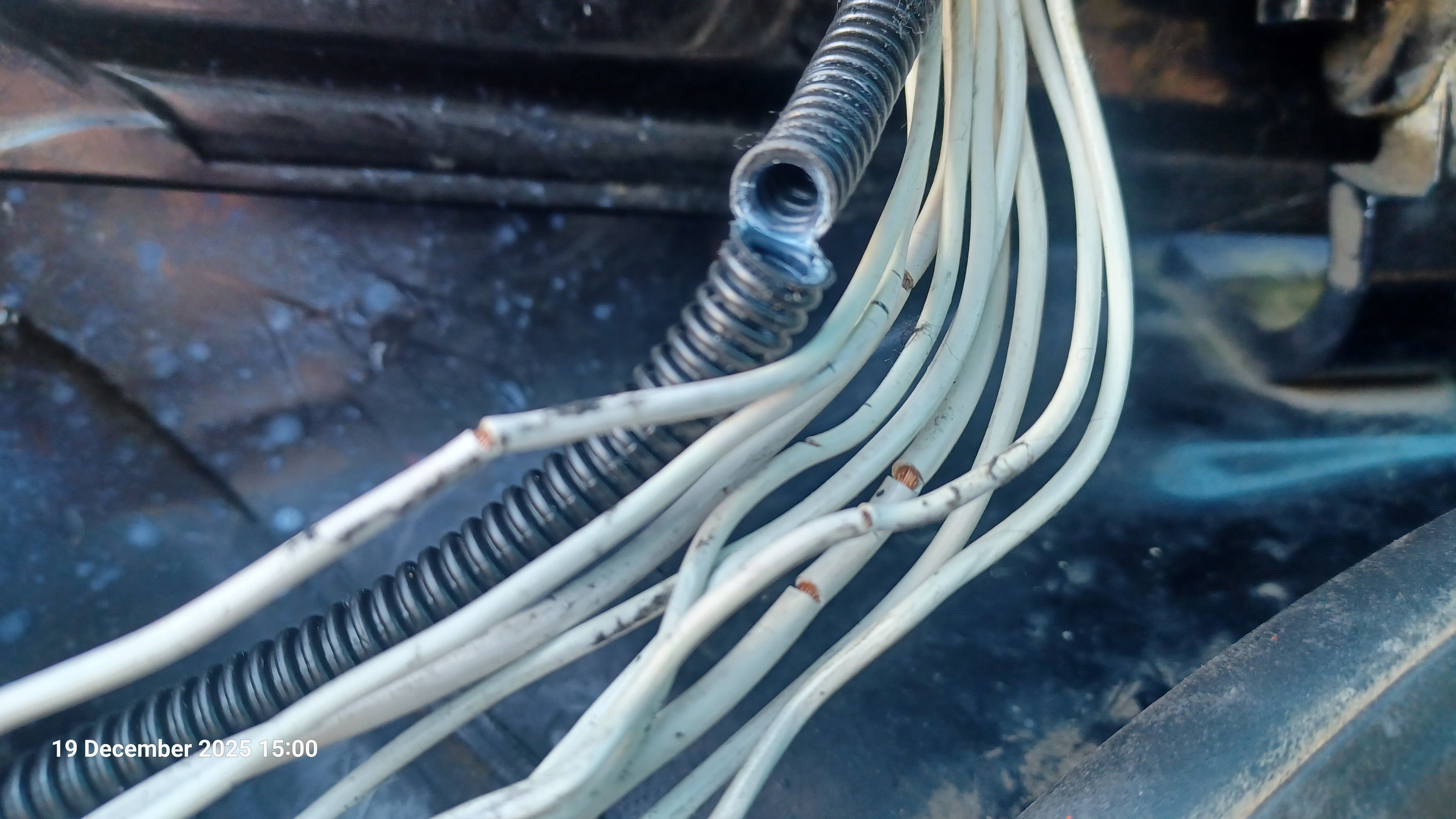

  4. Sadly the rear trunk light is not working either. I took it out and it had corrosion on one of the terminals. But the real problem was a small resistor I think. Why do they make life so complicated ...... There are wires running to the bottom catch on the trunk lid, but nothing on the part that sits in the door frame, but as I said above, I have already replaced the latch on the the bottom of the trunk. Thanks for your reply.

  6. I'm here asking for guidance and help as have exhausted other sources and my own knowledge . Bought the car as a CAT S having had rear bumper damage. Not quite sure how bad it was but the car came with a removable tow ball , but nothing to fit it into. I can see the electrical plug tucked up behind the bumper ......all this just for a bit of background information. Car runs very well and I'm VERY pleased with it, apart from not having a rear wiper or washer. The latter I can live without , but a rear wiper really is essential. So far have replaced the rear wiper motor and also the rear tailgate latch but I still can't get power to the motor to run it. The dash display MFD ? is showing the tailgate is open even though it is securely closed , and my question is " what factors influence the display of that tailgate message ? "......or where does the MFCD get its information from as I think the spurious information is what is causing the wiper not to work. I have checked the wires up in the door/body rubber casing and found at least six have small breaks in the plastic covering of the wires, but no wires are actually broken . I have removed all the tailgate interior trim to see if there is any other obvious issues with wiring , but its all hidden away inside the door skins. My final thought was a bad earth.......but where is that located for the rear wiring and anyway if it was a bad earth, then I'm guessing none of the rear lights would work or are there separate earthing points for different electrical items ? Slowly driving me nuts as it's really such a basic thing and yet with the wiper having so many trigger functions, i.e. column switch, selecting reverse gear with wipers on etc, I'm really at a loss where to look now. Any help or guidance would be much appreciated......and I'm sure its not that wiring up by the tailgate left corner as the wires all look perfect. Thanks, Frank
