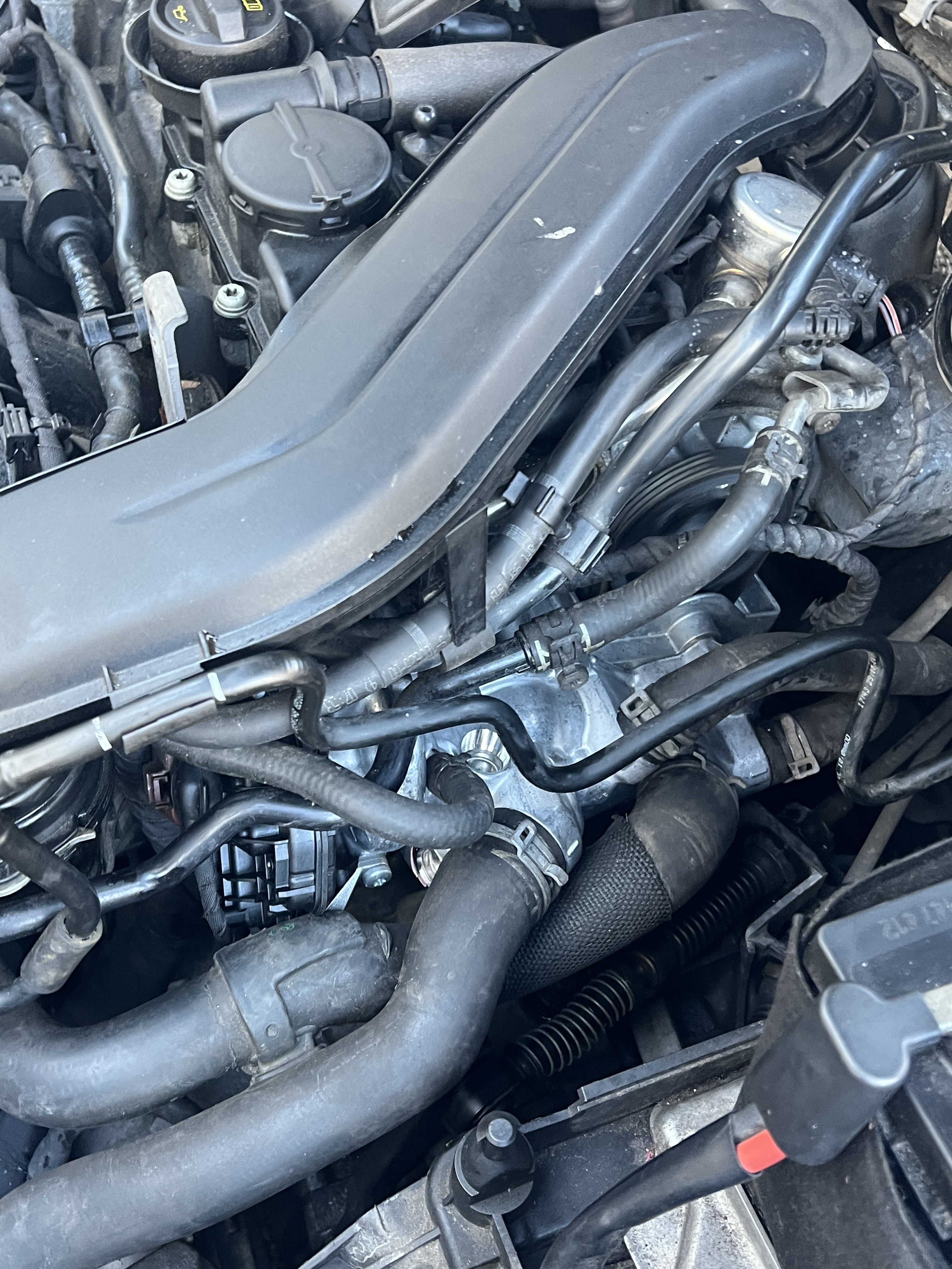

  1. The car was getting me down a bit this week as there was hesitation in 2nd and 3rd, vibration in the cab from an uneven idle and the issues on start up. I was messing about with the pipes and took the one pictured off and put it on again and everything has went back to normal. The car is responsive and you can’t even hear it running. No idea what I’ve done, perhaps cleared an airlock or in typical mechanic fashion they’ve maybe not put the pipe back on again properly and there’s been an air leak. Thank goodness for that.
  2. The mechanic is currently stumped as to why there’s excessive suction. You’d hope he’s checked the breather pipe but you never know. I’ll take it off and have a check myself.
  3. Small update. Spent today driving it and it’s certainly not 100% as it’s hunting on start up before settling down and there’s a bit of additional vibration in the cab at idle. (There always was a bit but it’s worse). There’s also a bit of a whistle noise which would certainly indicate a leak somewhere, possibly the intake manifold which may be causing the excessive suction in the crankcase. Here’s what it’s doing on start up
