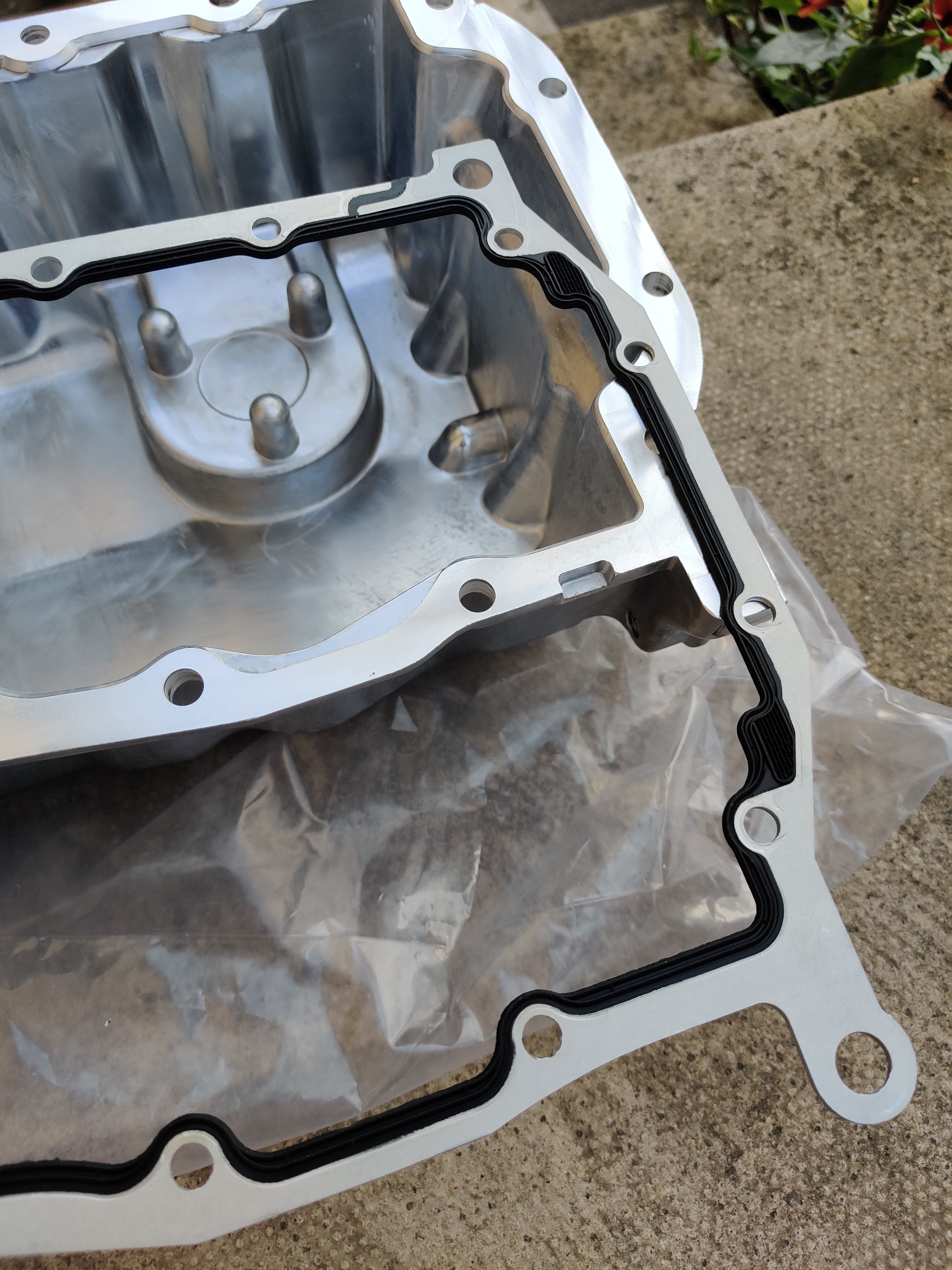

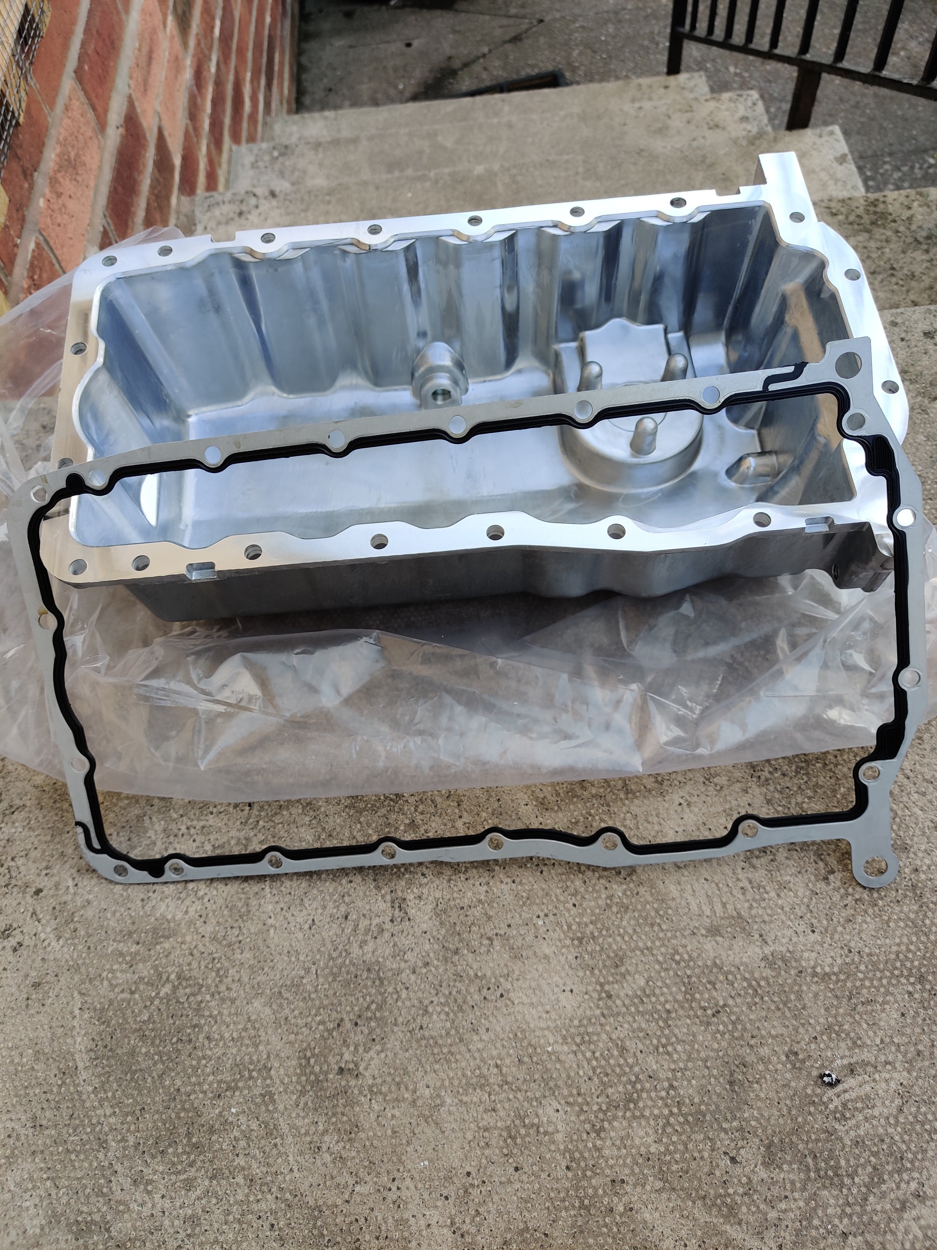

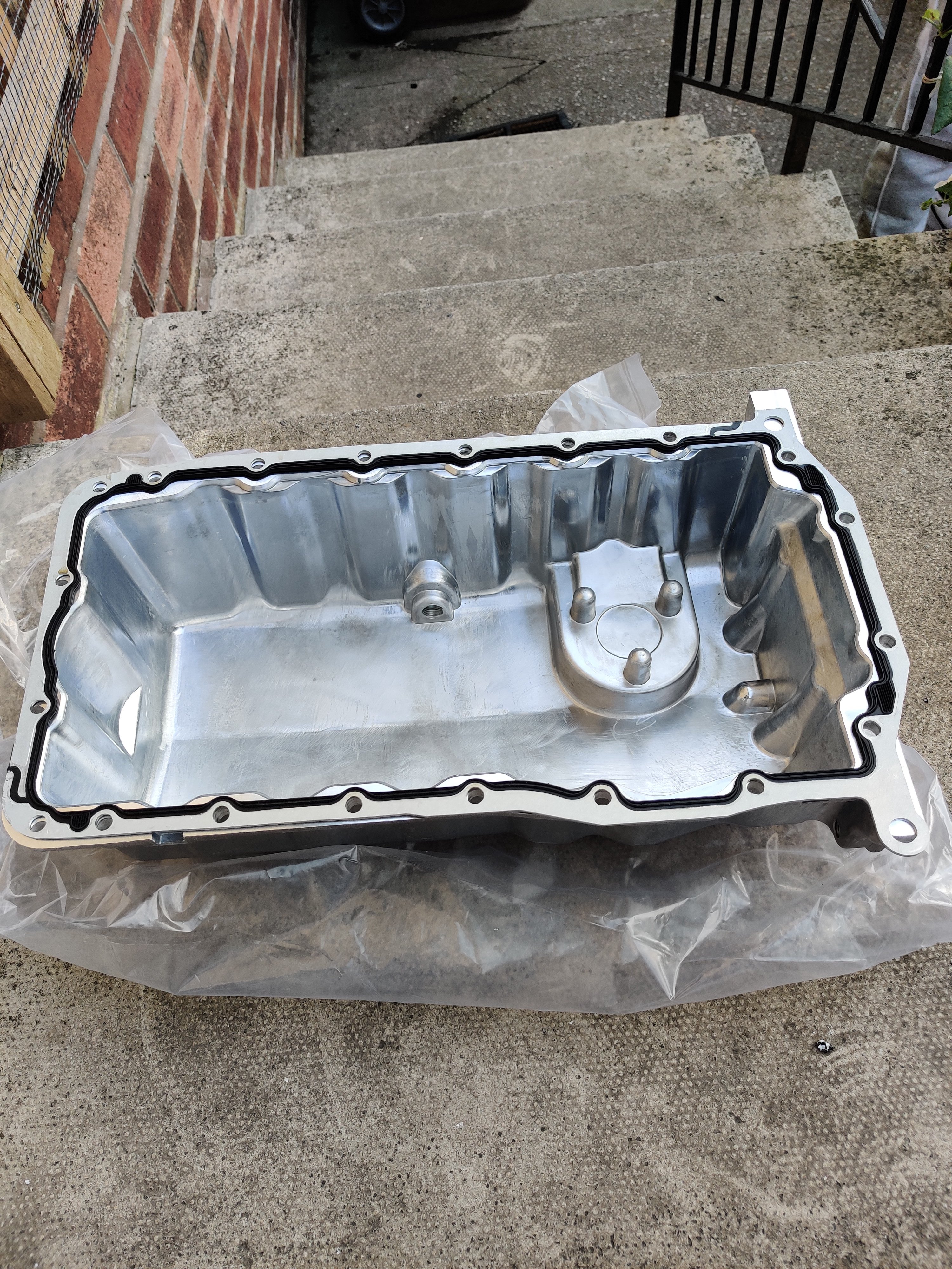

  4. That old chestnut again... stripped threads in drain hole. So, after getting fed up of Son's '54 Fabia vRS dribbling oil spots all over my hardstanding, we decided to buy a new sump. Got one off fleabay for 30 quid & it came complete with drain plug & gasket. What are your thoughts on the gasket? It seems to be made of an alloy, maybe aluminium with a integral rubber seal inset. The question is, would you use a liquid sealant as well. The rubber seal is hardly thicker than the metal gasket. Done some searching & it seems sump pans on this model didn't have a gasket but were sealed with liquid sealant from the factory. Your thoughts would be appreciated.
