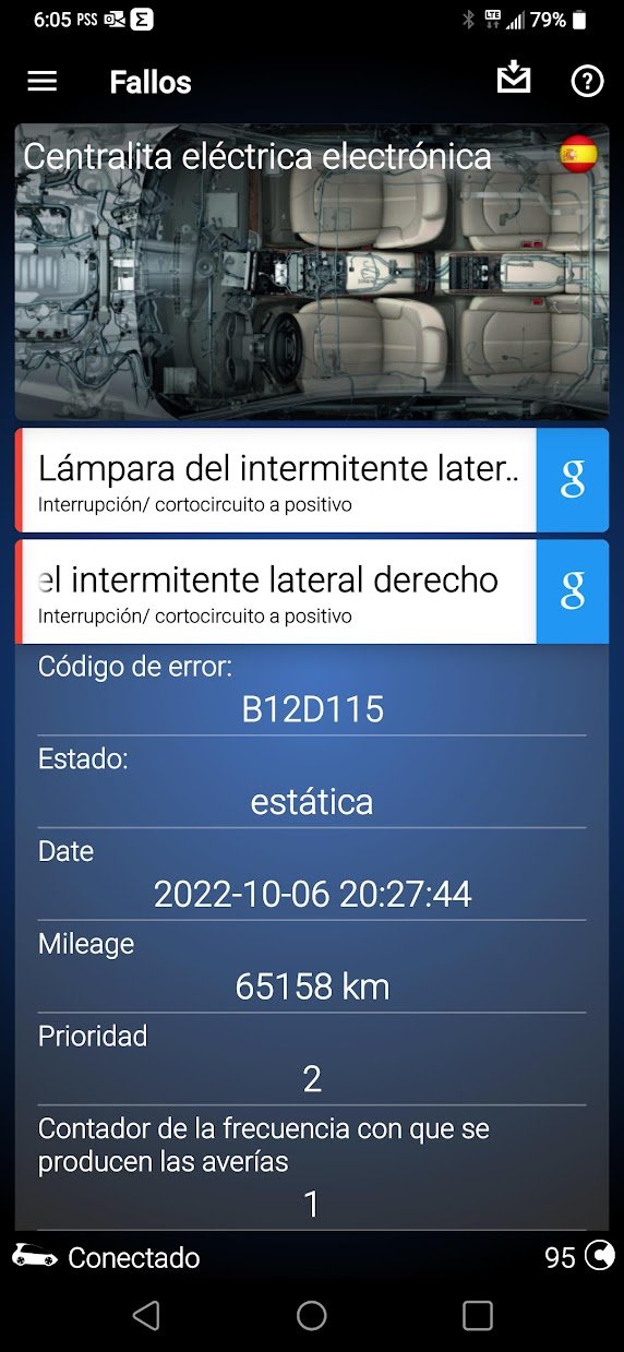

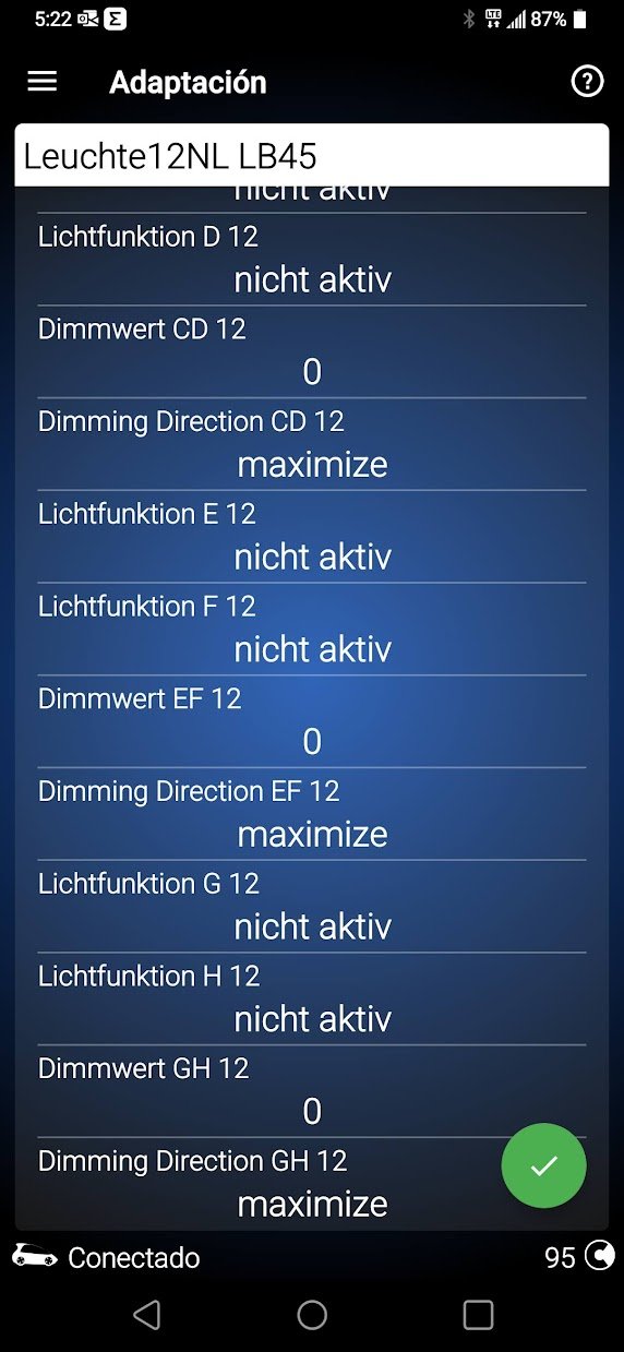

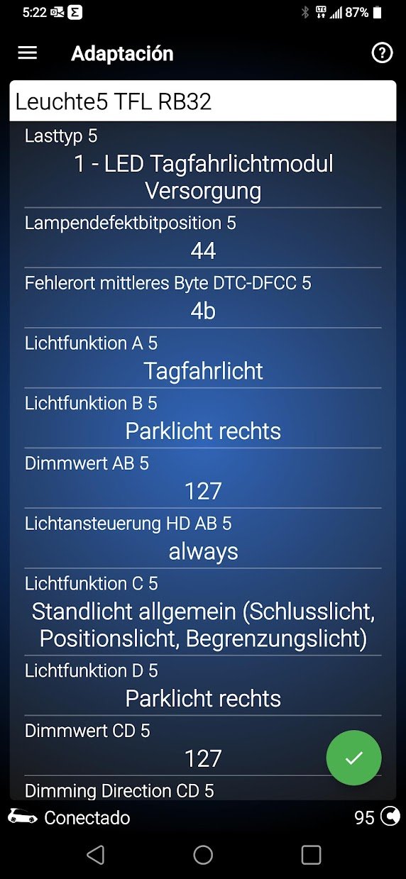

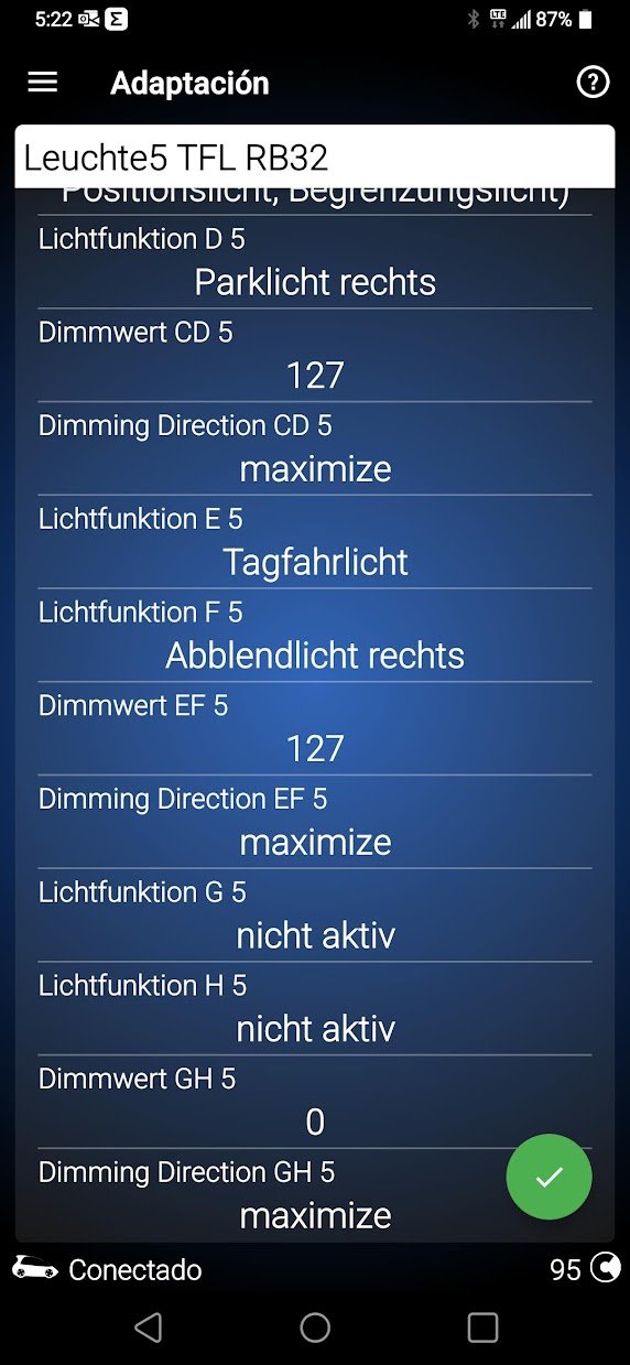

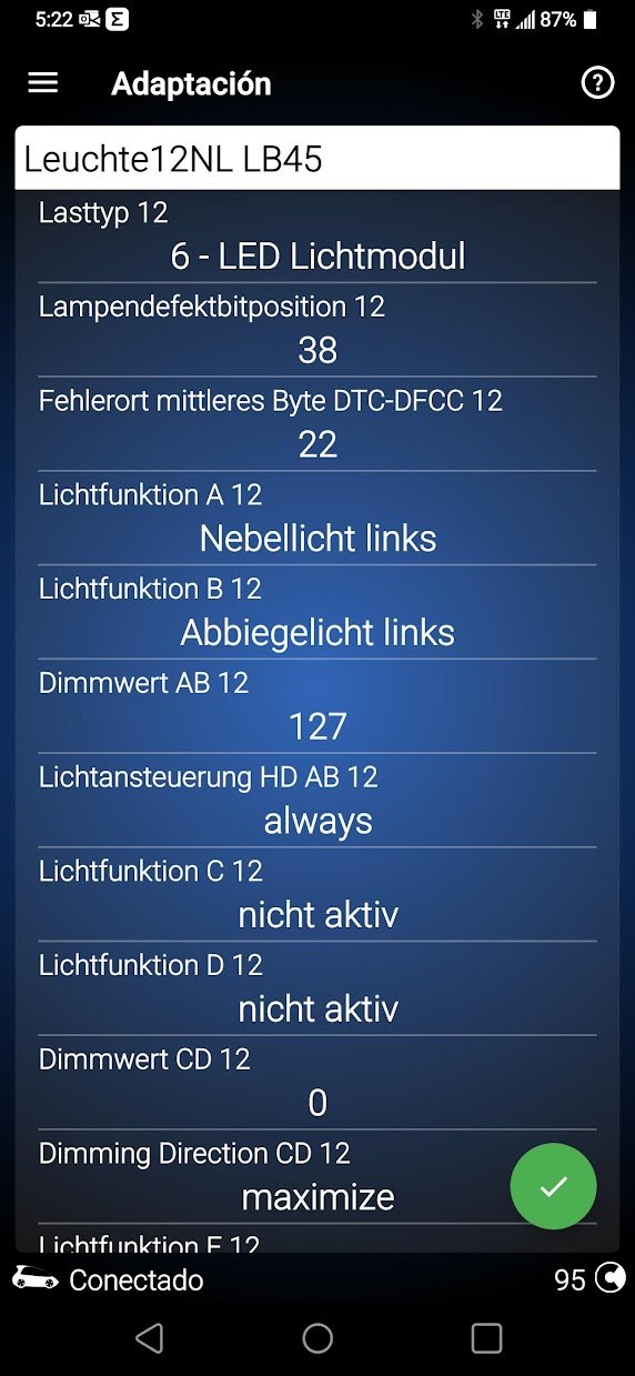

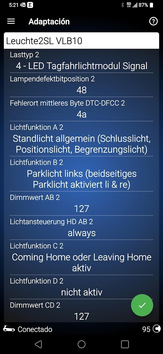

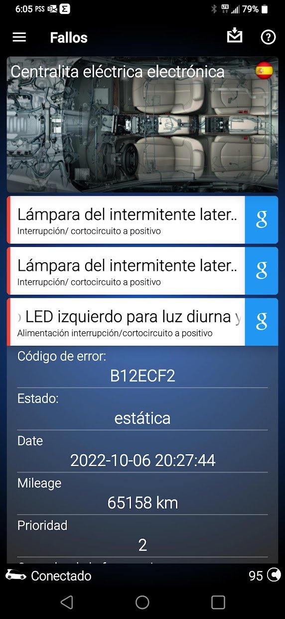

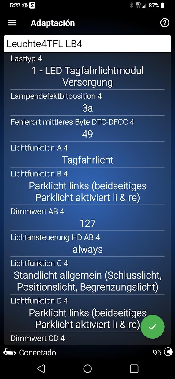

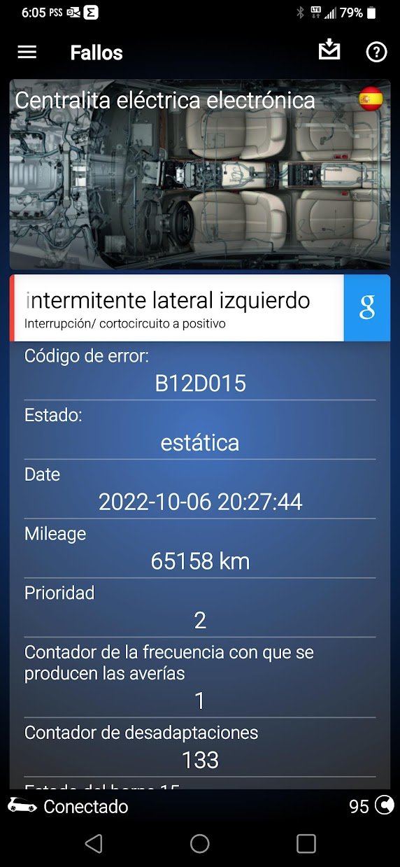

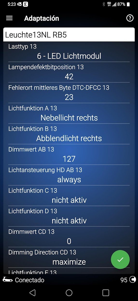

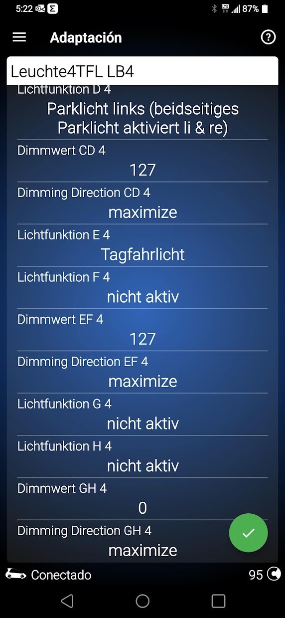

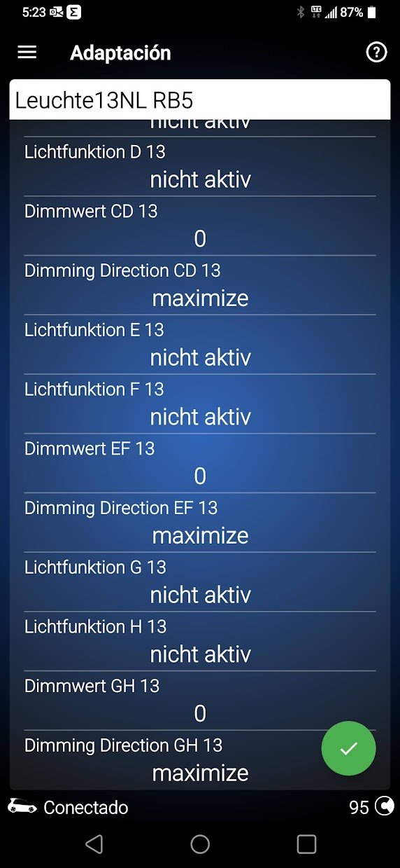

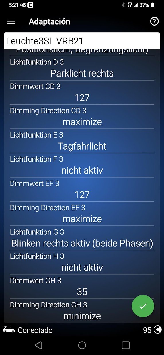

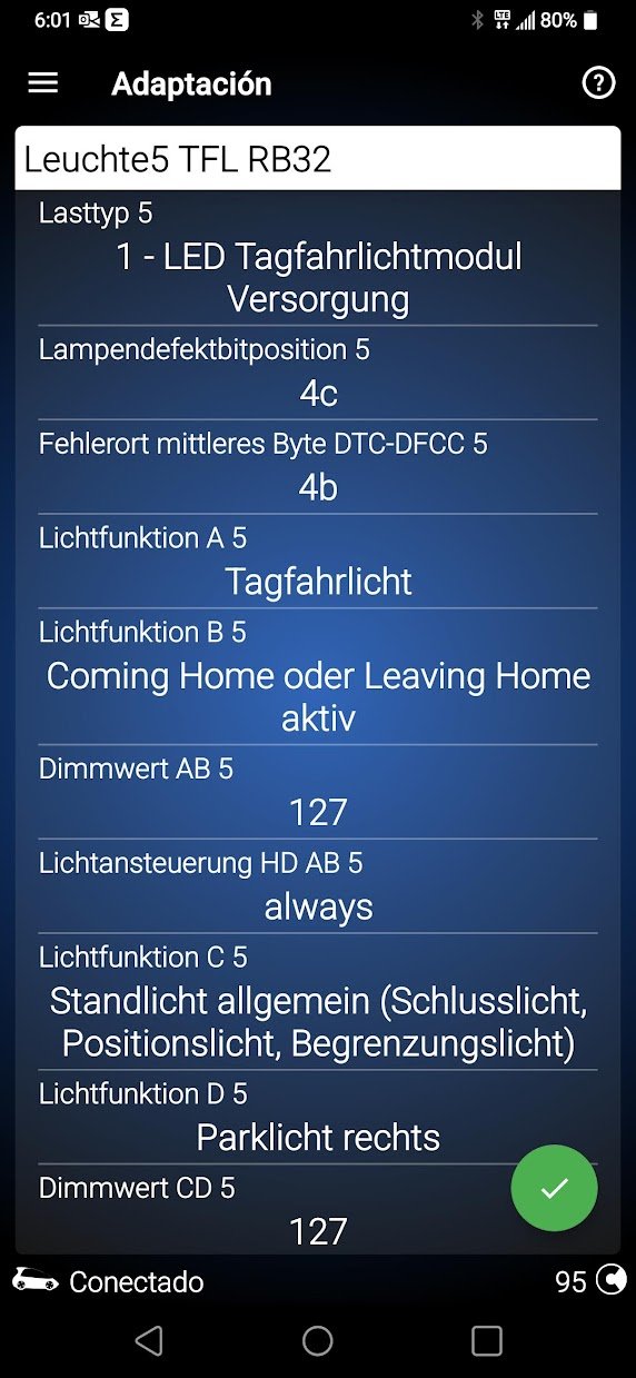

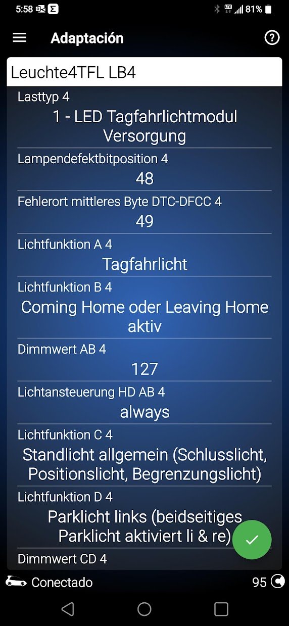

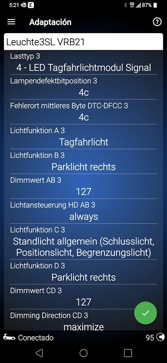

Hello everyone from Spain I'm really desperate with this issue,I have a octavia 1.4 tsi 2015 I did an upgrade to the headlights with led strip, but not from the basics, from the bixenon with bulb for DRL all the conversions i see are for basic headlights low and high beams work fine I have looked for codes but I have faults in the position lights (those with a bulb behind the chrome reflector) and the left led strip. I assume that the strip that does not turn on may be due to the daylight module that is cheap Chinese This is what they look like in my car these are my encodings for channels 2,3,4,5, These are the error codes that are displayed Can someone compare my coding with yours? Many thanks.- Change of bumper to RS and headlights to xenon-led
This is my config 7. LEFT FRONT SIDELIGHT (BI-XENON + PARKING LIGHT) (1)-Leuchte16BLK SLB35BLK SL KC9-Lasttyp 16 to 8 - allgemeine Glühlampe 12W (2)-Leuchte16BLK SLB35BLK SL KC9-Lampendefektbitposition 16 to 35 (3)-Leuchte16BLK SLB35BLK SL KC9-Fehlerort mittleres Byte DTC-DFCC 16 to 17 (4)-Leuchte16BLK SLB35BLK SL KC9-Lichtfunktion A 16 to Standlicht allgemein (Schlusslicht; Positionslicht; Begrenzungslicht) (5)-Leuchte16BLK SLB35BLK SL KC9-Lichtfunktion B 16 to Parklicht links (beidseitiges Parklicht aktiviert li & re) (6)-Leuchte16BLK SLB35BLK SL KC9-Dimmwert AB 16 to 100 8. RIGHT FRONT SIDELIGHT (BI-XENON + PARKING LIGHT) (1)-Leuchte17TFL R BLK SRB3TFL R BLK SR KC3-Lasttyp 17 to 8 - allgemeine Glühlampe 12W (2)-Leuchte17TFL R BLK SRB3TFL R BLK SR KC3-Lampendefektbitposition 17 to 3F (3)-Leuchte17TFL R BLK SRB3TFL R BLK SR KC3-Fehlerort mittleres Byte DTC-DFCC 17 to 19 (4)-Leuchte17TFL R BLK SRB3TFL R BLK SR KC3-Lichtfunktion A 17 to Standlicht allgemein (Schlusslicht; Positionslicht; Begrenzungslicht) (5)-Leuchte17TFL R BLK SRB3TFL R BLK SR KC3-Lichtfunktion B 17 to Parklicht rechts (6)-Leuchte17TFL R BLK SRB3TFL R BLK SR KC3-Dimmwert AB 17 to 100 9. LEFT LED DRL (+SIDELIGHT AND PARKING LIGHT) (1)-Leuchte2SL VLB10-Lasttyp 2 to 4 - LED Tagfahrlichtmodul Signal (2)-Leuchte2SL VLB10-Lampendefektbitposition 2 to 48 (3)-Leuchte2SL VLB10-Fehlerort mittleres Byte DTC-DFCC 2 to 4A (4)-Leuchte2SL VLB10-Lichtfunktion A 2 to Standlicht allgemein (Schlusslicht; Positionslicht; Begrenzungslicht) (5)-Leuchte2SL VLB10-Lichtfunktion B 2 to Parklicht links (beidseitiges Parklicht aktiviert li & re) (6)-Leuchte2SL VLB10-Dimmwert AB 2 to 35 (7)-Leuchte2SL VLB10-Lichtansteuerung HD AB 2 to Always (8)-Leuchte2SL VLB10-Lichtfunktion C 2 to Coming Home oder Leaving Home aktiv (9)-Leuchte2SL VLB10-Lichtfunktion D 2 to not active (10)-Leuchte2SL VLB10-Dimmwert CD 2 to 35 (11)-Leuchte2SL VLB10-Dimming Direction CD 2 to maximize (12)-Leuchte2SL VLB10-Lichtfunktion E 2 to Daytime running lights (13)-Leuchte2SL VLB10-Lichtfunktion F 2 to not active (14)-Leuchte2SL VLB10-Dimmwert EF 2 to 127 10. RIGHT LED DRL (+SIDELIGHT AND PARKING LIGHT) (1)-Leuchte3SL VRB21-Lasttyp 3 to 4 - LED Tagfahrlichtmodul Signal (2)-Leuchte3SL VRB21-Lampendefektbitposition 3 to 4C (3)-Leuchte3SL VRB21-Fehlerort mittleres Byte DTC-DFCC 3 to 4C (4)-Leuchte3SL VRB21-Lichtfunktion A 3 to Standlicht allgemein (Schlusslicht; Positionslicht; Begrenzungslicht) (5)-Leuchte3SL VRB21-Lichtfunktion B 3 to Parklicht rechts (6)-Leuchte3SL VRB21-Dimmwert AB 3 to 35 (7)-Leuchte3SL VRB21-Lichtansteuerung HD AB 3 to Always (8)-Leuchte3SL VRB21-Lichtfunktion C 3 to Coming Home oder Leaving Home aktiv (9)-Leuchte3SL VRB21-Lichtfunktion D 3 to not active (10)-Leuchte3SL VRB21-Dimmwert CD 3 to 35 (11)-Leuchte3SL VRB21-Dimming Direction CD 3 to maximize (12)-Leuchte3SL VRB21-Lichtfunktion E 3 to Daytime running lights (13)-Leuchte3SL VRB21-Lichtfunktion F 3 to not active (14)-Leuchte3SL VRB21-Dimmwert EF 3 to 127 11. LEFT DRL POWER (+SIDELIGHT AND PARKING LIGHT) (1)-Leuchte4TFL LB4-Lasttyp 4 to 1 - LED Tagfahrlichtmodul Versorgung (2)-Leuchte4TFL LB4-Lampendefektbitposition 4 to 3A (3)-Leuchte4TFL LB4-Fehlerort mittleres Byte DTC-DFCC 4 to 49 (4)-Leuchte4TFL LB4-Lichtfunktion A 4 to Standlicht allgemein (Schlusslicht; Positionslicht; Begrenzungslicht) (5)-Leuchte4TFL LB4-Lichtfunktion B 4 to Parklicht links (beidseitiges Parklicht aktiviert li & re) (6)-Leuchte4TFL LB4-Dimmwert AB 4 to 127 (7)-Leuchte4TFL LB4-Lichtansteuerung HD AB 4 to Always (8)-Leuchte4TFL LB4-Lichtfunktion C 4 to Coming Home oder Leaving Home aktiv (9)-Leuchte4TFL LB4-Lichtfunktion D 4 to not active (10)-Leuchte4TFL LB4-Dimmwert CD 4 to 127 (11)-Leuchte4TFL LB4-Dimming Direction CD 4 to maximize (12)-Leuchte4TFL LB4-Lichtfunktion E 4 to Daytime running lights (13)-Leuchte4TFL LB4-Lichtfunktion F 4 to not active (14)-Leuchte4TFL LB4-Dimmwert EF 4 to 127 12. RIGHT DRL POWER (+SIDELIGHT AND PARKING LIGHT) (1)-Leuchte5 TFL RB32-Lasttyp 5 to 1 - LED Tagfahrlichtmodul Versorgung (2)-Leuchte5 TFL RB32-Lampendefektbitposition 5 to 44 (3)-Leuchte5 TFL RB32-Fehlerort mittleres Byte DTC-DFCC 5 to 4B (4)-Leuchte5 TFL RB32-Lichtfunktion A 5 to Standlicht allgemein (Schlusslicht; Positionslicht; Begrenzungslicht) (5)-Leuchte5 TFL RB32-Lichtfunktion B 5 to Parklicht rechts (6)-Leuchte5 TFL RB32-Dimmwert AB 5 to 127 (7)-Leuchte5 TFL RB32-Lichtansteuerung HD AB 5 to Always (8)-Leuchte5 TFL RB32-Lichtfunktion C 5 to Coming Home oder Leaving Home aktiv (9)-Leuchte5 TFL RB32-Lichtfunktion D 5 to not active (10)-Leuchte5 TFL RB32-Dimmwert CD 5 to 127 (11)-Leuchte5 TFL RB32-Dimming Direction CD 5 to maximize (12)-Leuchte5 TFL RB32-Lichtfunktion E 5 to Daytime running lights (13)-Leuchte5 TFL RB32-Lichtfunktion F 5 to not active (14)-Leuchte5 TFL RB32-Dimmwert EF 5 to 127- Change of bumper to RS and headlights to xenon-led

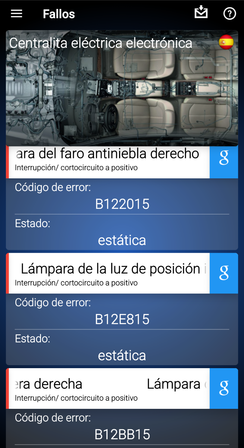

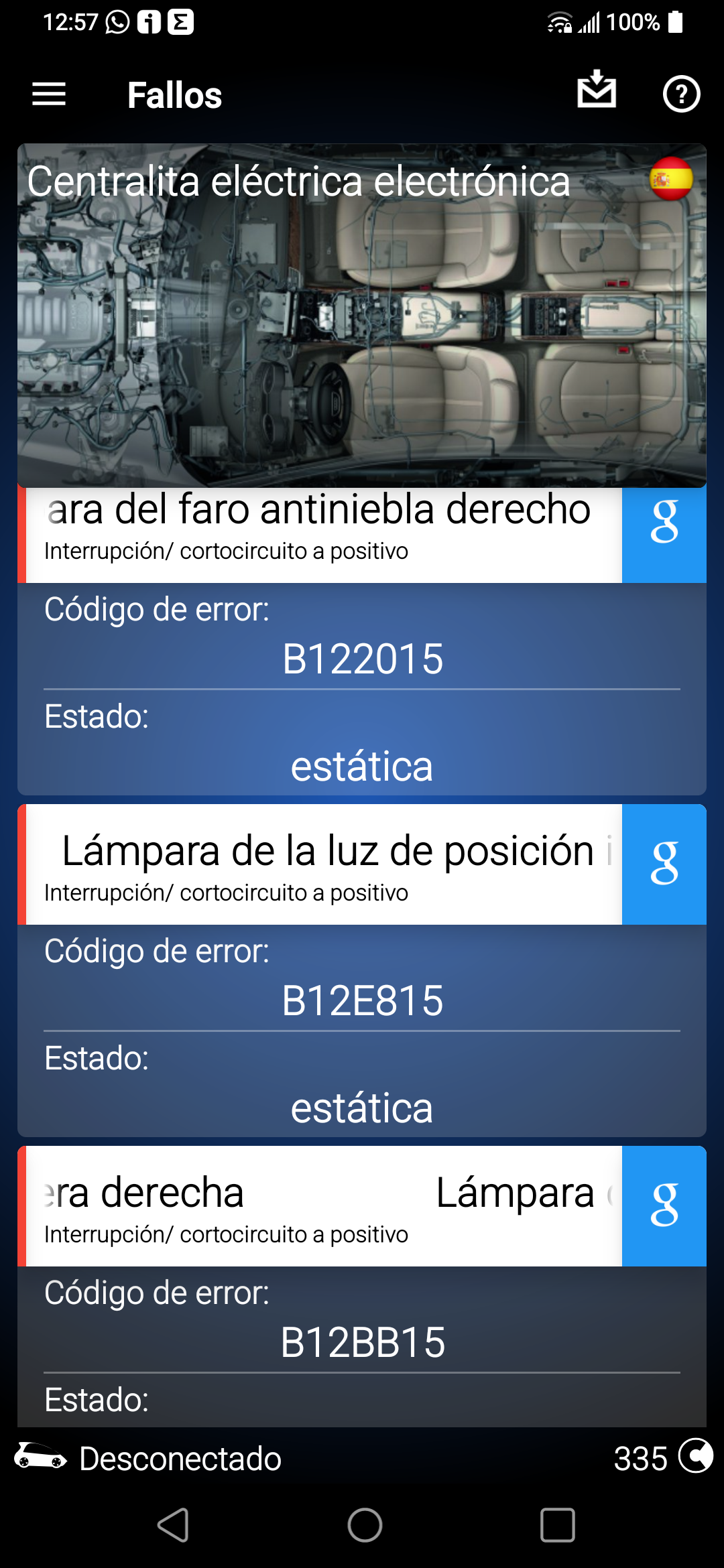

headlamp leveling and headlamp washer works fine, what doesn't work is the position bulb and the led strips. I also put the rs model wiring harness on the fog lights and only the left side works. These are the error codes I have- Change of bumper to RS and headlights to xenon-led
Hello everyone, I have changed my bixenon headlights to the model with the led strip, now the led strip does not work, neither does the position bulb the short and long lights if they work, headlight leveling and headlight washers. I think it will be encoding problem. Does anyone have information for the correct codes by obdleven? Best regards - HEADLIGHT UPGRADE AND BUMPER REPLACEMENT
