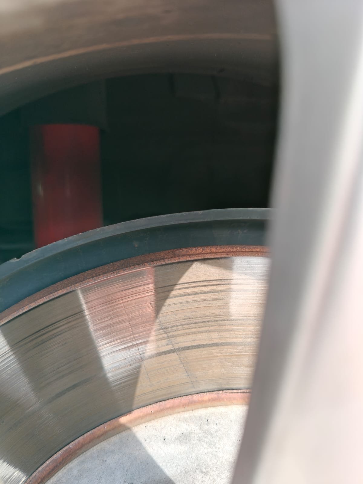

  1. Hello again. When I checked the rear discs and pads (which still have the ATE ceramic pads), I noticed they were cracked, with perpendicular cracks. I also noticed that the vibration when braking comes from the pedal and the floor, so I think the rear pads have also eaten away the original discs. I've already ordered replacements with ATE discs and TRW pads. I don't know why I still trust ATE after such a mess. Maybe I should have used TRW discs and pads. @Carlston

  6. On a Skoda Superb mk3 4x4. I had the brilliant idea of installing Ate ceramic front pads. After a few thousand miles, it started vibrating. I thought it would go away with the mileage, but it didn't. In the meantime, I also installed Ate ceramic rear pads. Since the vibrations were really annoying, I changed the discs and pads, installing highly carbonized Ate discs and TRW pads, keeping the stock discs and Ate ceramic rear pads. Well, just like last time, after 2-3 thousand miles, the vibrations started again. I don't know what it could be or what to change. Thank you very much.

  8. I DO NOT recommend the ATE Ceramic front pads. They've eaten away at the discs in just 20,000 km, and they vibrate a lot when braking. Furthermore, the pads have barely worn down over those 20,000 km, so all they do is not stain the rim. I'm going to switch to OEM.
