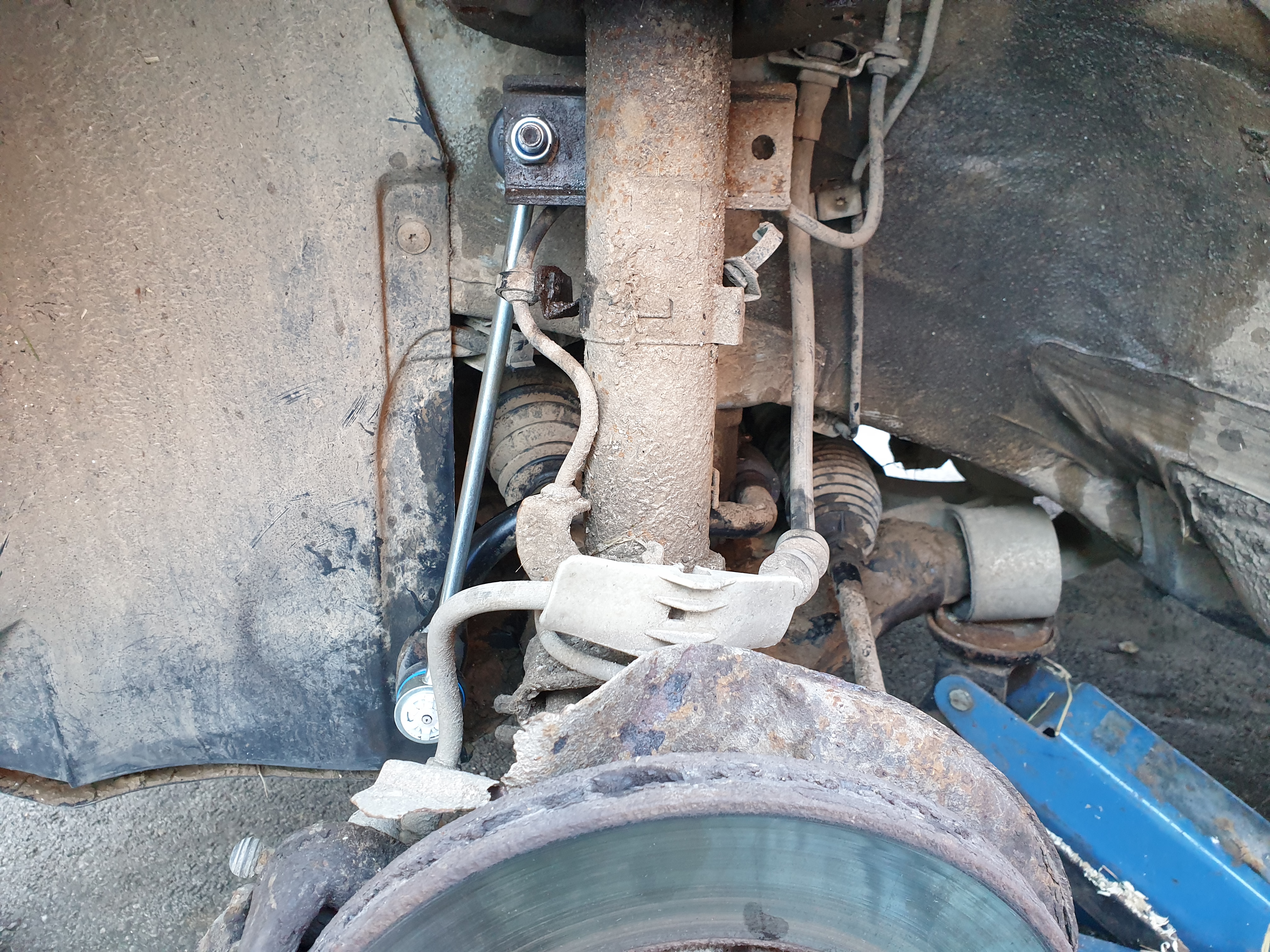

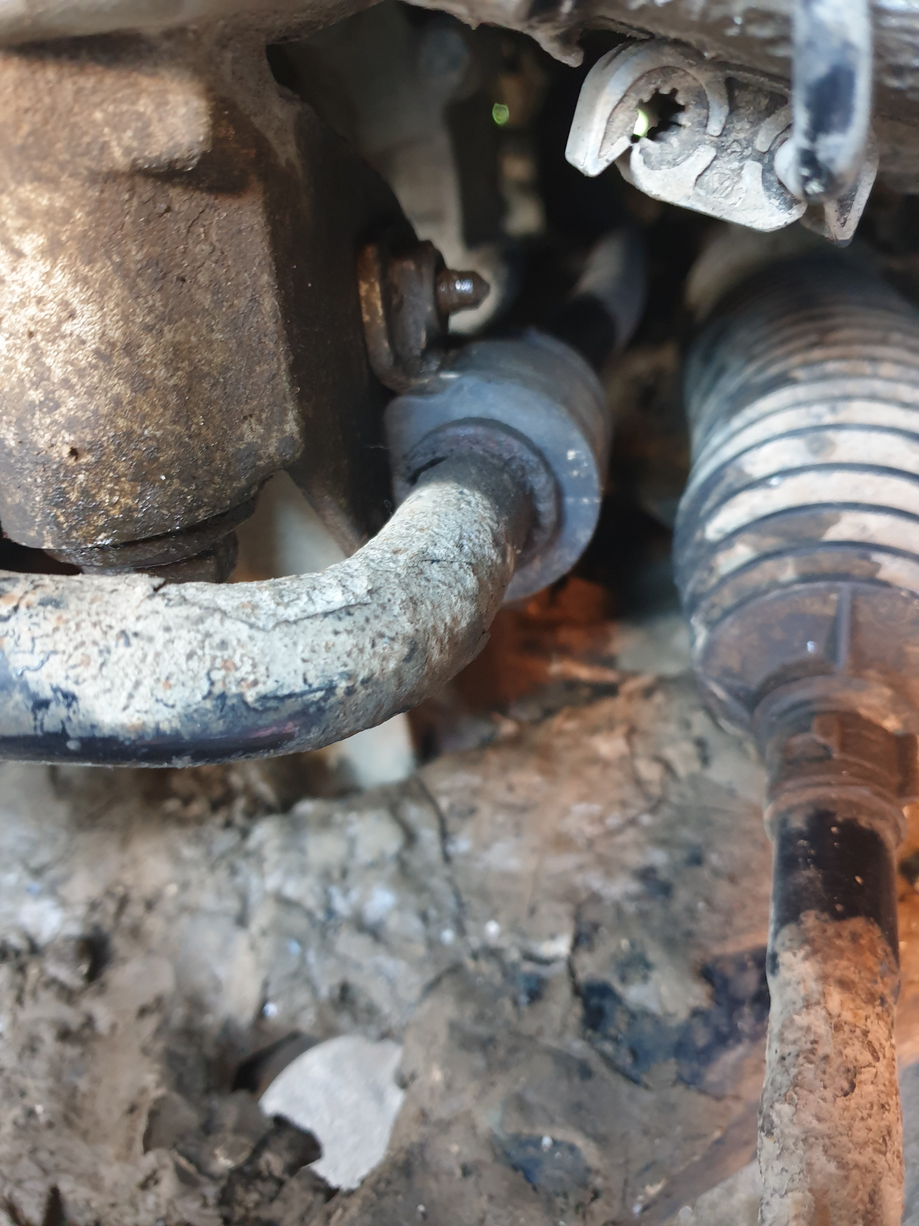

My fabia passed its mot but macanic said that my drop links had play and needed changing , I ordered a pair of meyle drop links n started fitting them this morning only to find out it was the bush on the role bar its self not the links that was shot , luckily our local moto factors had a pair in and only £5.50 a pair i fitted the new links to ,- Recent pics of your fabia for no reason, just stick em up!
