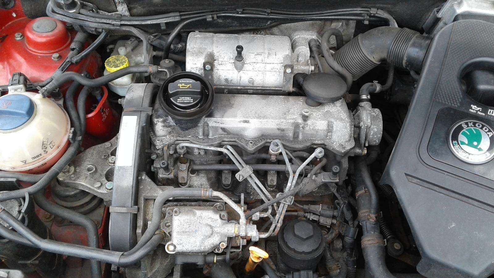

I've looked at those pictures literally, minimum, 10 times in the last 7 days and watched many videos that I could find. I think that those pictures are relevant in the MK2+ models, but not in the MK1's. As I've said, I cannot see the lump from the engine bay because I think that there isn't one. Also, I would have tried to find the problematic lump, but as I've said, I have the intake manifold in front of the insulation which makes it difficult. It's the 1.9 SDi and the intake manifold is very big. I supplied the picture of the engine bay I found online for illustration. There isn't enough space to even reach the insulation with palm of my hand. About the condensation evaporating part - I really don't know, I know that as long as I remember I had the wet spot below the car after AC was running and now there is nothing there, not even after parking the car.

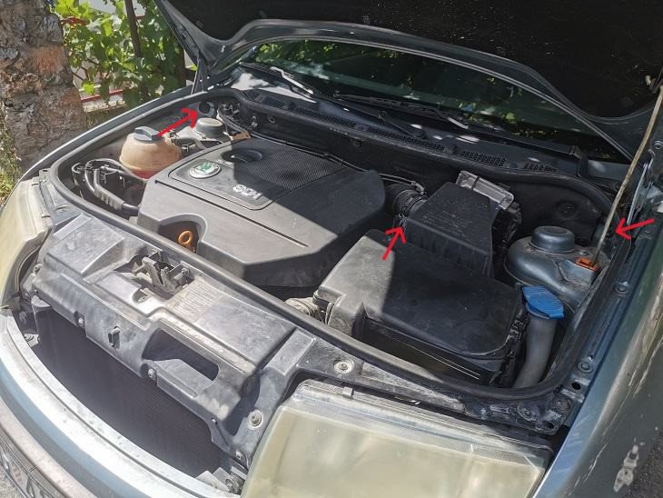

Need a part number for under the hood grommet/bung.
Hello fellow Škoda owners! The thing I need is actually quite easy, only I don't have the parts numbers. I supplied the picture (found online) with pointing arrows for easier explanation. Those two rubber grommets in the corners of the engine bay and a clamp/clip for what is, I presume, air temperature sensor (I just want to make sure that I order the right clamp because I see many similar online). If not evident, the car is Fabia Mk1 1.9SDi. Cheers.
