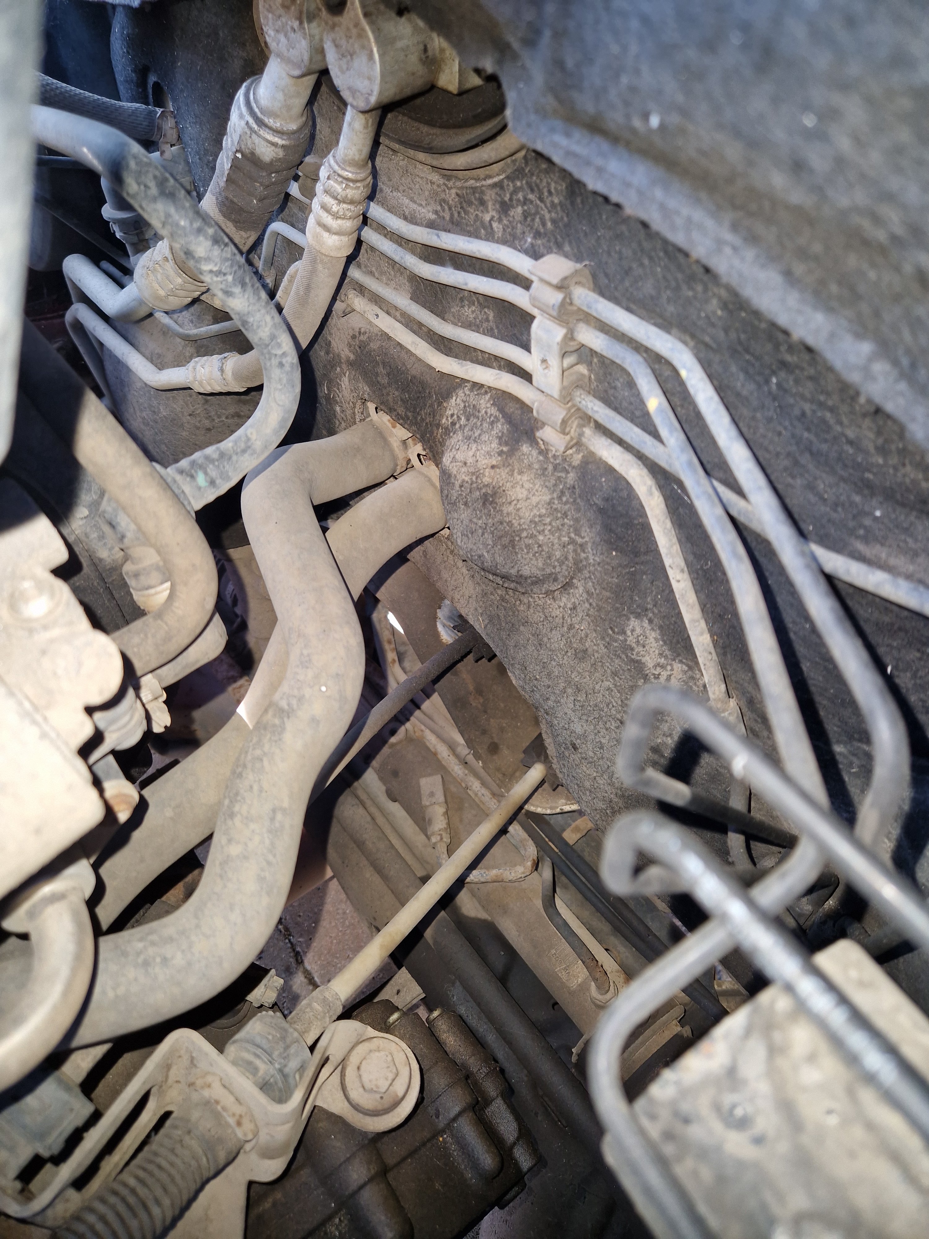

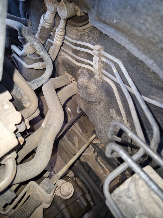

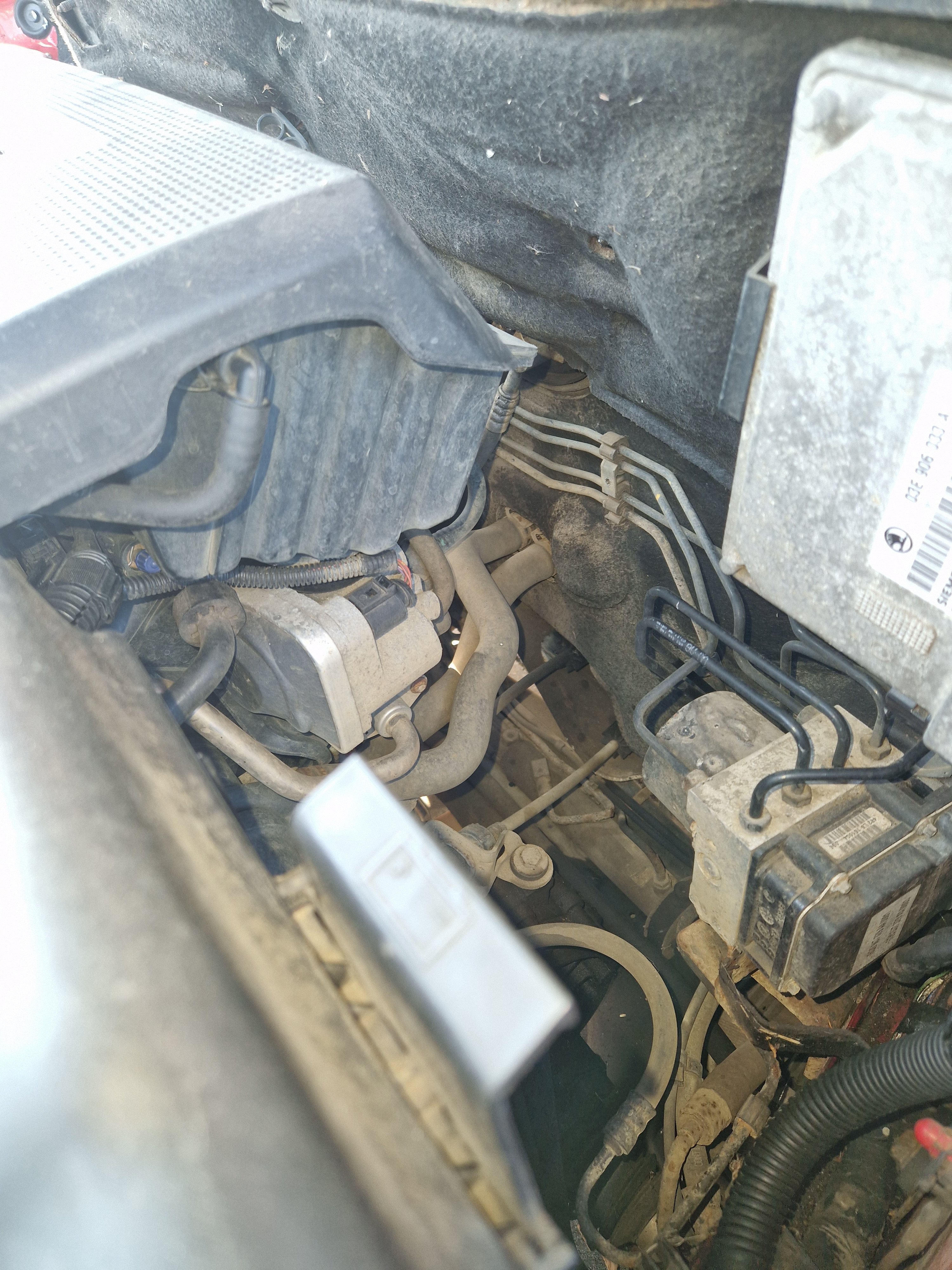

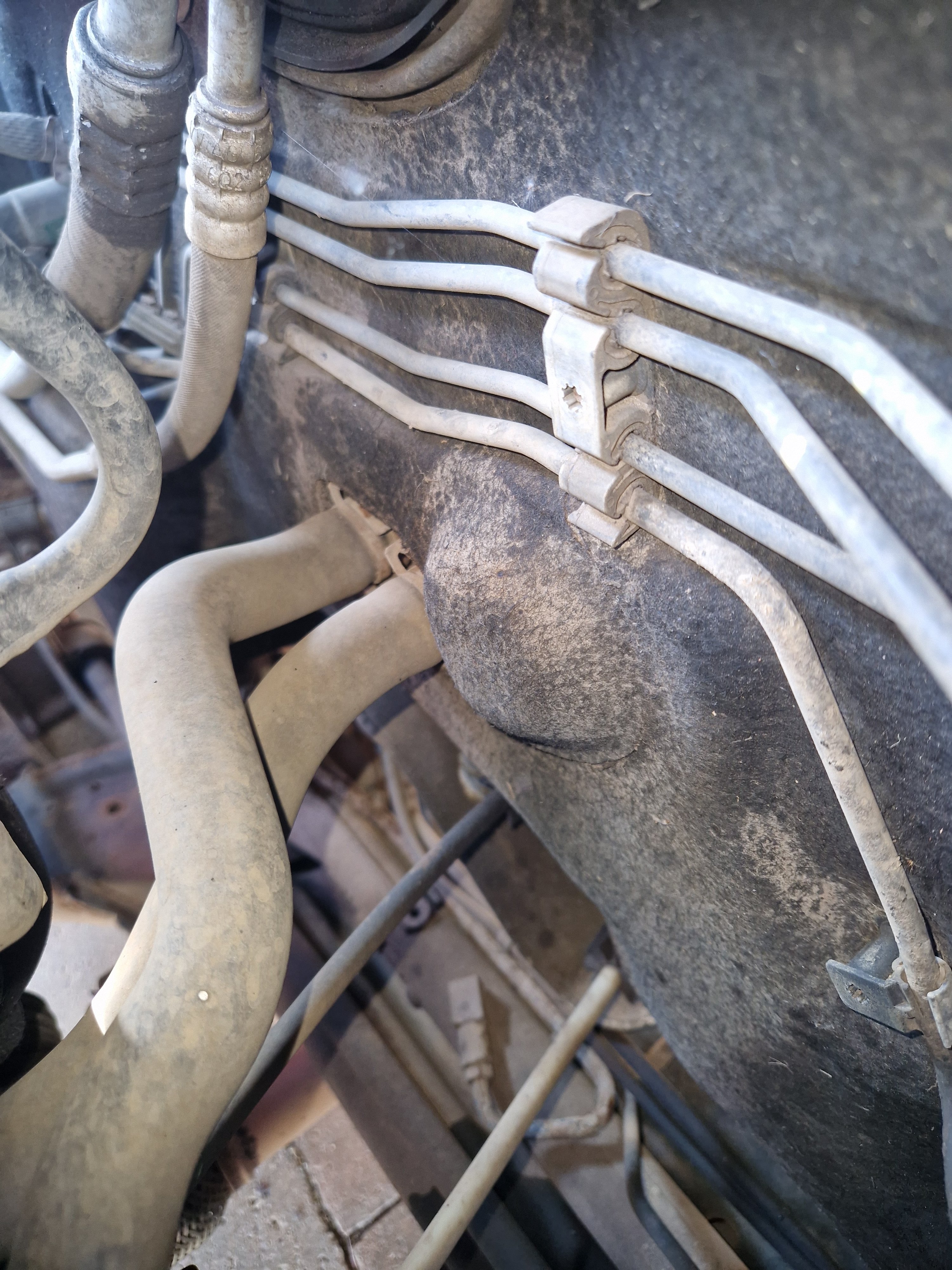

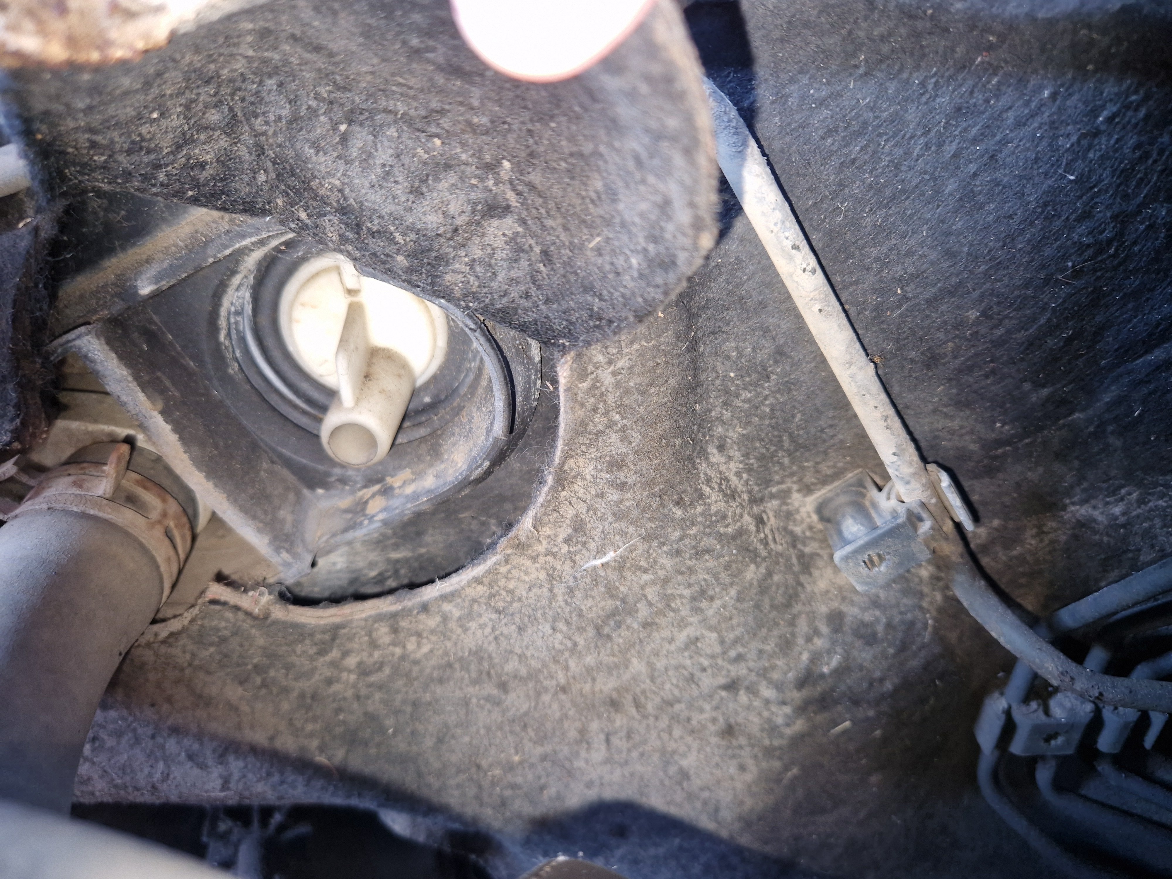

There is no hose, just a short plastic tube coming straight out of the bottom of the evaporator housing. It can be found under a flap of soundproofing, in the engine bay. You'll see that there's a lump in the sound insulation next to the two heater matrix hoses, tear or cut that material and you can see it.
The lack of dripping condensation may simply be because the sound insulation which the pipe drips onto is providing a good evaporating surface in hot weather.

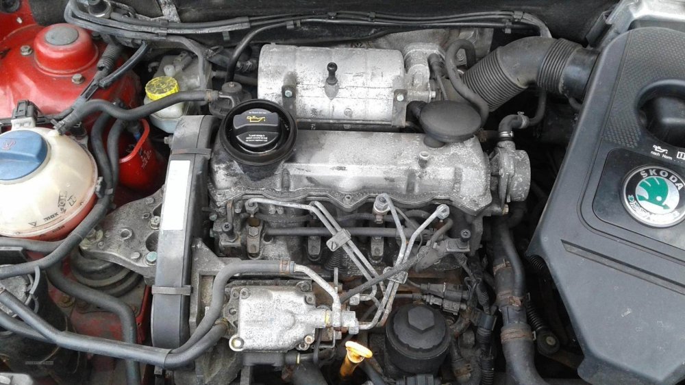

I've looked at those pictures literally, minimum, 10 times in the last 7 days and watched many videos that I could find. I think that those pictures are relevant in the MK2+ models, but not in the MK1's. As I've said, I cannot see the lump from the engine bay because I think that there isn't one. Also, I would have tried to find the problematic lump, but as I've said, I have the intake manifold in front of the insulation which makes it difficult. It's the 1.9 SDi and the intake manifold is very big. I supplied the picture of the engine bay I found online for illustration. There isn't enough space to even reach the insulation with palm of my hand.

I'll take some photos on my mk1 after breakfast. It is exactly as shown, but mine's RHD, so mirrored.
Access from below may be best option if you can't reach from above.
It almost certainly isn't the problem with your A/C though.
There are many other more likely problems.

Anyway, here are some photos.
Edited by Breezy_Pete
Spelling
Thank you mate! You don't know how much this helped me.
I tried to find this lump from below the car but couldn't do it to save my life. Definitely I need to remove the air filter housing first and then try cleaning the drain. If not possible from the engine bay will try again from below the car. This will be the first thing I do on the weekend. I think that the evaporator has never been cleaned from the inside.
