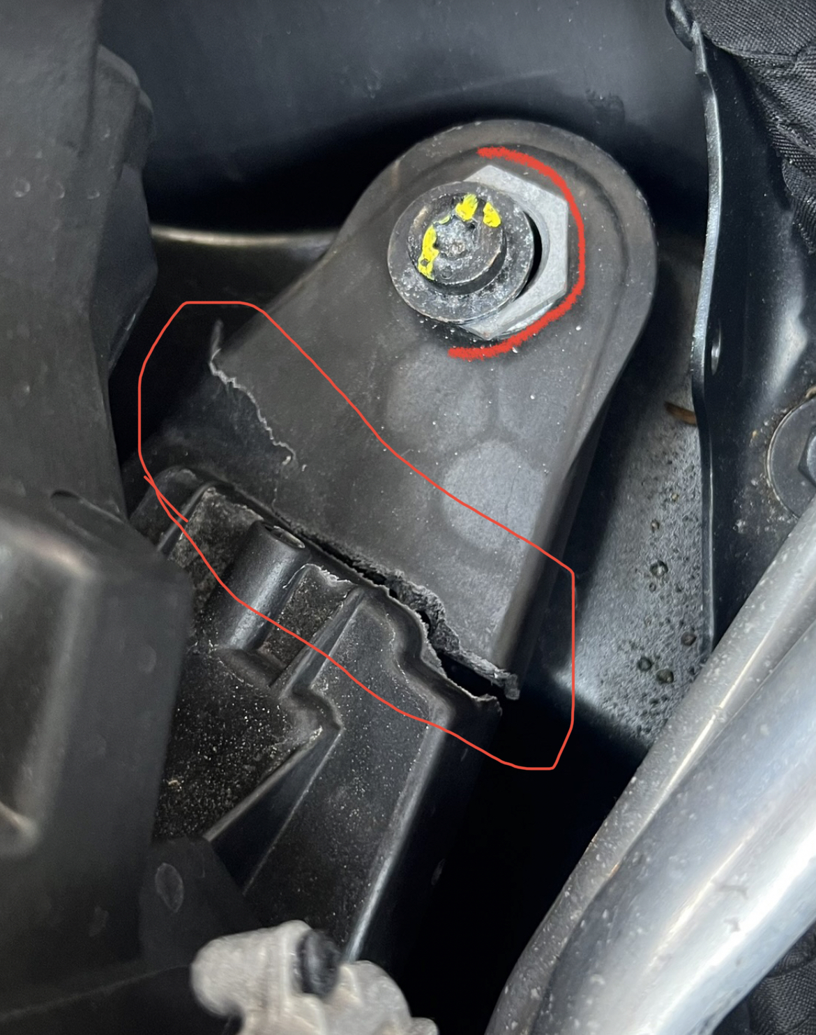

That is another option. I will definitely look in to it too. Thank you. Saying so, I’m leaning towards the genuine part what Langers2k showed me. I’m able to speak czech language and found few headlights with same issue in Czech Republic and people fixed those with the genuine parts and it seems to be working

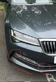

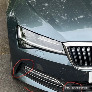

Also the plastic trim is not clicked in properly on the bottom so someone hit something. The brackets are made of chocolate then!- Driver side led headlight bracket mounting is snapped
Sorry, there is one hairy scratch on side of the wing and the lower bit of the front bumper seems to take some hit too. There is deep scratch on the bottom of the bumper which I can’t see on pictures from dealer.- Driver side led headlight bracket mounting is snapped
I can’t see that. There is light scratch on side of the bummer. So the bracket was broken already when dealer took the car in and they have missed it on inspection or something happened between the dealership or on the way back from service. I have seen video from service by the dealer and you can’t really say if there was any damage because the way how they done the video. Since the service the car done only 9 miles till I picked up. My garage guy looked at it yesterday and he said it definitely had light impact but he couldn’t say if the wing was changed coz it doesn’t look like. I’m not happy to say the least. My stupidity to trust Stoneacre in first place. I will definitely look in to the bracket repair kit tho. I just hope the additional bracket are in one piece coz I have long drive front of me before I will be able to take off the bumper and look at it properly. Btw does anyone know how difficult is to take off the bumper please. Thank you all.- Driver side led headlight bracket mounting is snapped

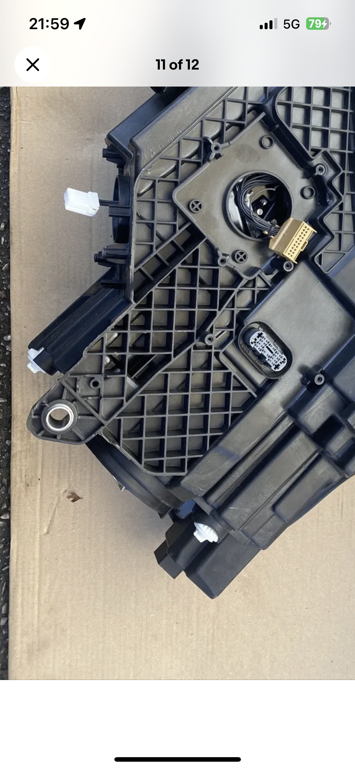

Well I have found some used damaged headlight on eBay and looking at the pictures of the headlight it seems like one part. I can’t see any screws for the bracket on the light- Driver side led headlight bracket mounting is snapped

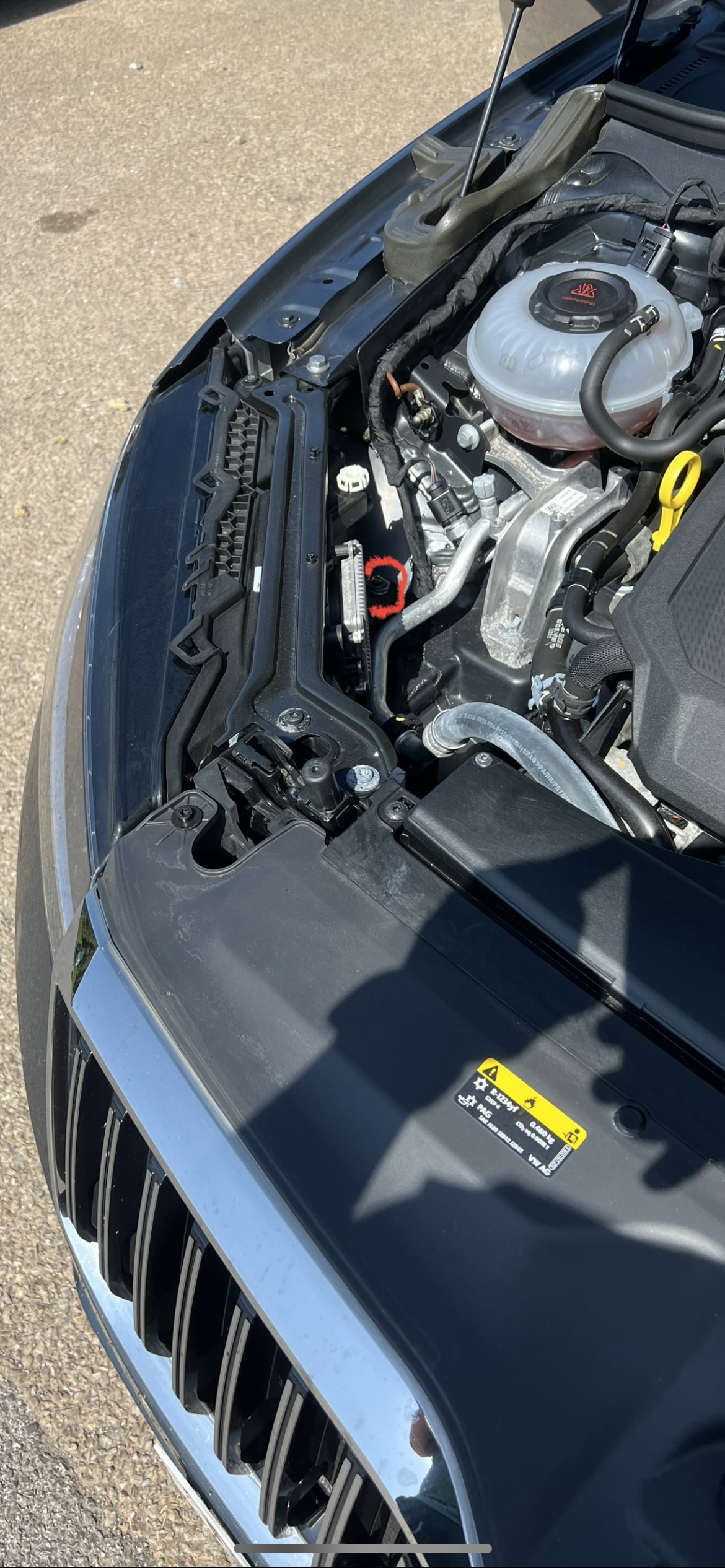

Hello helpful people. I bought recently Skoda Superb MK3 FL 2019 with led headlights and recently noticed that one of the mounting bracket is snapped. I have contacted dealer about it but they are washing their hands off and don’t want to fix it or hear anything about it because I should check the car before collecting. They are basically saying I have done it. I drove the car for about 300 miles and never hit anything. I Never checked the engine bay to be honest because the headlight is working and doesn’t seems to have even scratch on. Car has 12k on the clock. I bought the car for cash and it was long time saving. I paid £22k for the car not even 2 weeks ago just to be told that I need new headlight because the bracket is part of the unit. It could cost me up to £1k to fix that. Is there another way how to deal with it please. Thank you for any help in advance - Driver side led headlight bracket mounting is snapped
