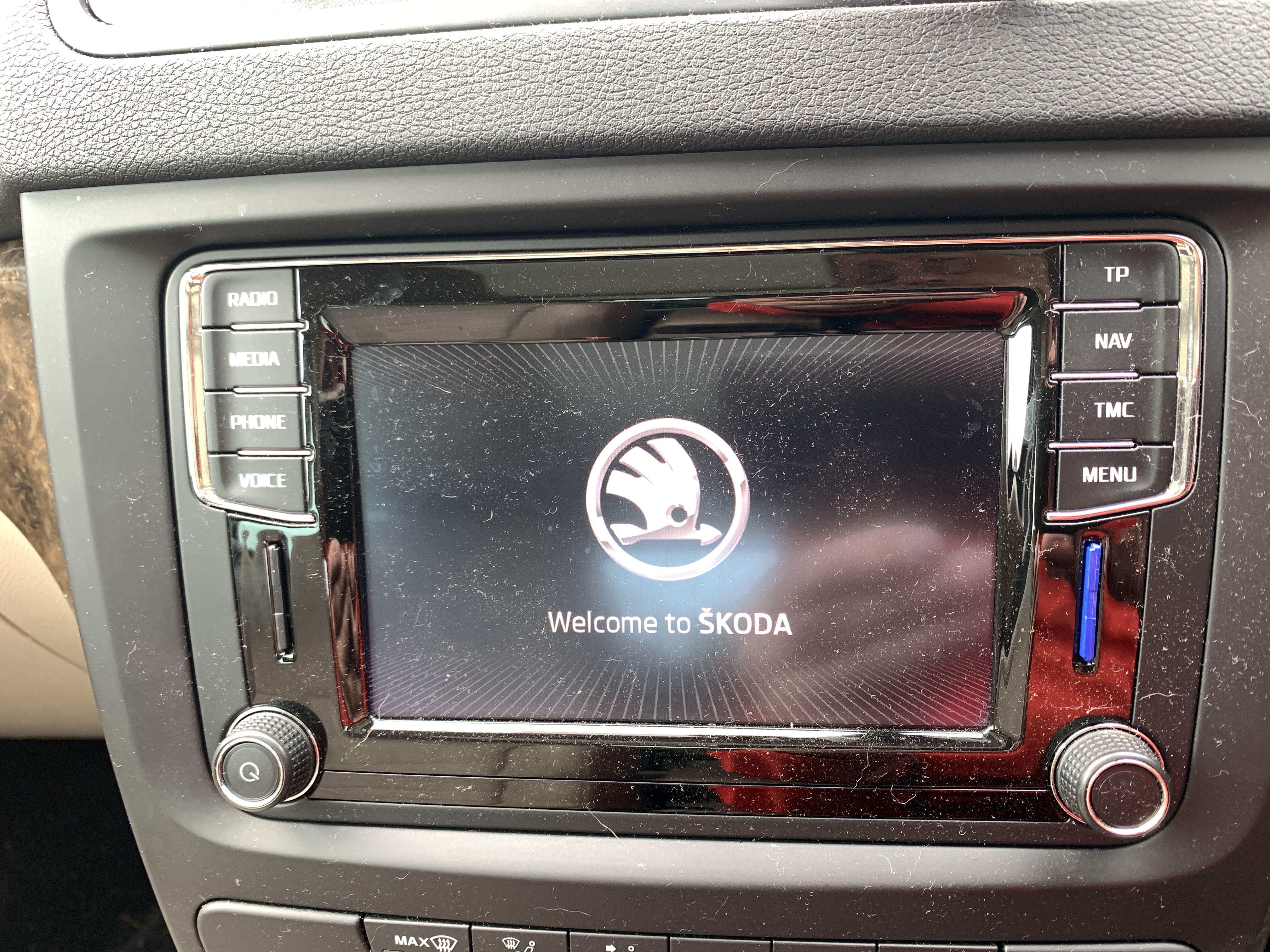

  6. My Amundsen sat nav/radio/information centre recently failed, just repeatedly turning on and off every few seconds. I posted a query here and @pab567 suggested some ideas about repairing it. He explained how to remove the unit and send it to him in Poland. I did so and was very pleased that he was able to repair it, at a reasonable price, and sort out the customs forms needed when sending from the UK. I wish to publicly thank @pab567 and recommend his work, which saved me a great deal of money had I gone to my main dealer.
  7. Sorry, I should have added a picture. This is what the Amundsen looks like. Cheers, Marc
