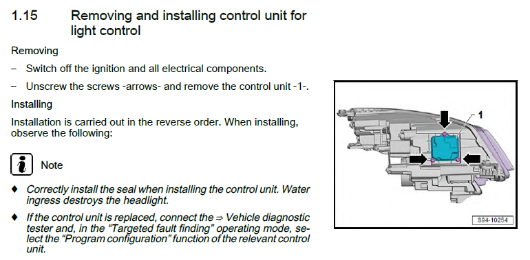

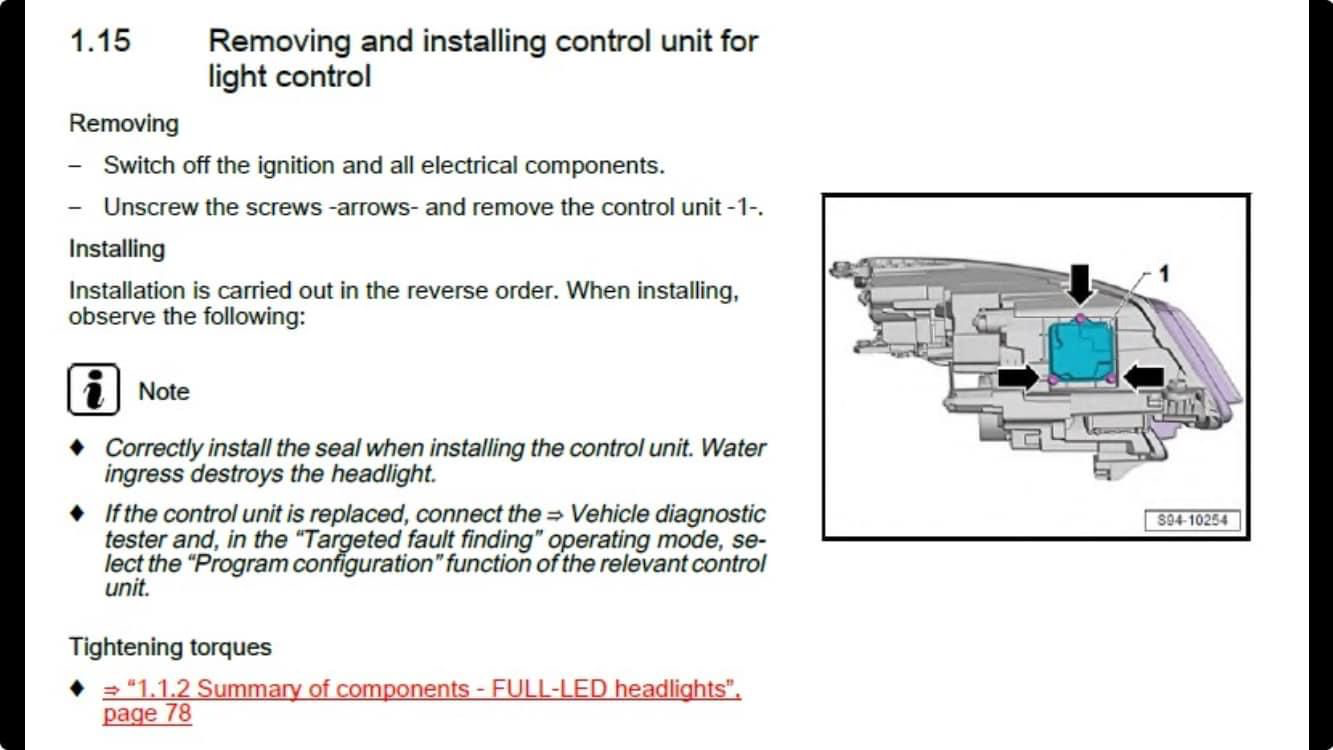

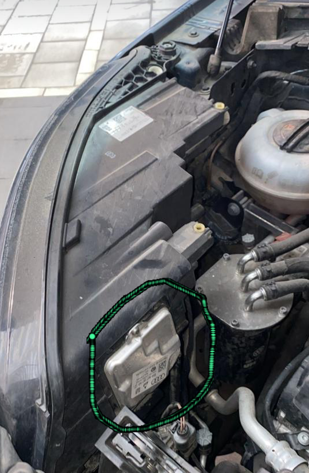

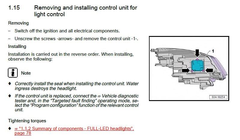

  5. I changed my control unit in my 2017 Kodiaq as shown in the picture. My colleague and I are trying to figure out how to program it with a diagnostic tool. He has both VCSD and VAG CAN Pro. Can someone please explain which program will be able to do the program configuration? Can the process for the reset be explained in detail, the other places we saw instruction didn't work. Many Thanks
  6. I got the new control unit, the physical installation seems fairly straight forward, from what I see I'm supposed to disconnect the battery? Can any ODB tester do the reset of the control unit.

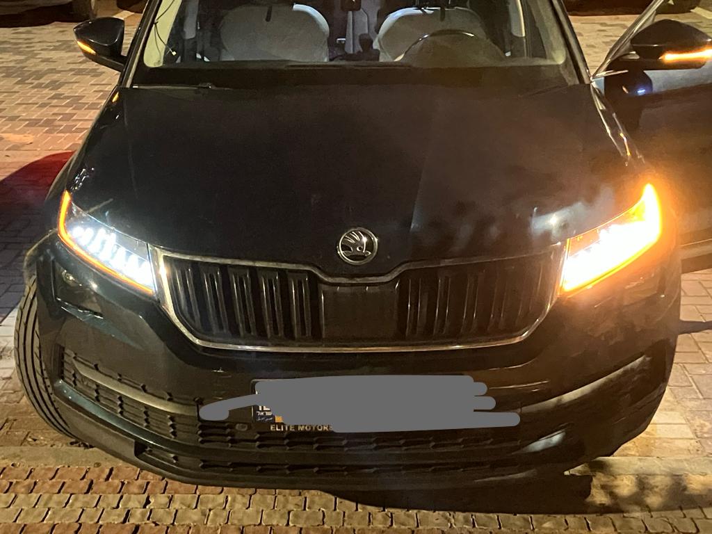

  8. I entered my car information here - https://www.autodoc.co.uk/car-parts/headlight-insert-10533/skoda/kodiaq/kodiaq-ns7/123934-2-0-tdi?criteria[574][]=000&criteria[100][]=R But I see that it was without the VIN - TMBJJ9NS6H8029984 Is this a replaceable part on mine as well? I'm beginning to think it's the problem with the LED tube, since it works, but is rather weak.
  9. TMBJJ9NS6H8029984 I'm beginning to think the issue may just be the LED controller, where would I be able to get the parts separately. Because other systems are suggesting that my Kodiaq is so old that the parts are different from the rest of the 2017 models. Cheers.
  10. When I entered my chassis number the E part was supposed to fit. :-(
  11. I went to have the assembly installed and they wouldn't do it, because the metal box that is attached to the assembly shown in the attached picture wasn't on the lamp. Does this make sense? The issue on the lamp is that the LED strip barely works. And at the same time part of it broke during shipping.
