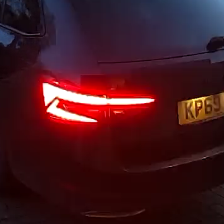

  3. My 2020 FL has matrix led as standard and the rear lights have animation when the car unlocks and they extend into the boot portion of the car. Photo attached for reference.

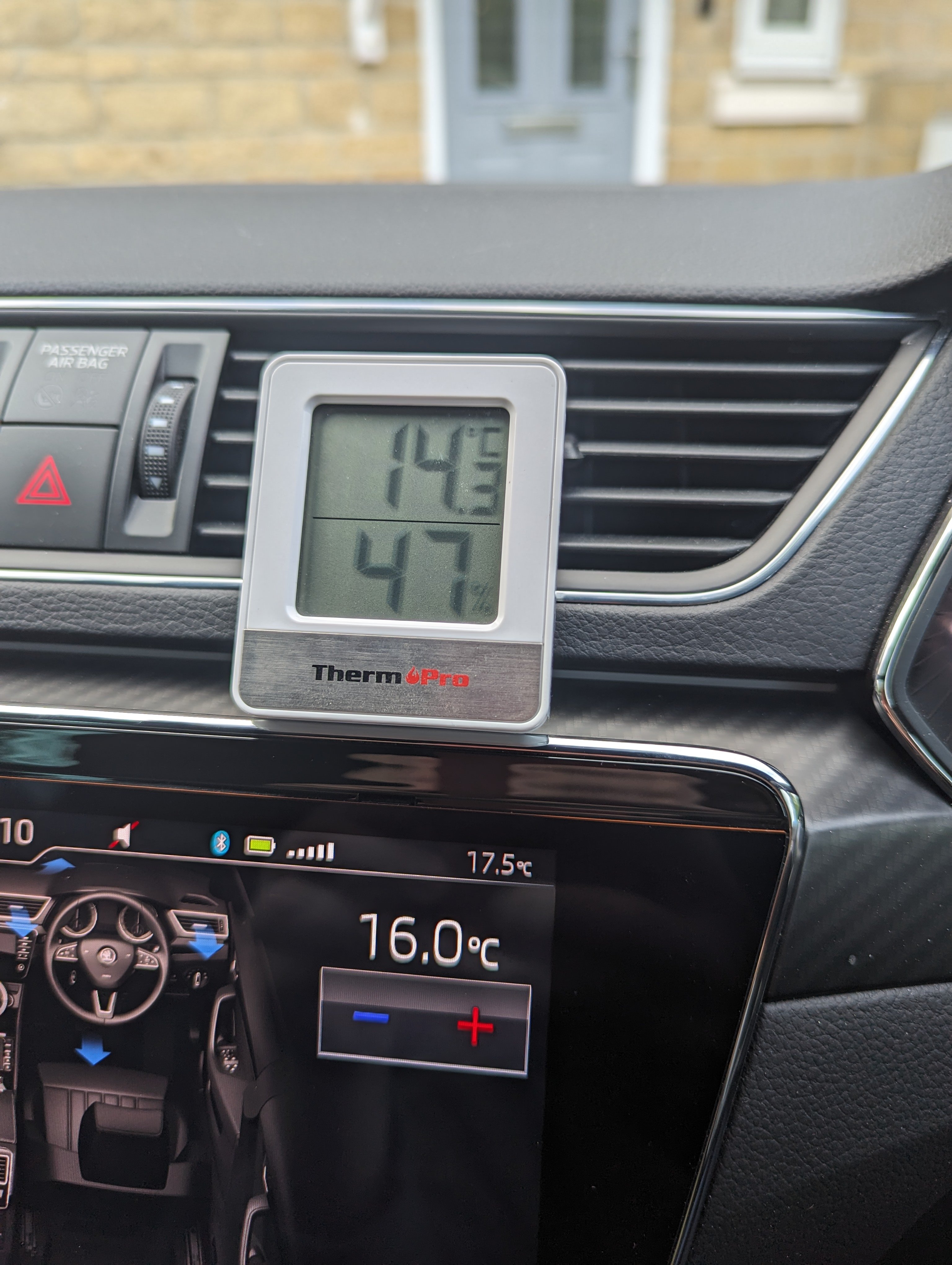

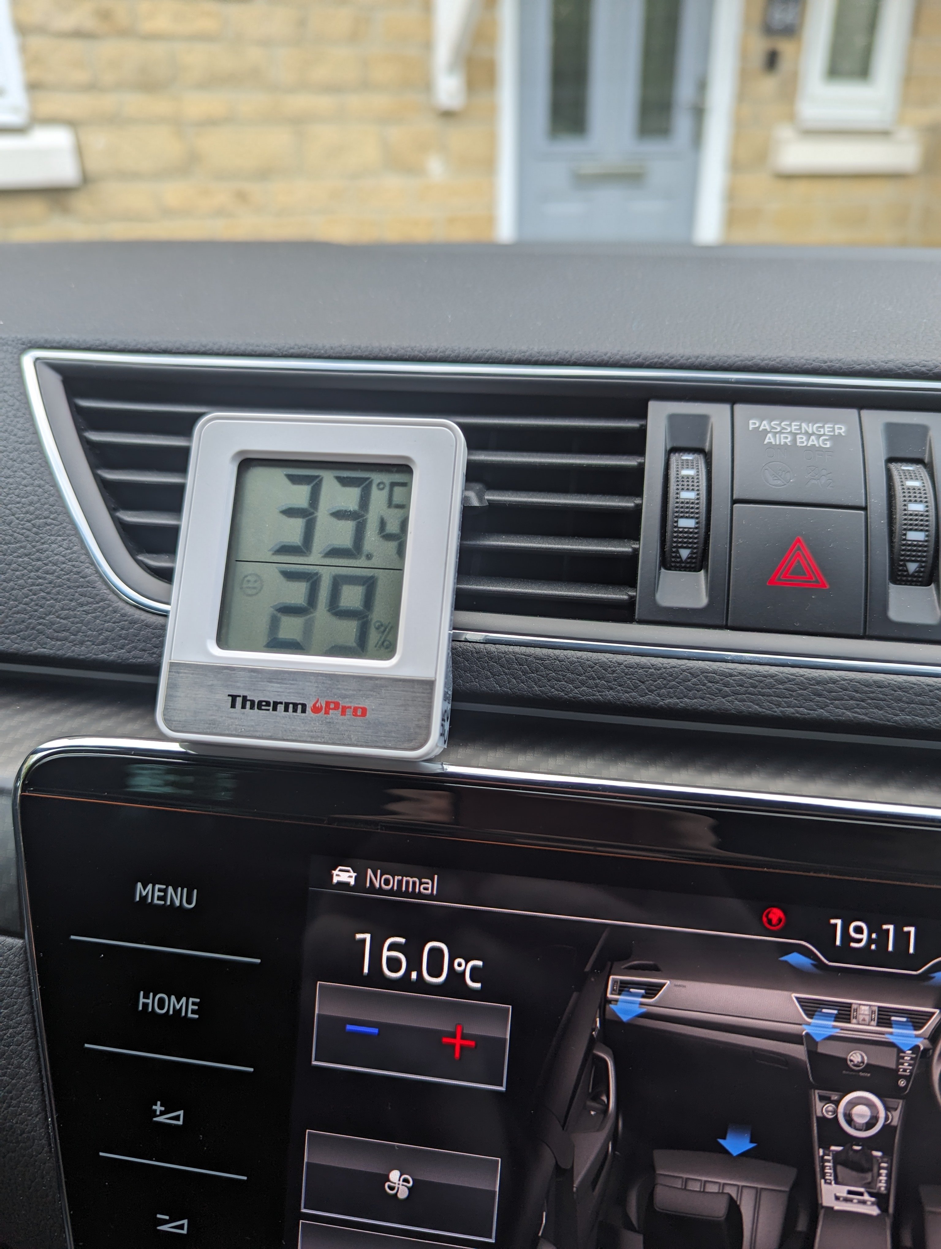

  7. Sorry to bump my own thread. I managed to steal a room thermometer to get a temperature reading. 33 degrees passenger vent with AC set to 16. 14 degrees driver vent with AC set to 16. (The humidity dropped, I took the photo very soon after turning the engine on) Ambient temperature 17.5.
  8. Morning all, Apologies for creating a post but having done some research I didn't want to hijack any of the existing ones as they are for different cars or different issues. I also wanted to ask for any advice from you knowledgeable wizards to avoid being shafted by the main stealer. I believe I have the opposite issue to this user who can't heat their drivers side. My issue: Climate blows nice cool air onto the driver, into the glove box, into the arm-rest-storage and into the rear vents. It does not blow any cool air into the passenger vents or passenger footwell. I have tried the various recalibration scenarios from the thread I've linked and the car did do some things - but did not change the output into the passenger side temperature wise. I can get all vents to blow hot. I can get all vents to blow strong or gentle. Car is a MY20 (69 reg) with dual zone climate control. I have AC activated all year round. Summary: Passenger side receives only warm/hot air while the rest of the climate system works flawlessly. Many thanks and apologies if I have missed out any obvious key information. Adam
