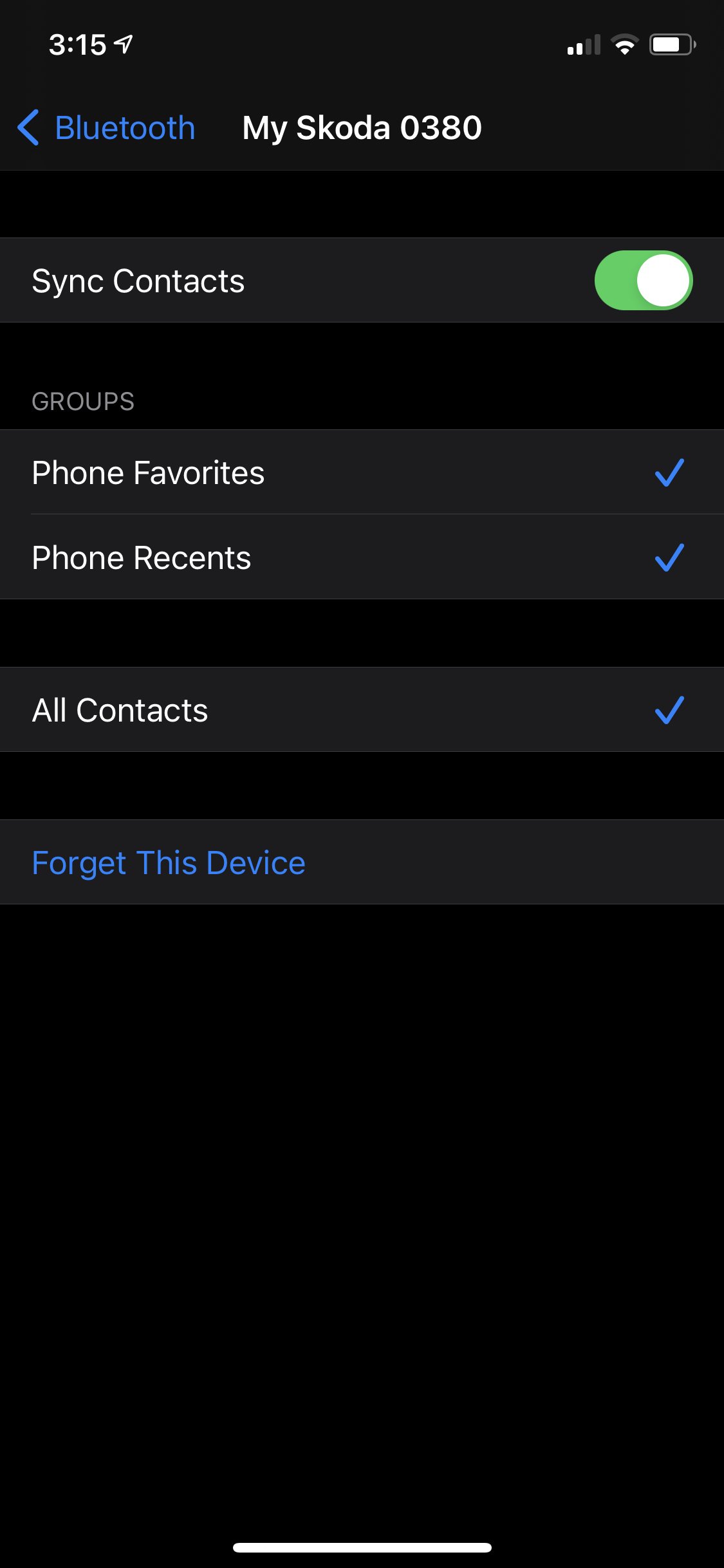

  15. Maybe you should try to delete the connection from the phone and remove the phone from head unit list and start again ? I think that during the connection process the user is asked to enable the sync contacts.
  16. Yup, option does not exist.
  17. Make sure you enable the Sync Contacts option in the Information screen of the BT device (My Skoda XXXX or similar).

  24. Did you enable export of contacts in the phone. I'm an iPhone user and could not add favourites until I enabled this option in the phone.
