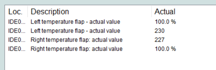

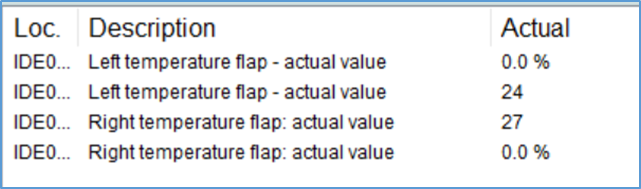

Set dial from LO all the way to 27C gave me the same actual values. It doesn’t even change throughout the change in dial temperature. When i increased the dial to 28c, the actual value starts to change When I turn all the way to HI, it peaked at these values. I was able to see increases in the actual value from a range of numbers from 40+ to 230. what else should i do using VCDS?

I scanned with vcds but there are no HVAC fault codes. What else can I do to verify the cause? Any use for measuring values in vcds?
